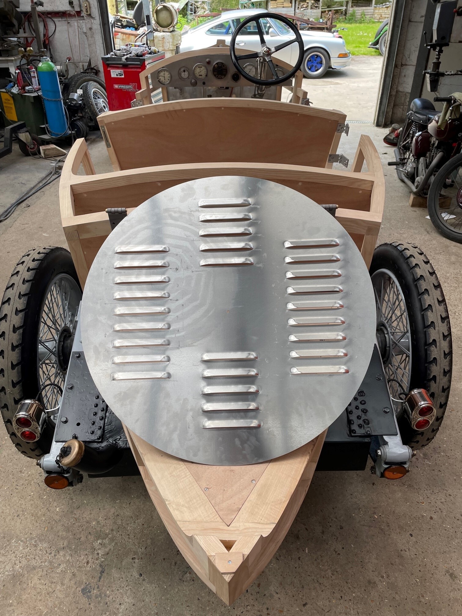

If it was me, I'd probably just have a plain disc - I can't see what purpose the louvres have in that location?

The louvres are mainly for aesthetics...
I hope they are 100% aesthetic as my 2017 Plus 4 doesn't have any!
They look good and remind me of the racing Plus 8's that had the vents in for cooling I believe.
That is an ingenious way of mounting the disc with no panel drilling or scuffing as per the standard units thumbs.
Just like your alloy cockpit cover you had made for your M3W you have shown MMC the way forward once again laugh2
Their later fibre glass one looks tacky in comparison to yours...

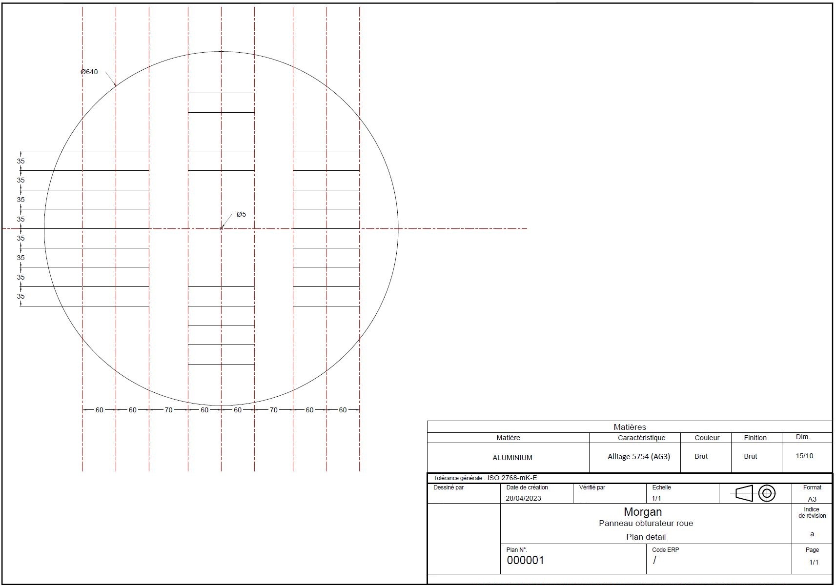

Here is the final plan :

I launched the manufacture of the panels clap
they will be 15/10 aluminum laser cut
I made 5 copies because the price is almost the same for one piece, rather than a series of 5 pieces

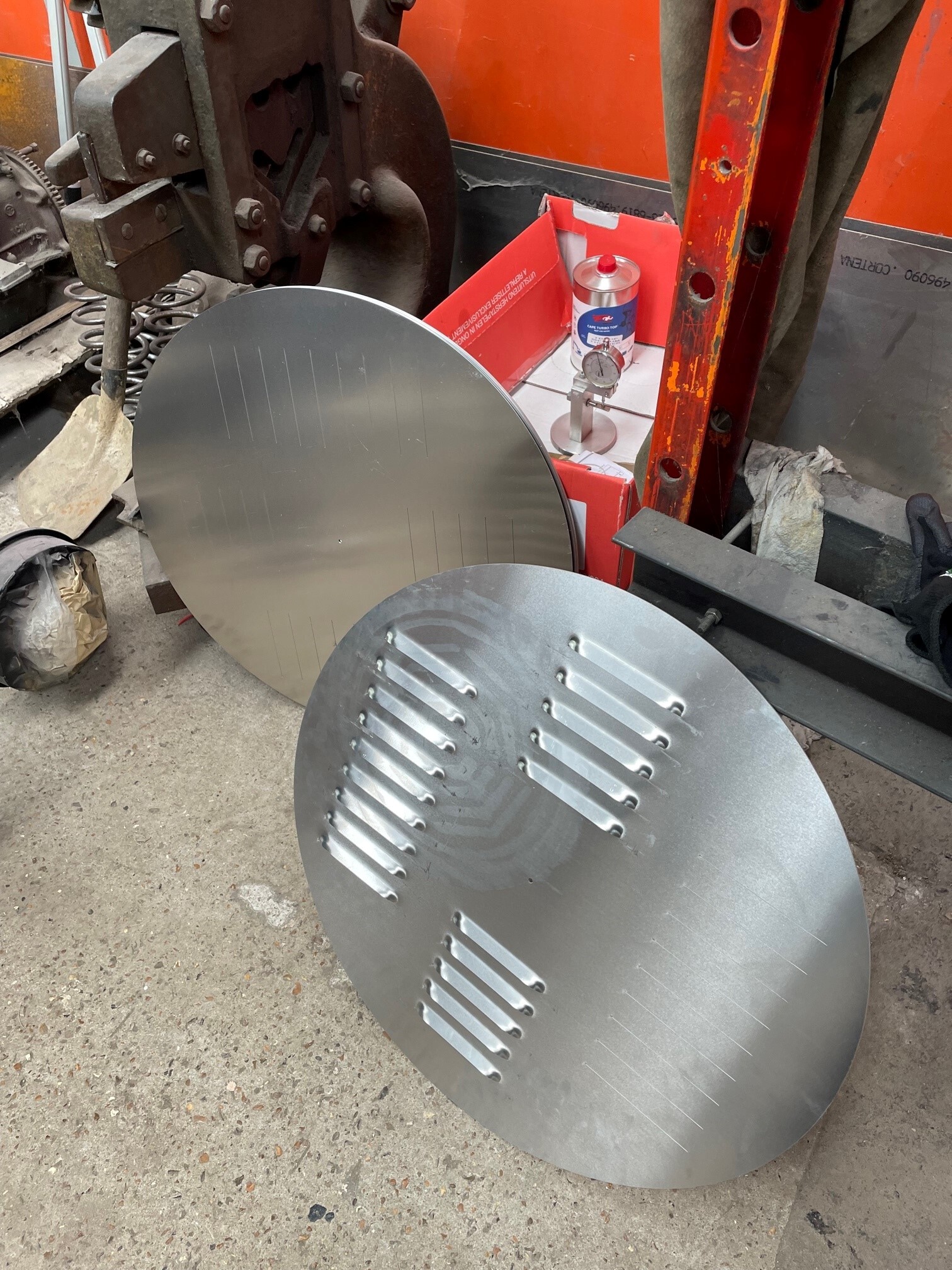

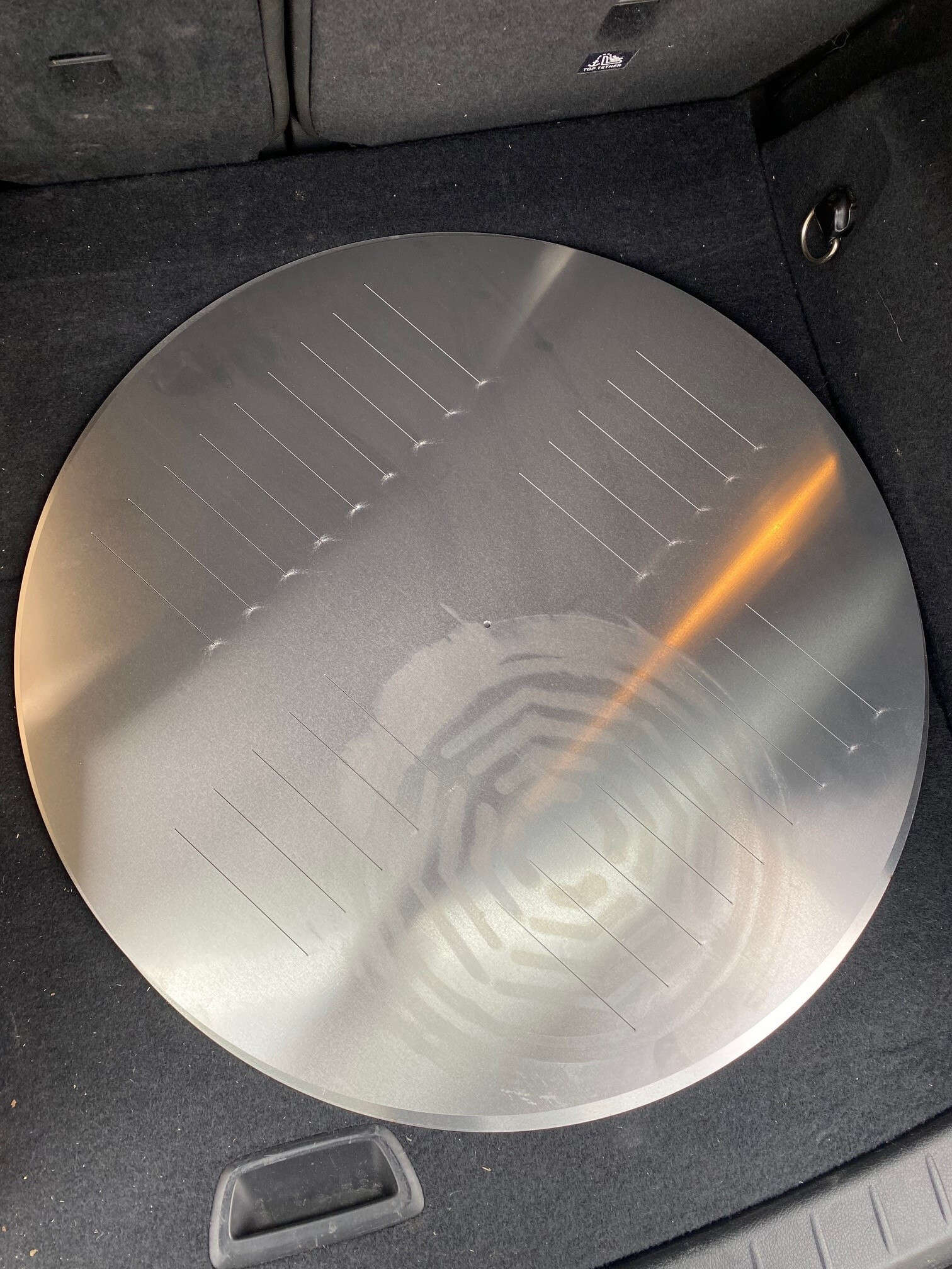

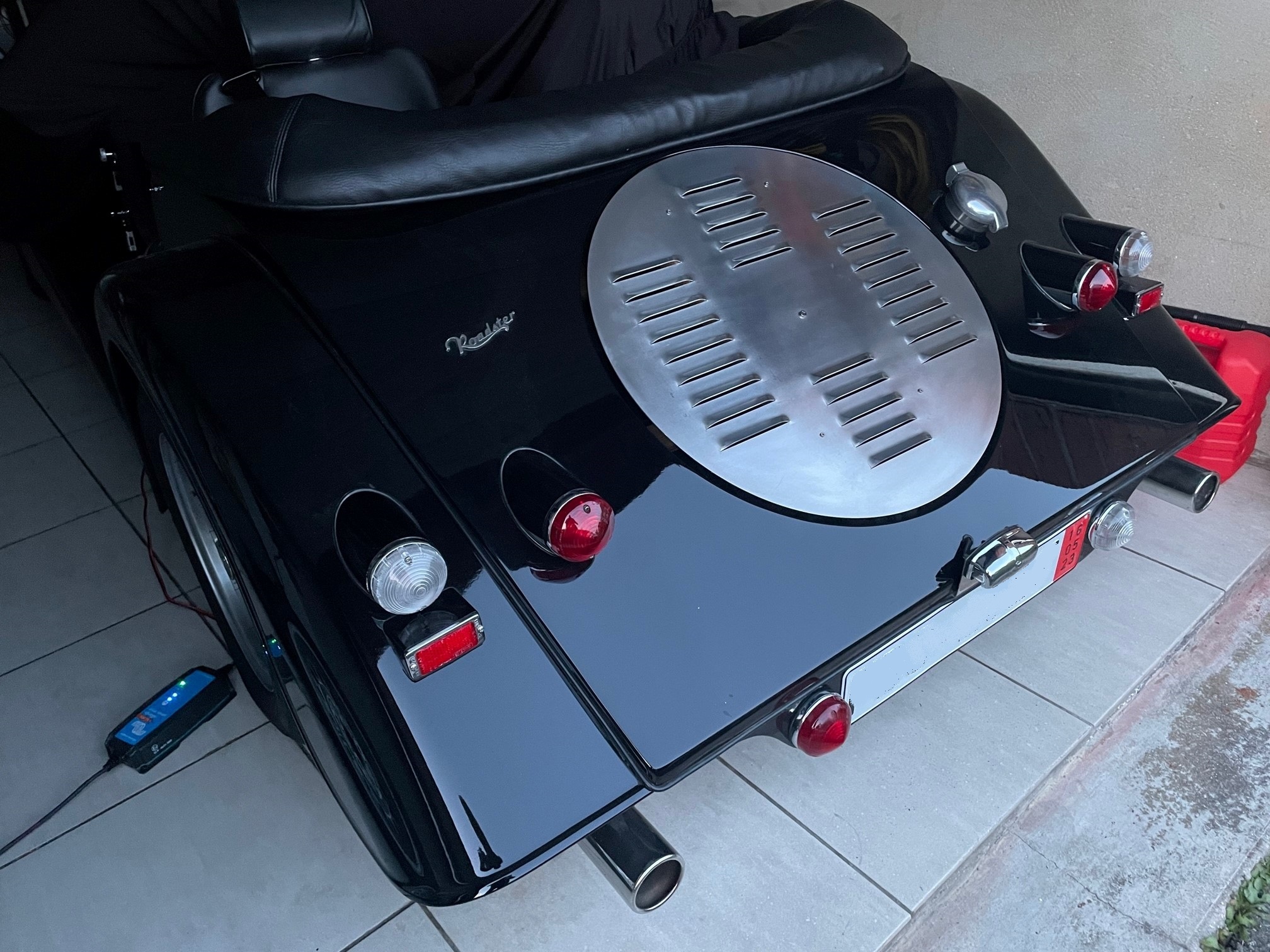

I am proud to present you my handmade aluminum rear panel (except the laser cut) :
First step: Going to the laser cutting factory
Second step: shaping the louvres at VH Classic Belgium:
The result is not bad, especially on this rare Bignan Sport being reassembled : laugh2

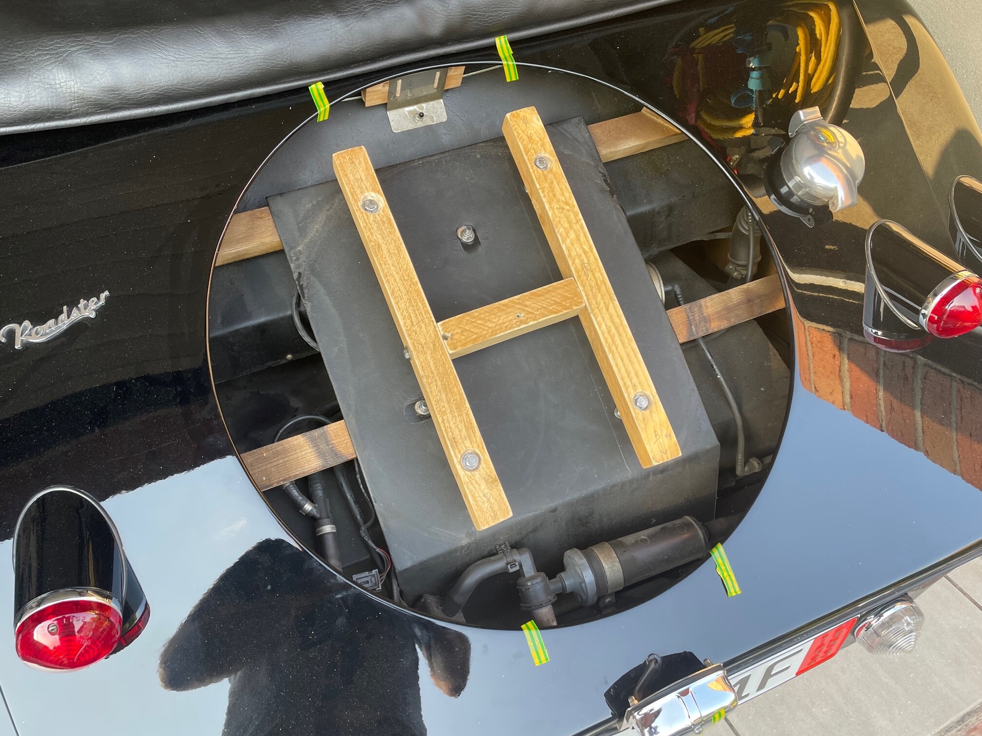

Third step: Creation of the H-shaped wooden cradle, the most difficult step because nothing is straight on a morgan: banghead
Fourth step: Central and final assembly, the disc did not touch the bodywork : sunny
