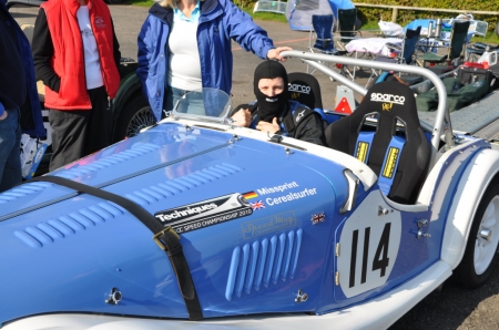

First two photos at Curborough - who is that sitting in Smithy's car - doesn't look like him!
2nd two at Gurston. Fifth also at Gurston?
Looking forwad to an interesting season!
Cheers,
Cheers,
The first pic is probably the taster day so not sure.
Last pic is Castle Combe
