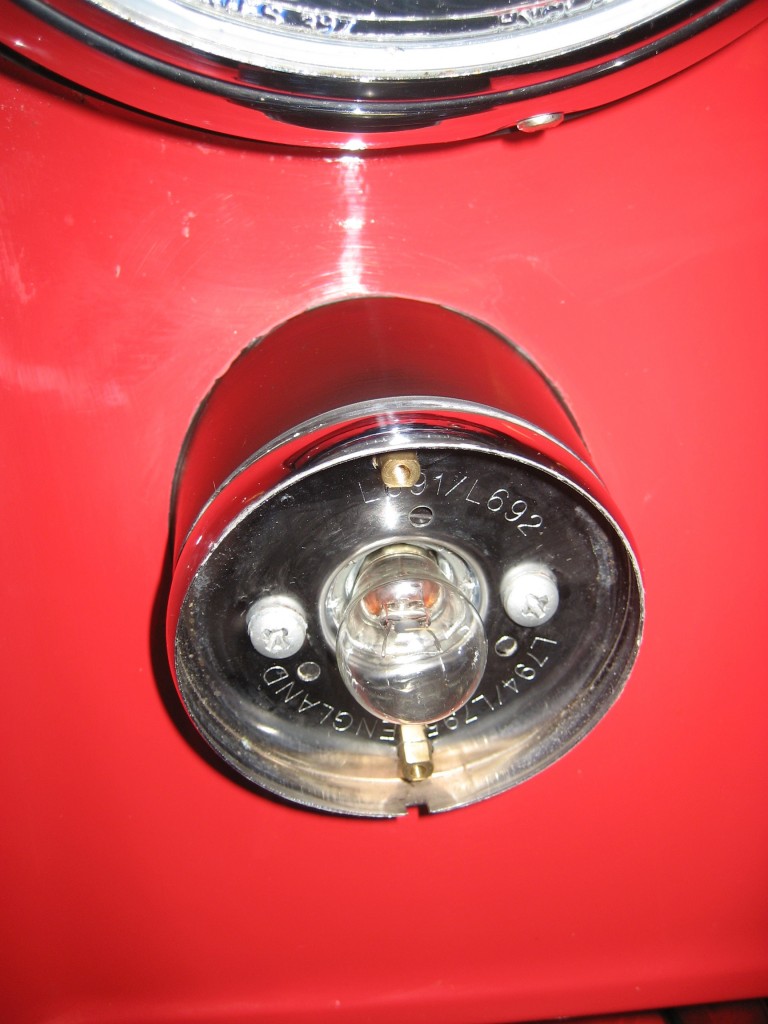

Without gasket. The little slot at the base aligns the plastic cover. No sign of wet in these.

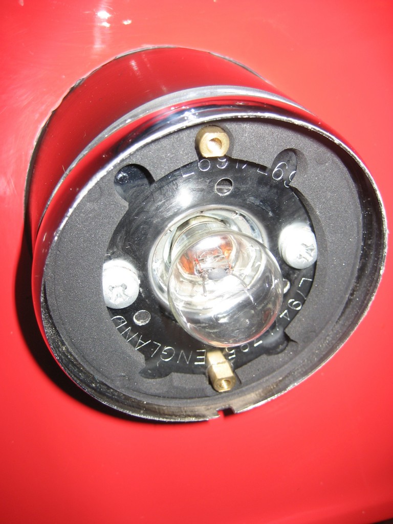

With gasket.

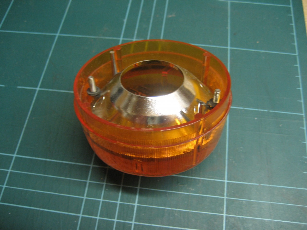

Internal reflector.

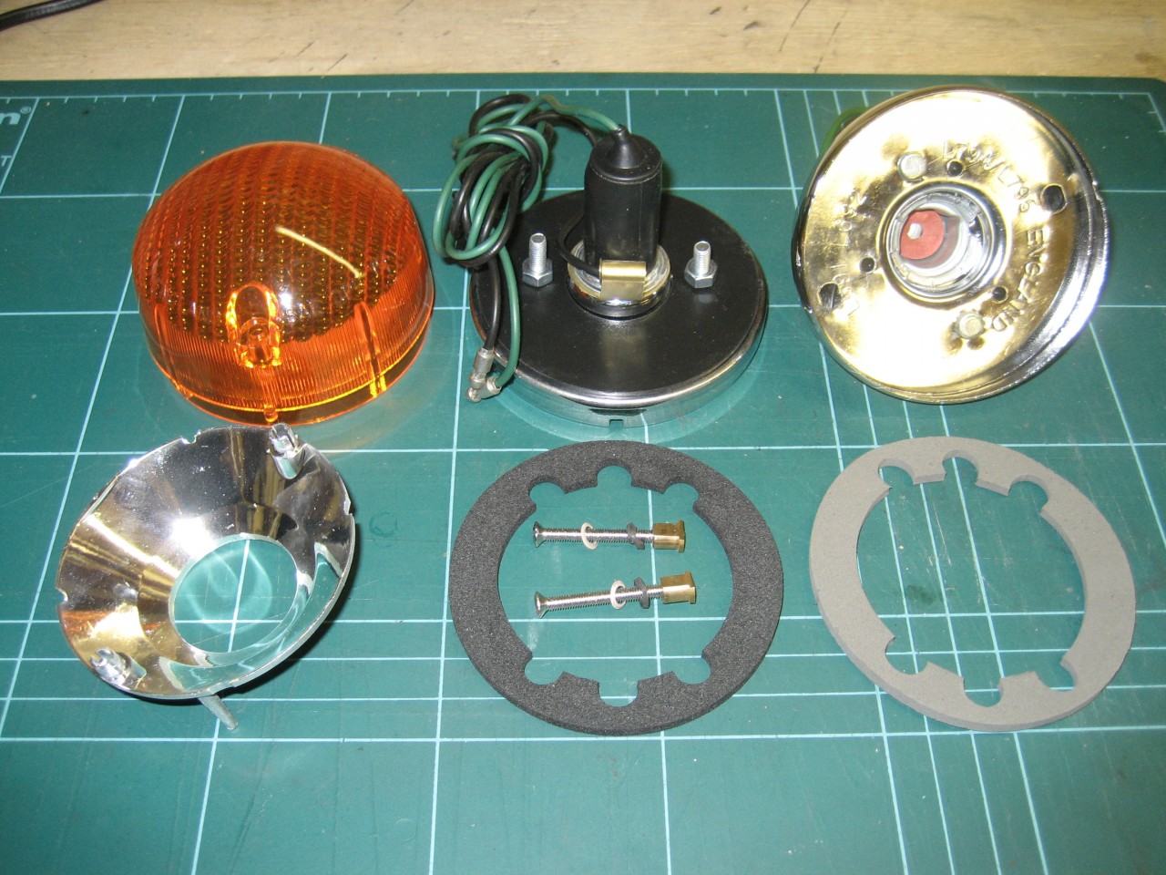

All the components. Note that the lamp unit has a neoprene backing seal.
With gasket.
Internal reflector.
There are two types of thread, so don't assume interchangeability of fasteners. The brass top hats come out from behind the lamp unit.
