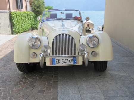

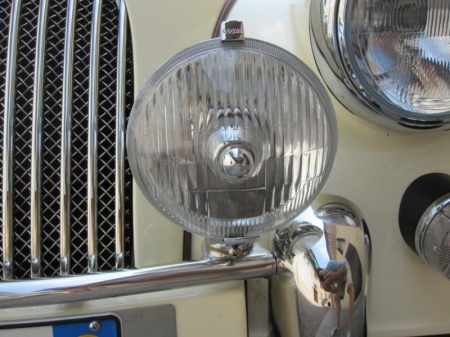

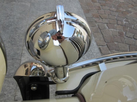

These photos show some detail of how the Borghi driving/fog lights are mounted on the badge bar. The bar is anchored to the overiders and the cabling is hidden behind the overiders.

Best to write to Luigi Borghi luigi@borghiautomobili.it. The price was 786.50 plus fitting.
You can have lights with plain lens or patterned lenses (as in the photo - like the headlights)or even one of each. The price is the same.
I am sure he would sell them as a kit. You would need to drill a hole in the side of each overider. It makes the whole system very stable and solid. There are no holes to drill in the bodywork.
