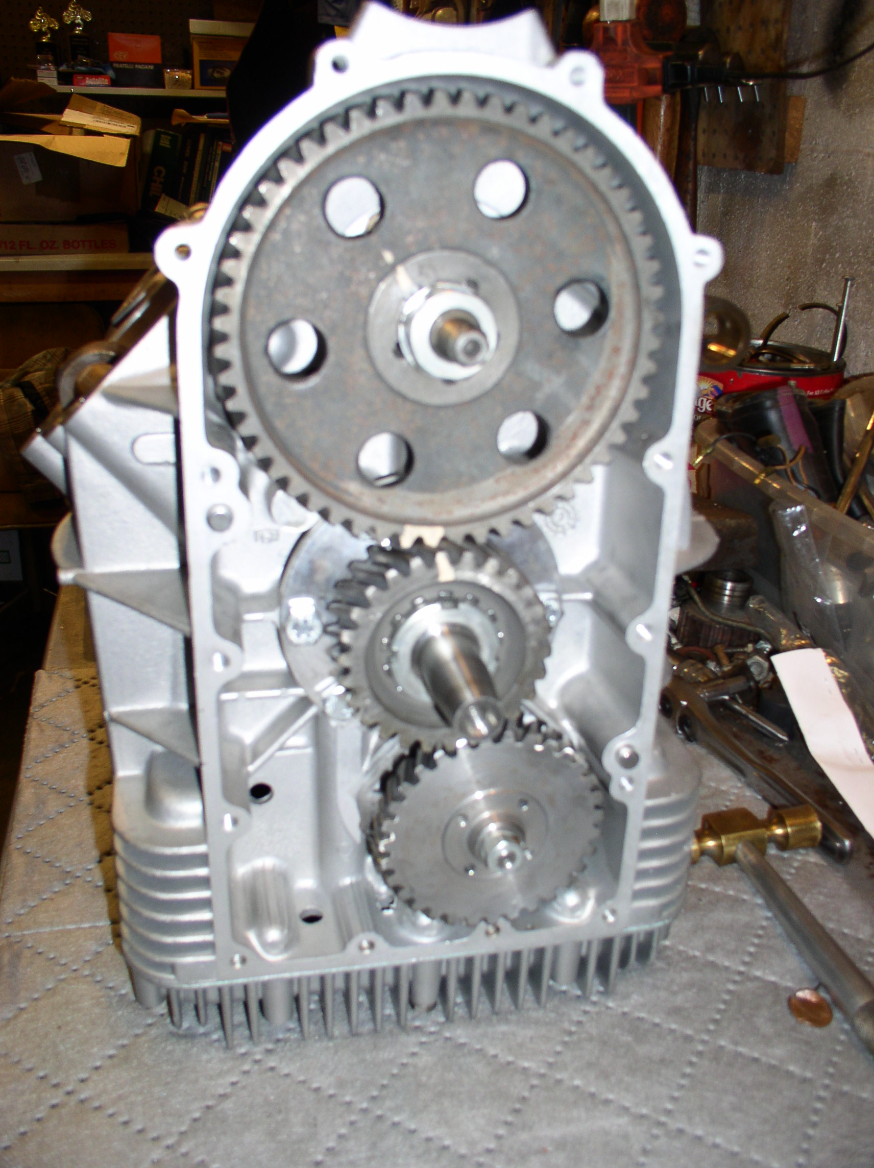

Maybe you should include Moto Guzzi as well although I'm sure I could find others. I appreciate the axial load issue but in a former life I sold many helical gear conversion kits based on that of the OE V7 Sport model (see below), to owners of later models that were fitted with a timing chain. It was assumed this was on the grounds of cost saving. We never had any load issues, indeed I road nearly 100,000 miles on one bike fitted with these gears and without issue, although the original design was to accommodate such.
The lower gear drives the oil pump.
