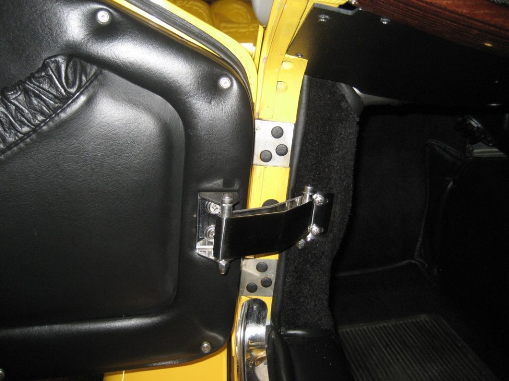

Librands door checks:

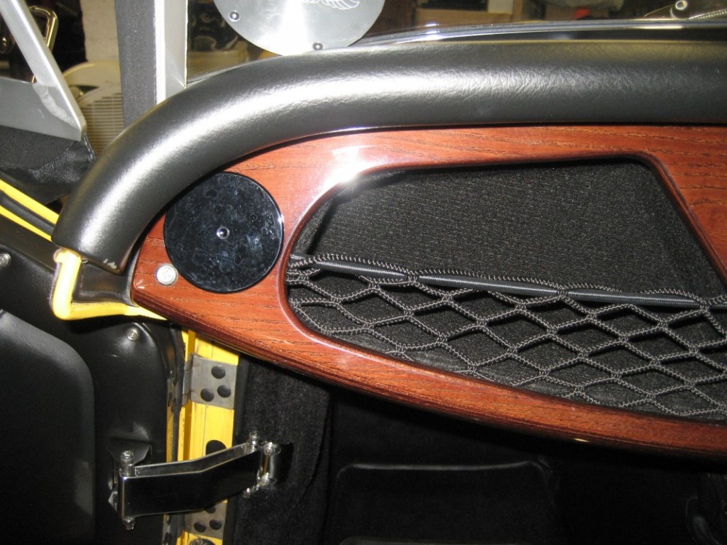

Garmin black plastic disc:
With leather cover:
With Satnav:

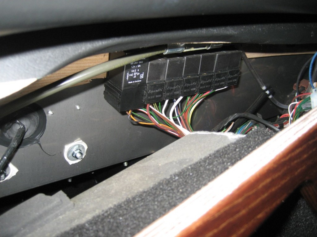

And finally a look behind the dash to locate the relays. On this model year there is a bank of seven, just to the left of the centreline. A big one which I presume to be the wiper delay relay and six identical relays:
The reason I checked this out is because on Saturday when out and about, I had an engine cough - a momentary ingnition off/on moment. The immobiliser lamp flashed momentarily, before all returned to normal, but I'm thinking ignition relay, unless anyone out there knows something for sure. Alternatively it could be an immobiliser fault. We'll have to see how it develops.
PS - the relays are Tyco Electrics 0-1432793-1
They also have the reference no 111921, and have the supplementary terminal 87A (for those familiar with relay terminals).
