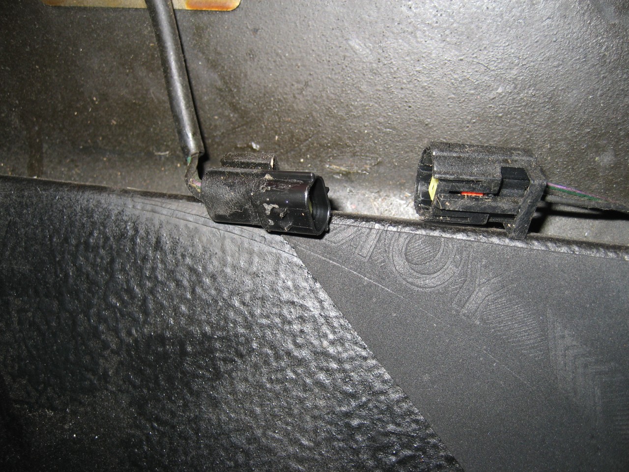

My plan was to unplug the light and leave the car loom unaltered. This is the plug, just under the stalk. It has a simple securing clip and comes apart easily.

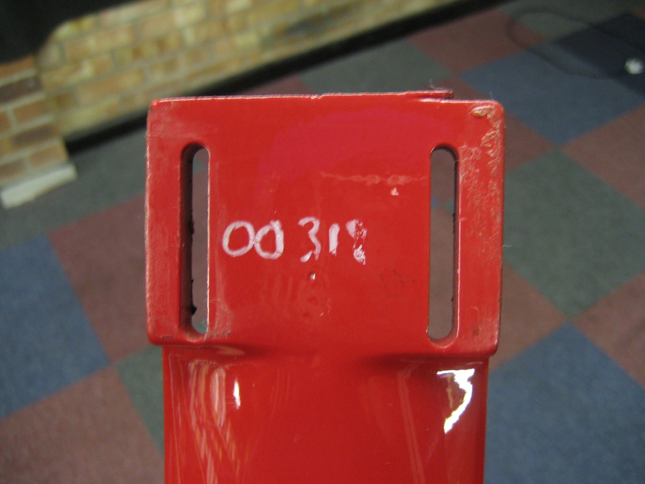

Once off, I found the chassis number 'chalked' on the base. More like Tippex really. Note the rough top edge, and I had assumed that this stalk was plastic. It's metal.

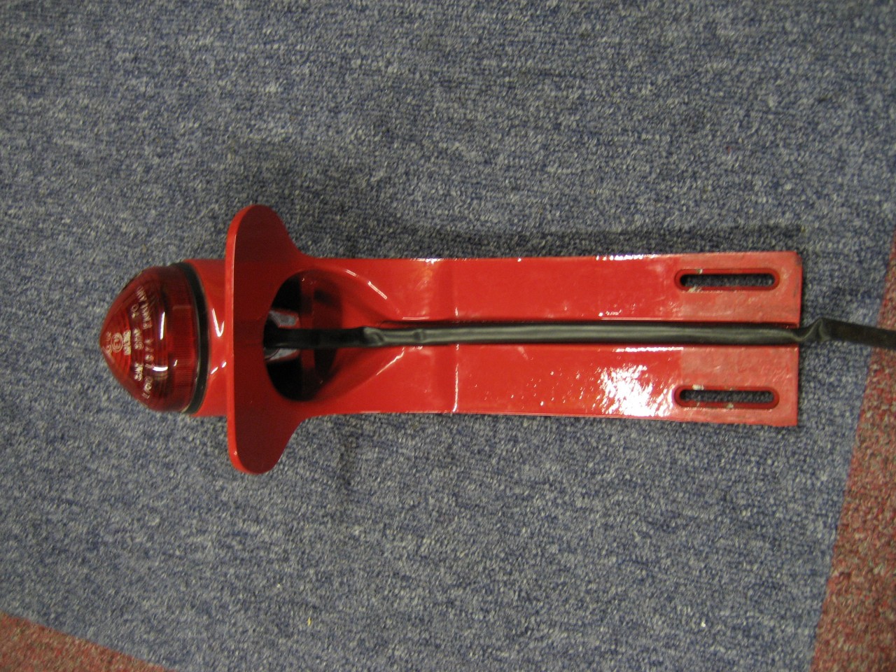

This photo shows how the cables run down in a slot, and should be compared with the next picture - after fettling.

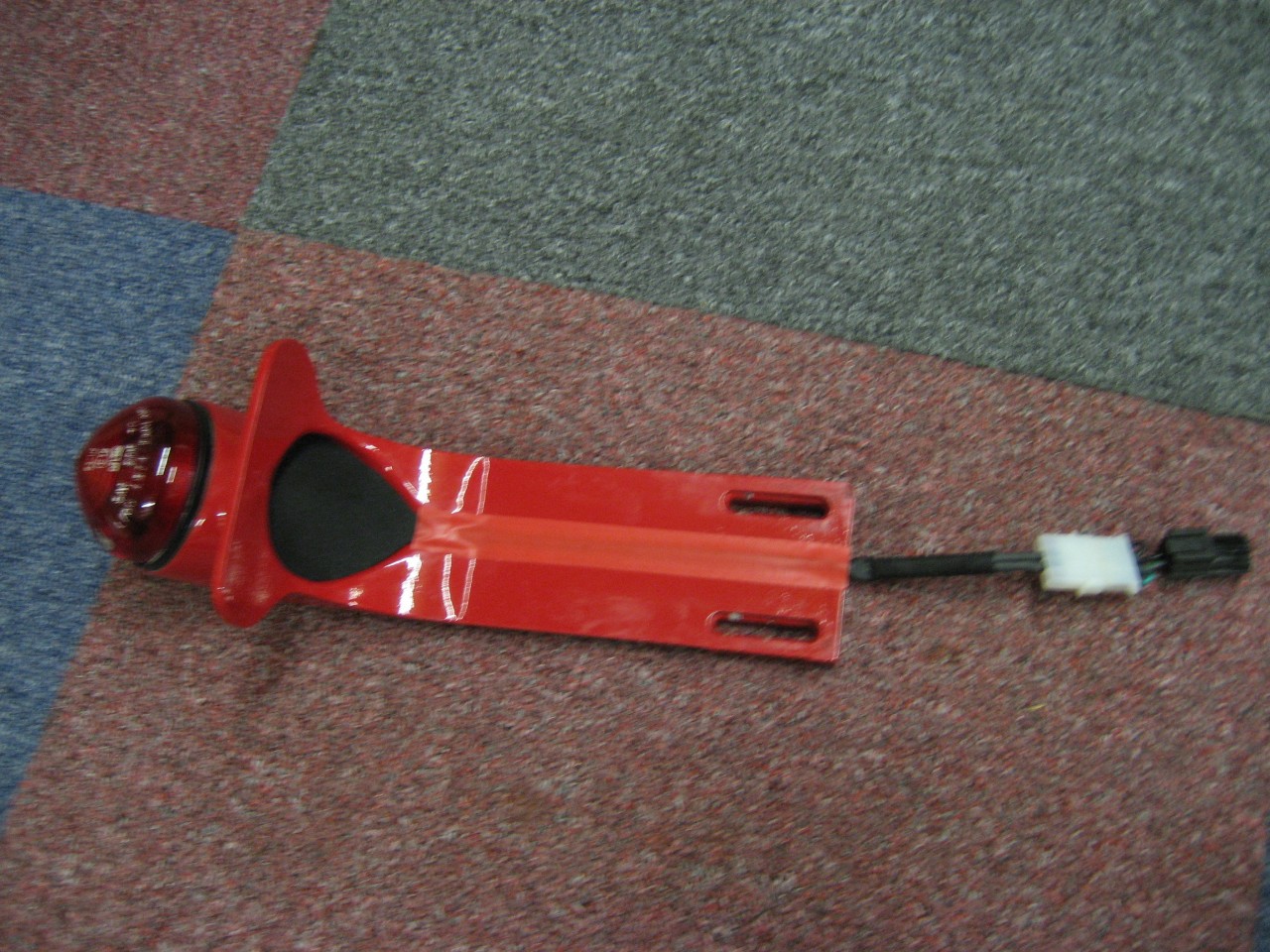

So now we see a black neoprene plug under the lamp, to keep damp at bay, and red insulating tape stuck over the wires, just to make it tidier. You can also see the white plug which I've put in to allow a second set of wires to run to the luggage high level lamp. All connections have been soldered. It's a while since I had the soldering iron out, so I quite enjoyed that. It's very relaxing.
