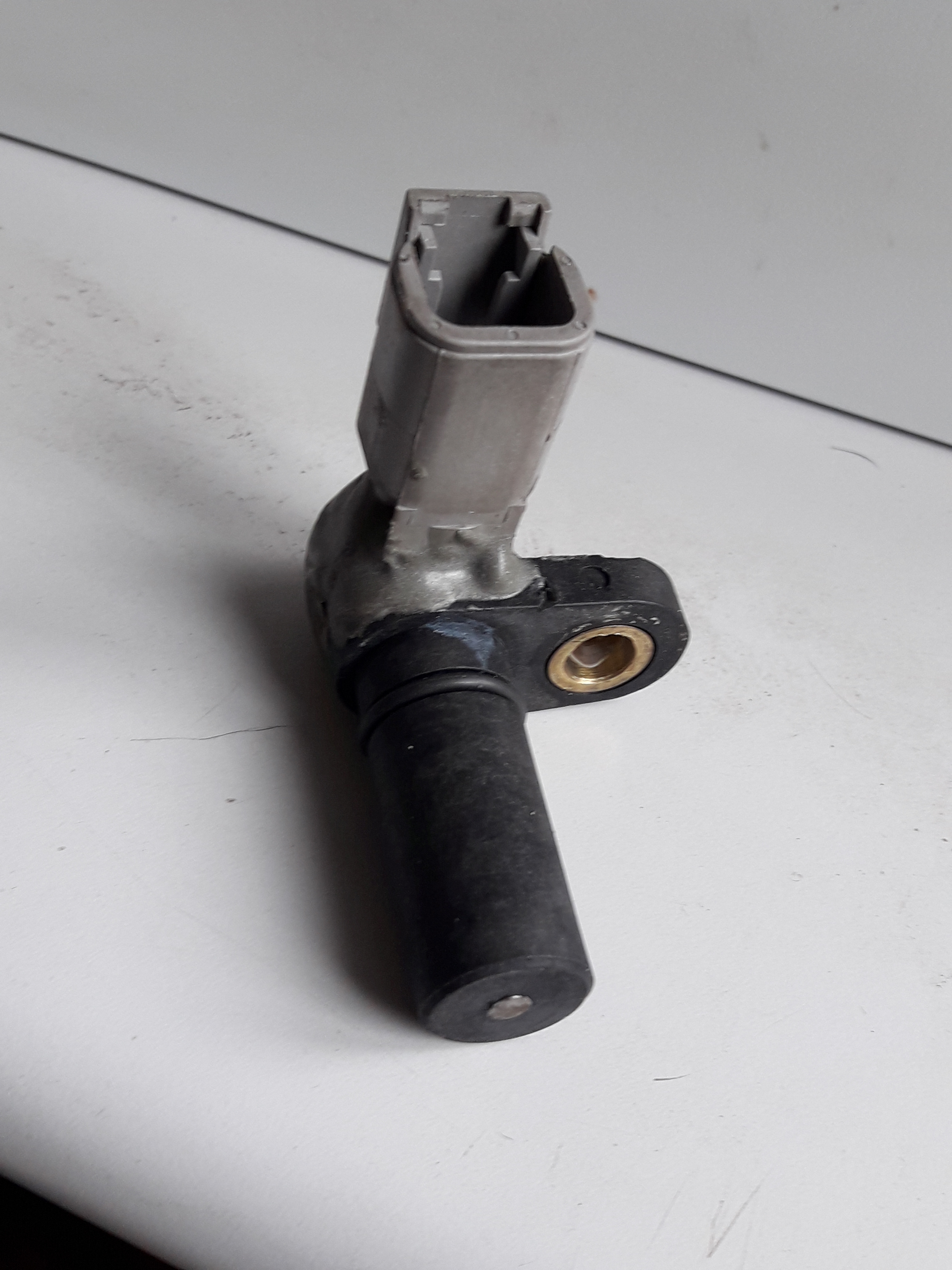

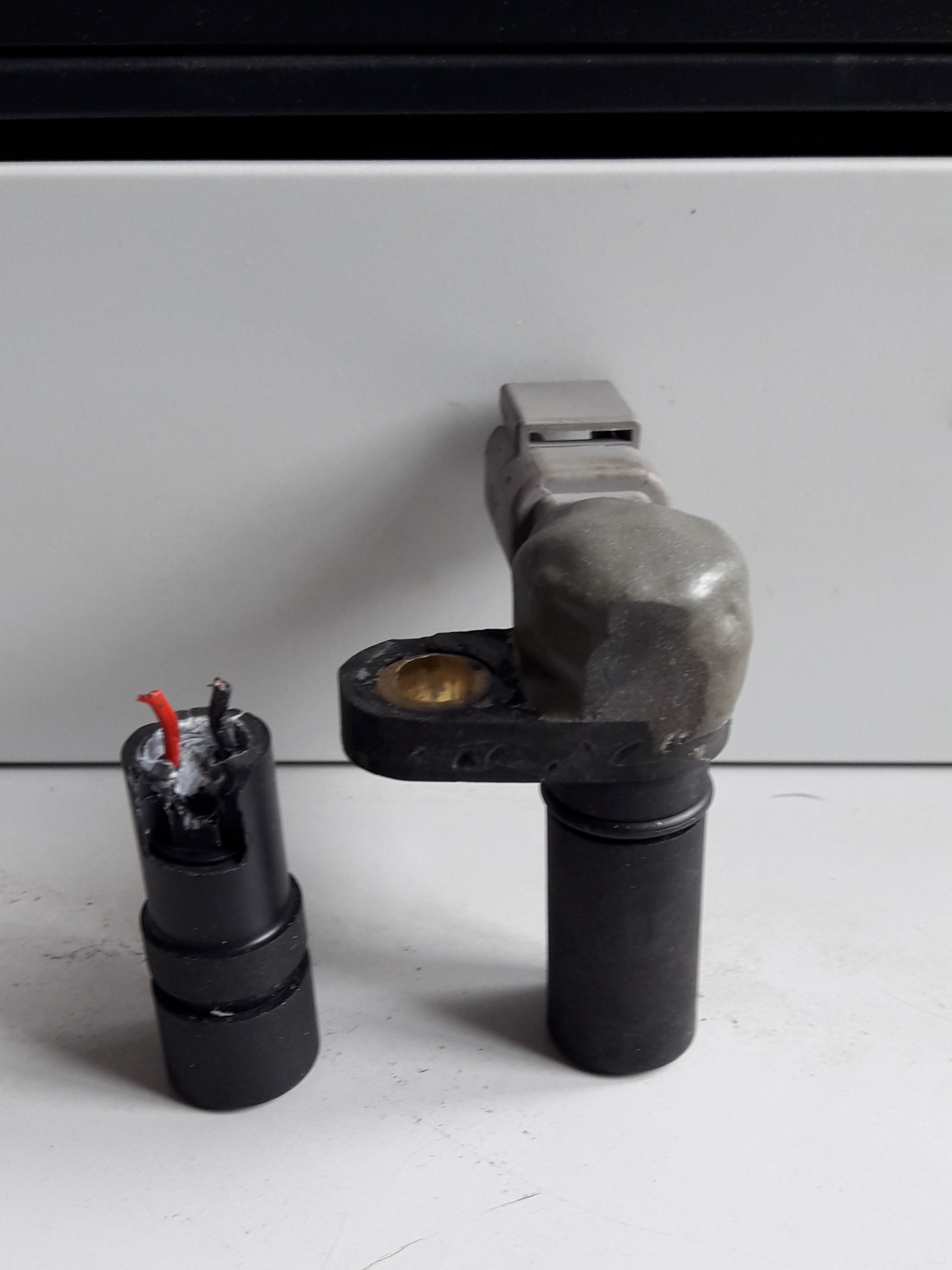

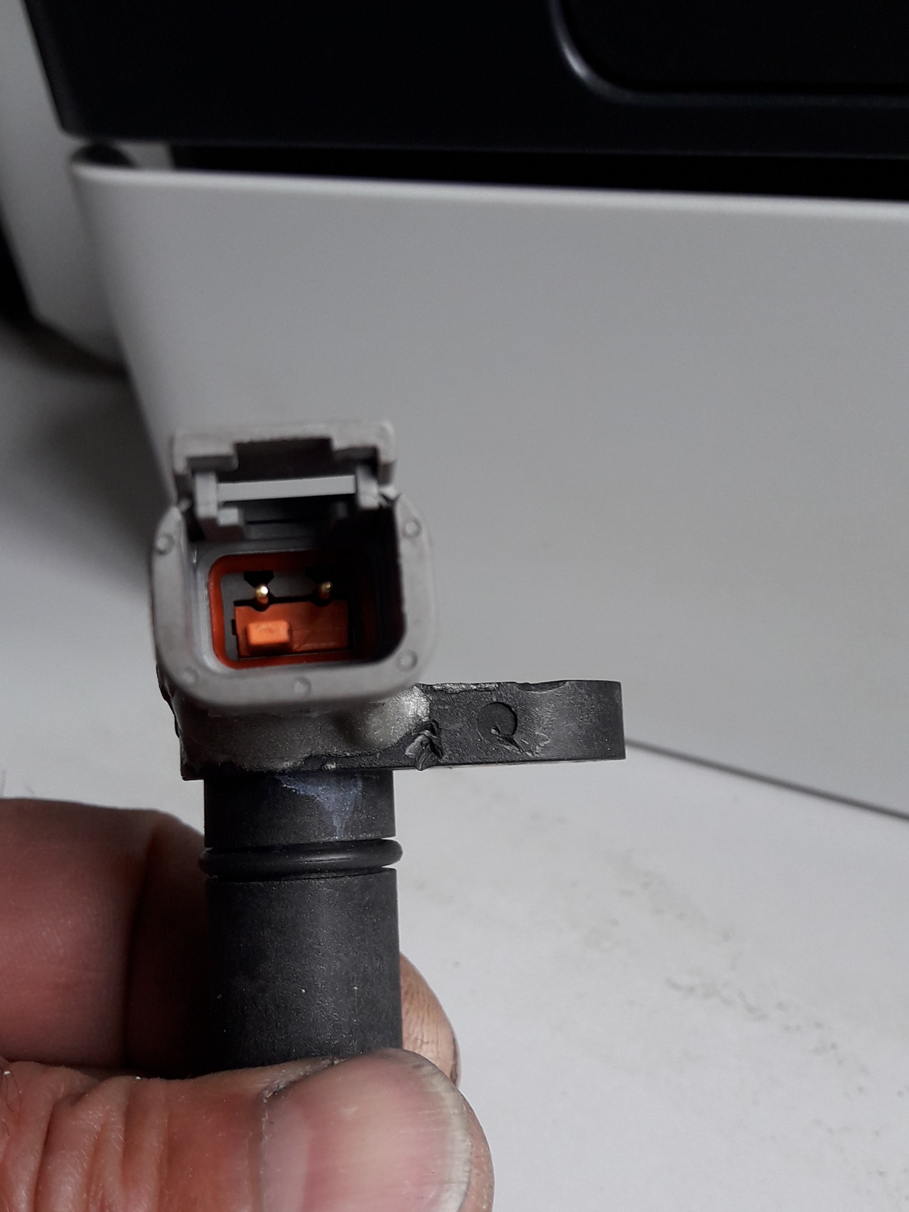

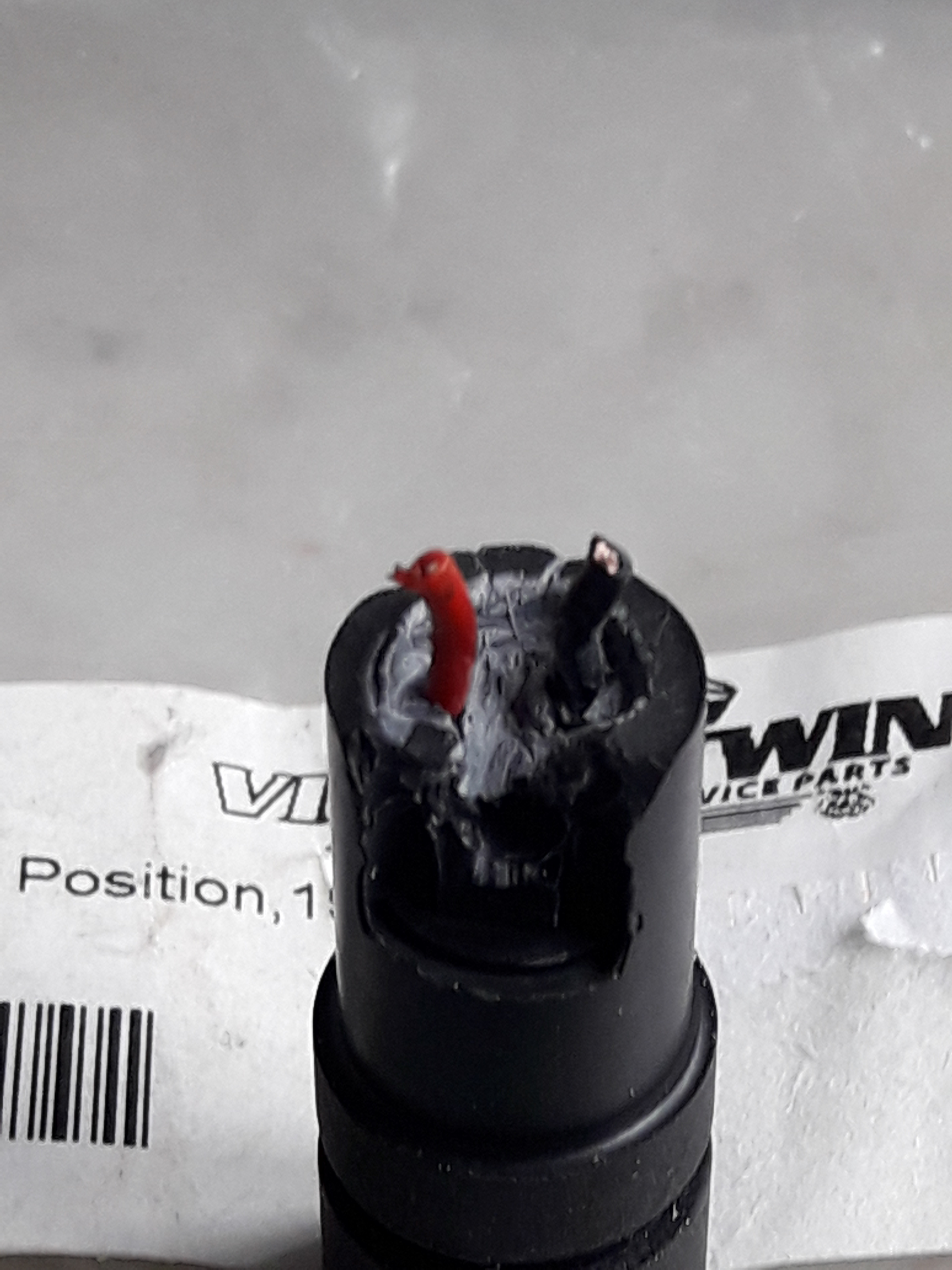

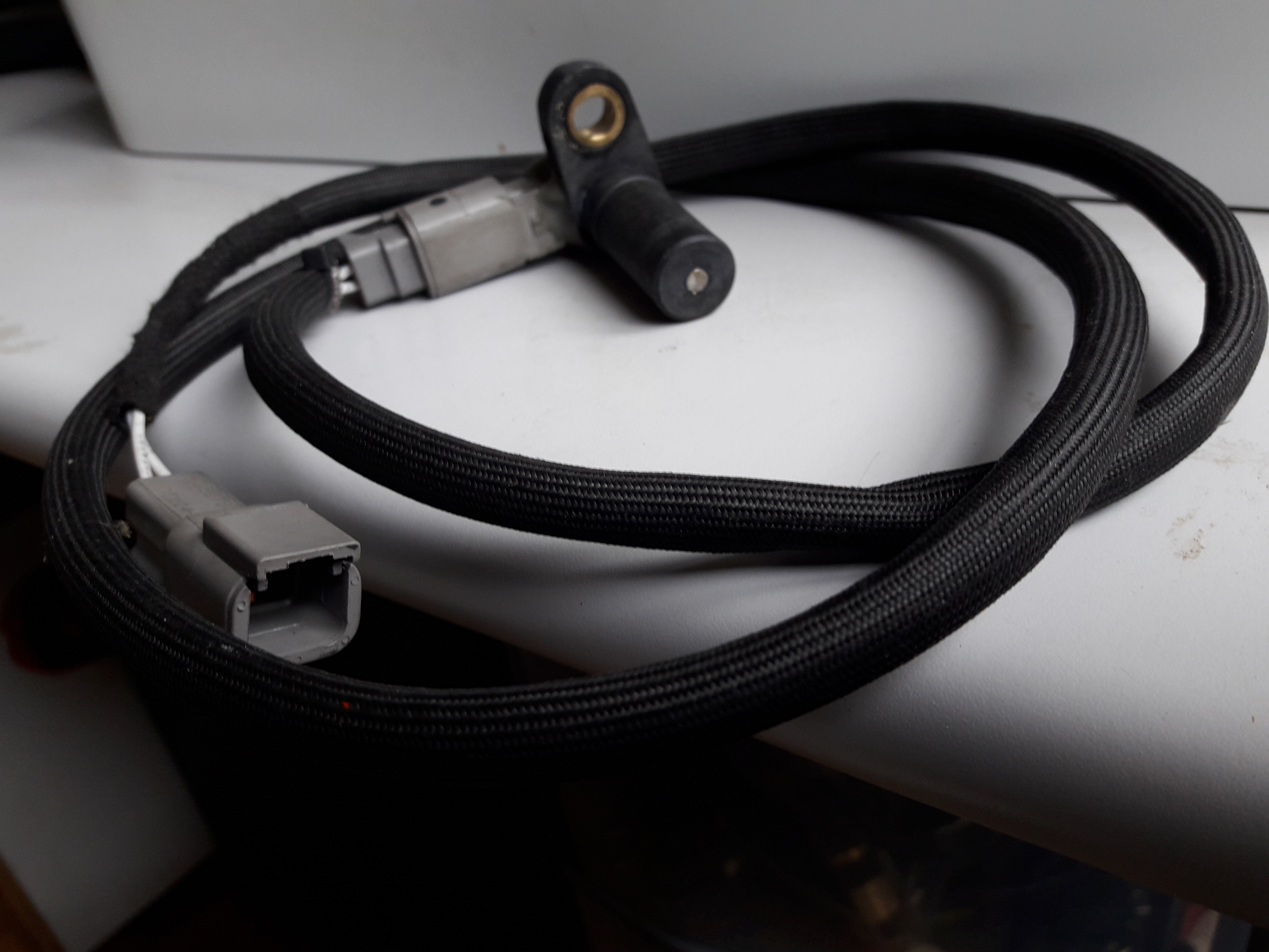

The impedance of the sensor is 1030 ohms, I have just dissected a bad model S&S sensor to try to transform it xwedge, my backup sensor is an xwedge sensor which had the cable cut which I repaired by attaching a Deutch directly to it with gold plated connector and made an extension cable always with gold lugs and has been tested for a few hundred kilometers without problems
I am going to lengthen the new modified sensor with a tube that has a mounting bracket for the screw.
