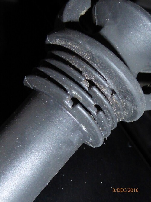

Rog, the thing with the Duratec plug leads is that the sealing rings have vent notches in them so they are bound to let water down to the plug chamber. Well my 07 Duratec was like that.
From my Duratec.
