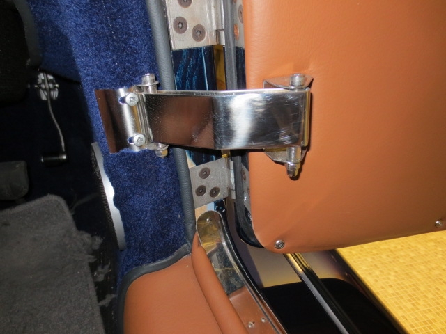

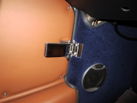

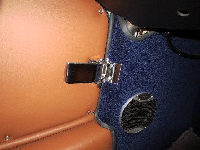

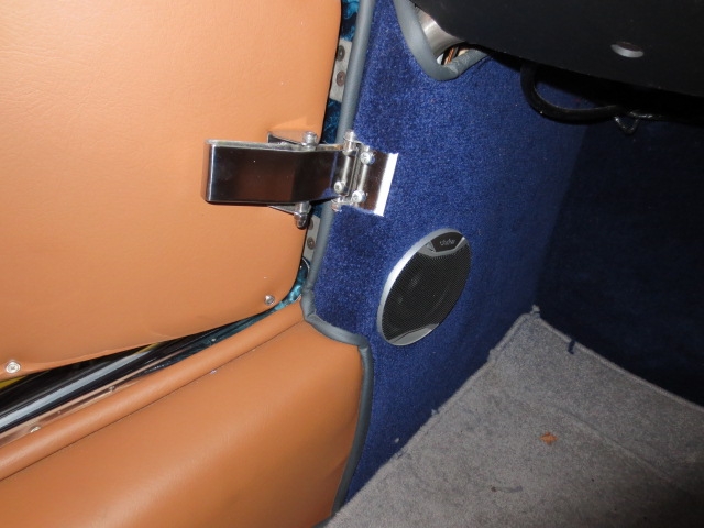

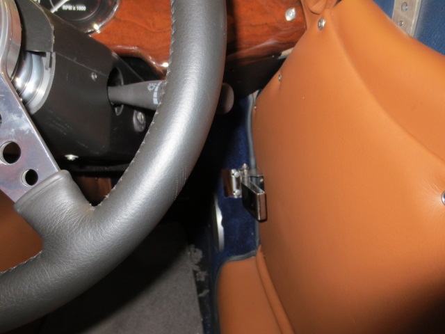

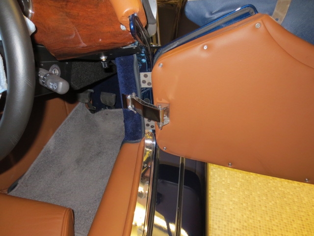

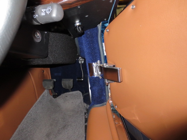

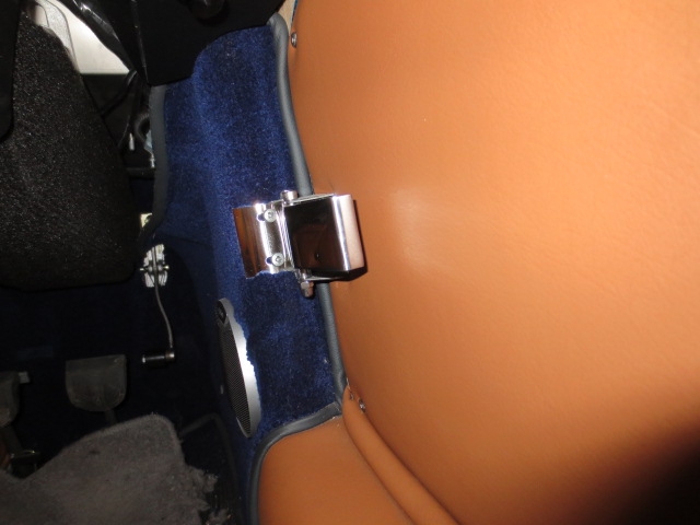

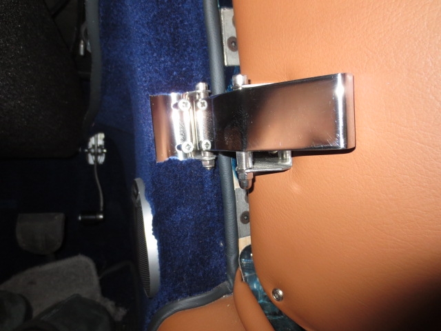

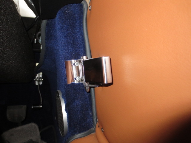

Here are some snaps of the fitted Librands door checks, as fitted to my 2011 Plus 4.
I find them very useful in keep the door open especially on an incline or when it is windy.

I have just fitted some to my 4/4. Yes, they work well but only when the door is open its widest. If you have restricted space as in my garage, or a close parked car in a car part the do not hold the door open.

I fitted them to my Plus 8 about 4 years ago, never regretted it and find them very useful, have saved my shins a lot of damage!

Fitted them to my 2001 4/4 4 seater a month ago. I had to get a pair of Mole Grips on the one unit (with thin ply to protect the S/S) as the four indentations in the slide were not gripping the plastic tubing enough! I'm wondering after a few years will the tubing hold up, as it will become brittle? However not difficult to replace
