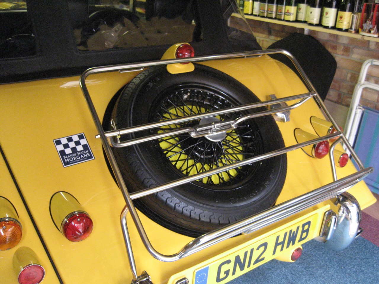

Acrylic (Perspex) sheet - 5mm thickness available in "Ivory".
Specify one hole and put dimensions in the narrative.
For the Roadster it was 360mm with a 160mm hole, but double check. Get it right and it fits perfectly, holding in place with two small neoprene pads. It arrives with protective film on both sides, so you can chose to keep one side protected, although I strip both sides. A fantastic piece of plastic. Laser cut, with polished edges, and as clean as a whistle.

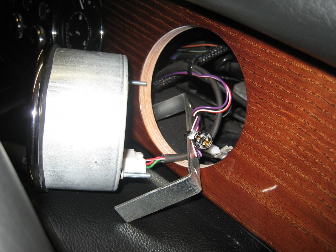

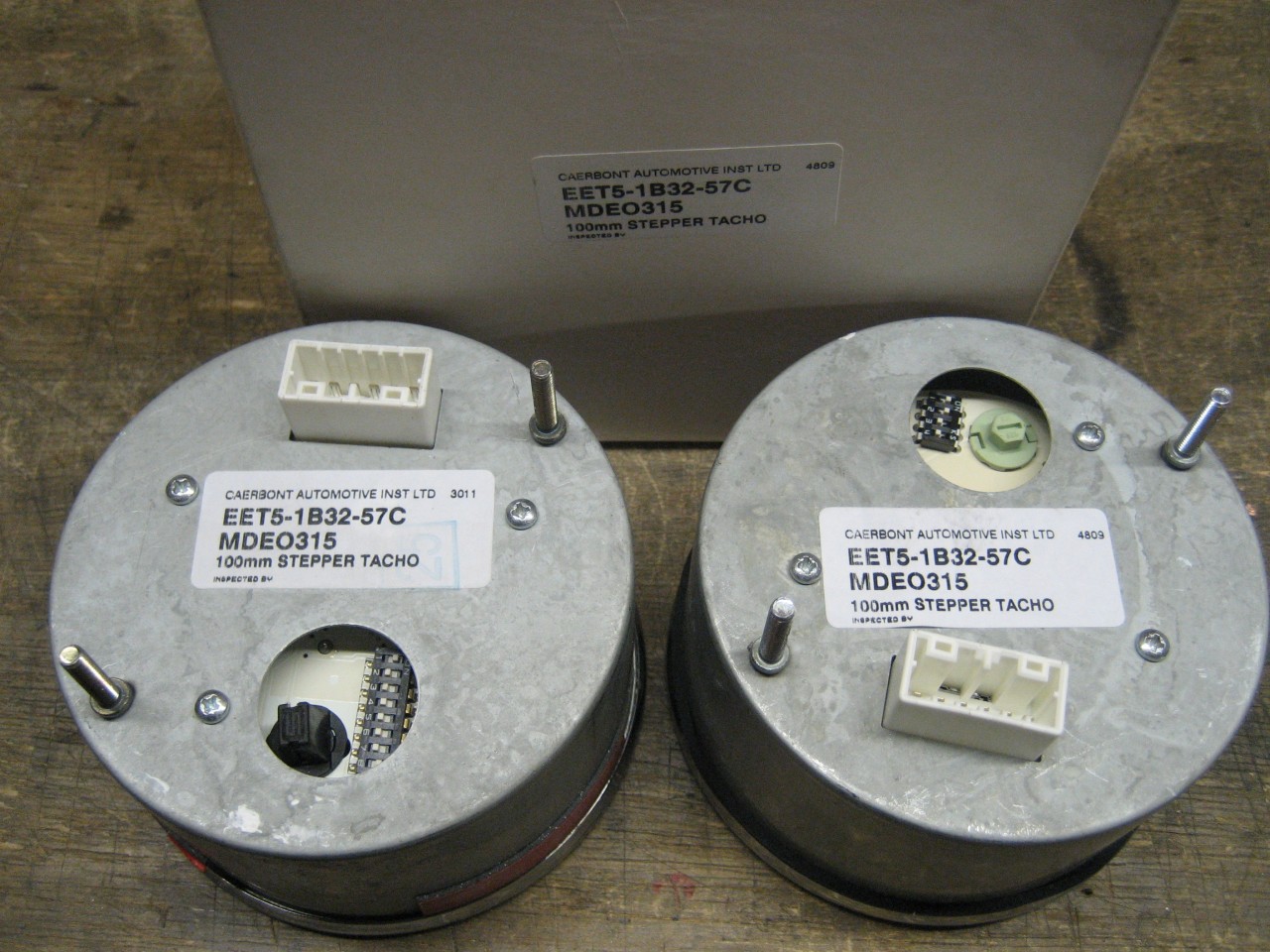

My first job was to replace the revcounter. The planned switch didn't work at Shelsley so it's been done remotely.
The following photo shows the instrument, which is designed to fit 'many' cars, and is tuned by selecting the appropriate micro switches. You'll see that the original has 8 switches but the replacement only has four, thus ruling out a like for like swop. Anyway it's fitted and so far is working fine. There is one other thing to note, the instrument is held bu a U shaped metal bracket and two knurled and threaded nuts. The bracket is slightly oversize and works far better with a half inch or less hacksawed off each end. Original to the left:

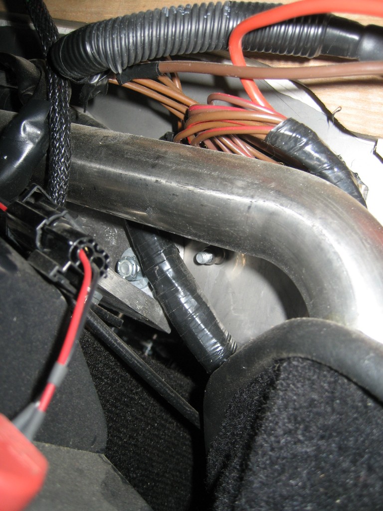

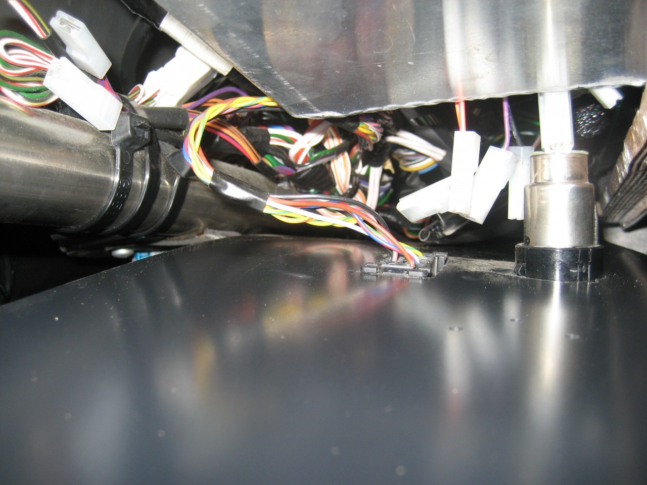

To gain access, drop the steering column to its low point, remove three crosshead screws between the column and the A post and you can slide your hand up and under.

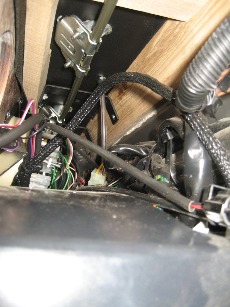

There are 'several' spare wires and plugs cable tied to the securing bracket.
This is the view under the dash in that corner looking straight up. The red & black wires are to the panel rheostat. The roll hoop is very evident. Lots of electricity in this corner. You can see the feeds to the main fuse box on the bulkhead.
Looking along the dash towards the nearside. The other instruments are visible, as is the wiper rack housing at the top. Surprisingly dusty but I suspect that some of this will be MMC dust.
This is looking up and right towards the A post. There is a main 12v feed post junction (same on my Roadster) and a seperate junction box which can be fixed to a panel, but not in this application. The main fuse box is just the other side of here, on the bulkhead under the bonnet.

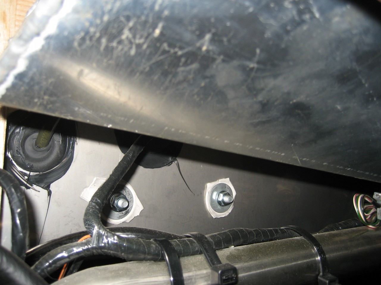

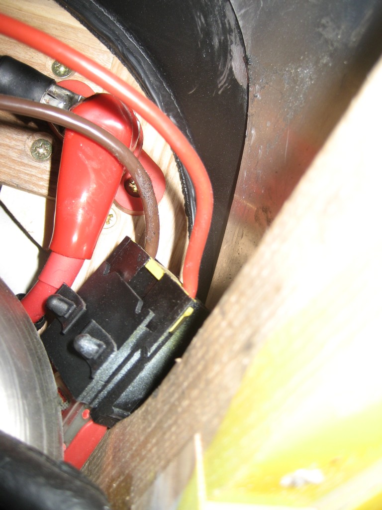

Under the passenger side, and what surprised me was that the glove box has a metal base - might even be stainless steel.

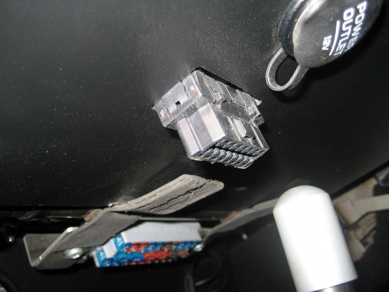

This is looking towards the offside, and there are plenty of spare connectors. Also visible is the 12v power socket, and the diagnostic plug.
The problem - is that plug, when fitted properly is too close to the top of the handbrake. So I've pushed it in slightly without losing it into the dash. Note also that 'MMC?' has used 3mm standard density self adhesive neoprene to cover the metal brackets which hold the dash base in place. They are now covered in leather, Ha!
Those fuses under the dash are smaller than standard bayonet - research is needed.

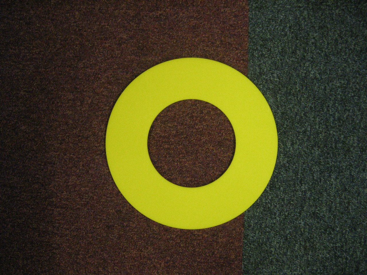

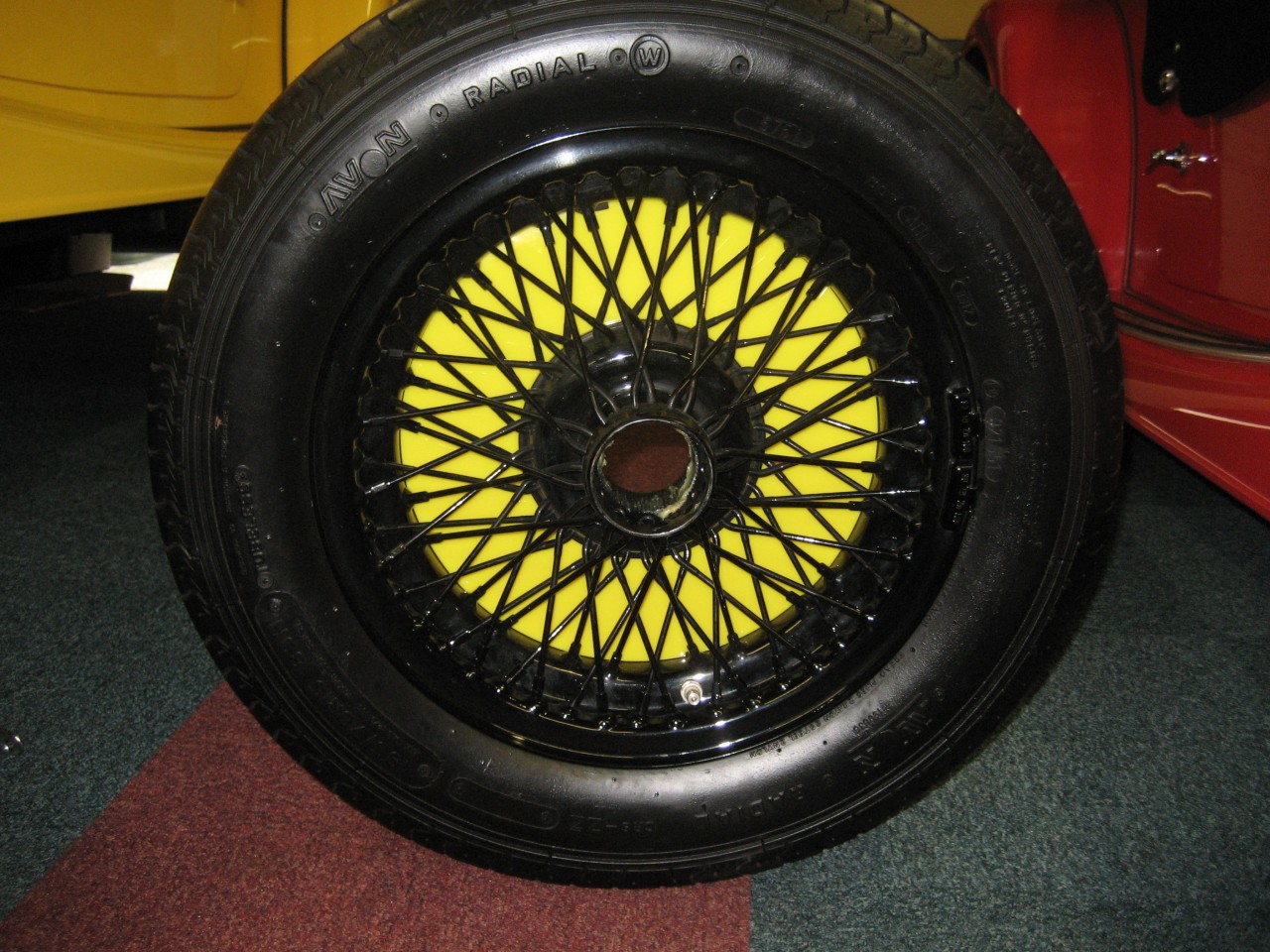

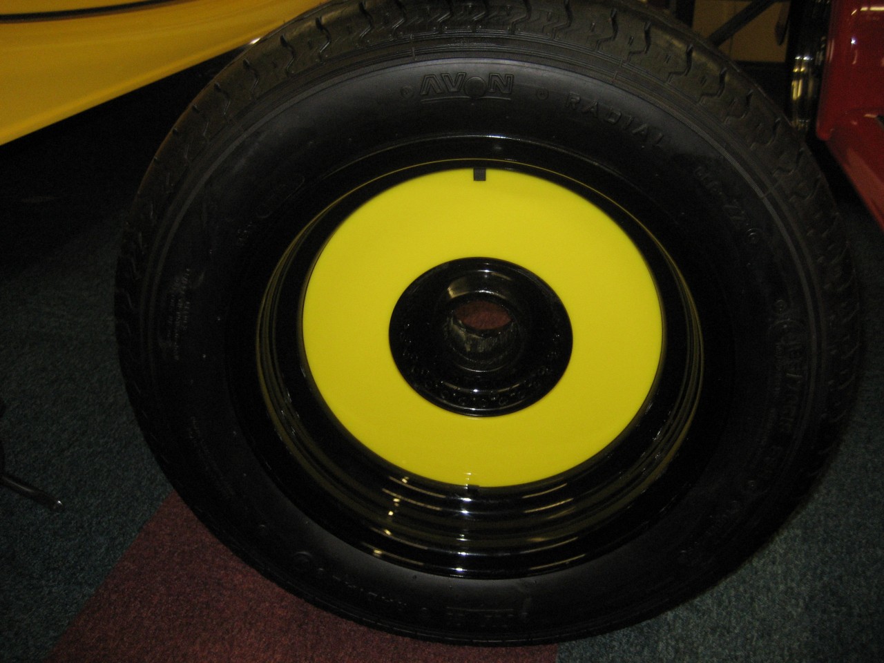

When I bought one of these for the Roadster, the red was a perfect match. This time not quite so lucky, the yellow is more of a number plate yellow.

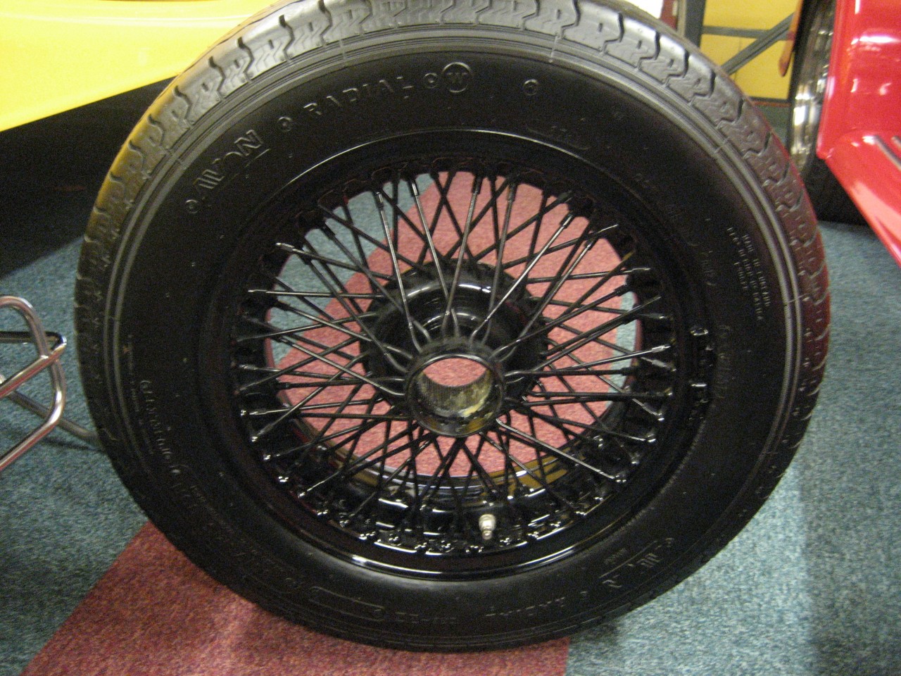

So, here's the spare:
And now......
Because it doesn't quite match I'm wondering if I should have gone for black. Anyway I can always get one and compare.
The dimensions for the 4/4 wheel are diameter of circle 322mm, diameter of hole 165mm. Available from 'The Plastic Man', where I also get my windstop acrylic.

One option if you can't colour match the circle filler piece is to cover in a bright fluorescent reflective on one side and some of the 3M black reflective on the other. This shines white in headlights.
That way you can have it in many guises, to suit the journey and conditions.
