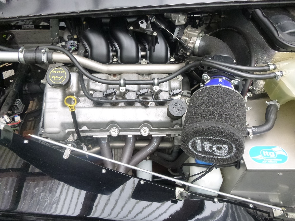

Air Induction Kit Roadster 3.0
Had this fitted when I had ECU Remap done.
Jim.

Which version of the 3l is that, the ST220 or the Escape. Has it made a difference, I had my ECU chipped by Bluefin on a ST220 plus the Sports Exhaust and I can't say I noticed.
Looks smart.
ST220 and yes 20 bhp more and much smoother through the gears.

Looks very smart and nice bonnet stays! thumbs

Now that the plugs are exposed, beware of water getting down inside the recesses, as happens with the 4 cylinders.

Do you know the product number for the ITG induction kit ?
I can only tell you that it is a ITG MAXOGEN AIR FILTER 73MM ID CYLINDRICAL with a Samco straight coupling hose 76mm id and stainless hose clip 70-90mm.
Thanks Dave I will keep an eye on that.
Bonnet stays made buy Cain, they are very good.
