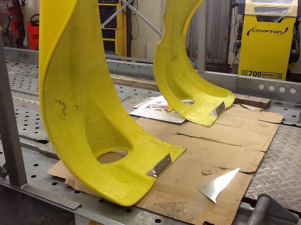

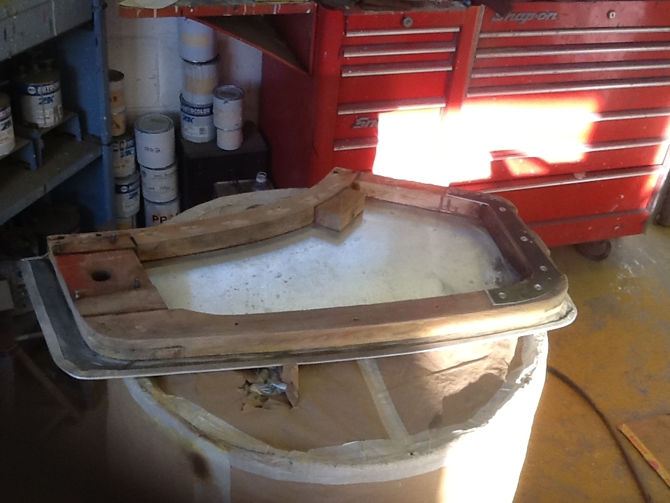

Next up was painting Woodstock - we stripped the tub down and before sending off for painting we fibre glassed on the aluminium tabs onto the inner wing we want to use to help mount the front valance.
Setting them up to dry overnight

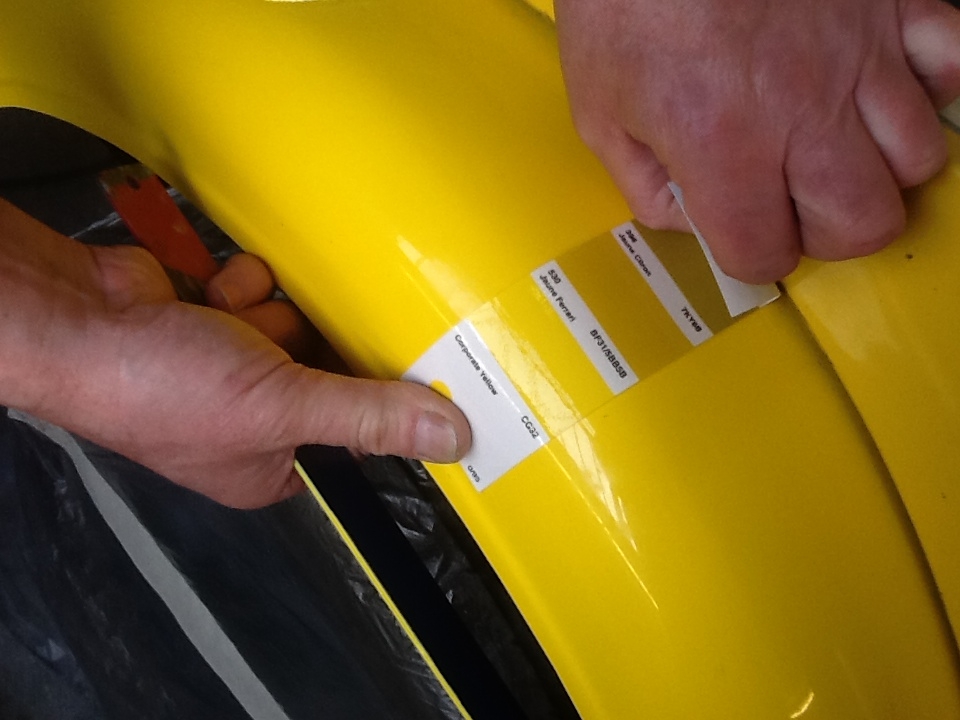

Next up was sorting the right yellow - our original idea was to paint the whole car the Citroen DS3 yellow... we even had a sample painted up which we liked.
The problem we have had was that in the mean time we have powder coated a load of parts in grey... now initially that does not seem a problem until you hold the orangey yellow up against a bluey grey.. yuck.
Having mounted the wings we found that the more zingy yellow worked well so we needed to find a new yellow that was going to work with the roll-bar and wheels.
Dad had an initial go with David to see if they could find a similar yellow to the wings that would work....

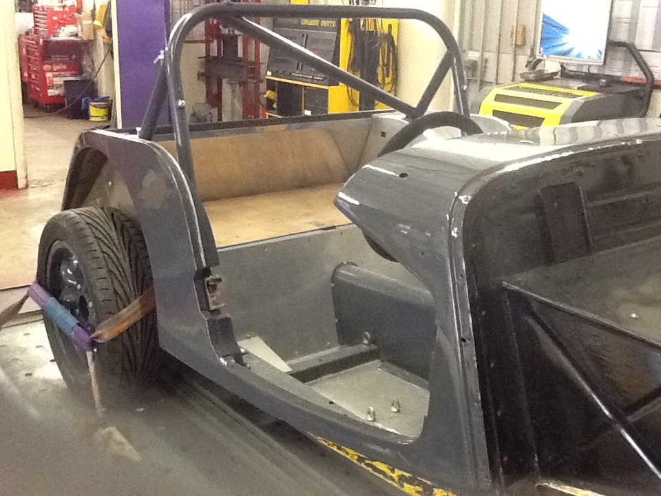

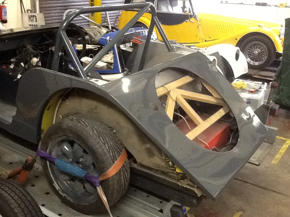

In the end a grey similar to the interior was picked along with a slightly louder zesty yellow for the accents.

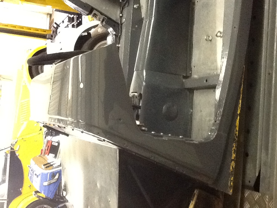

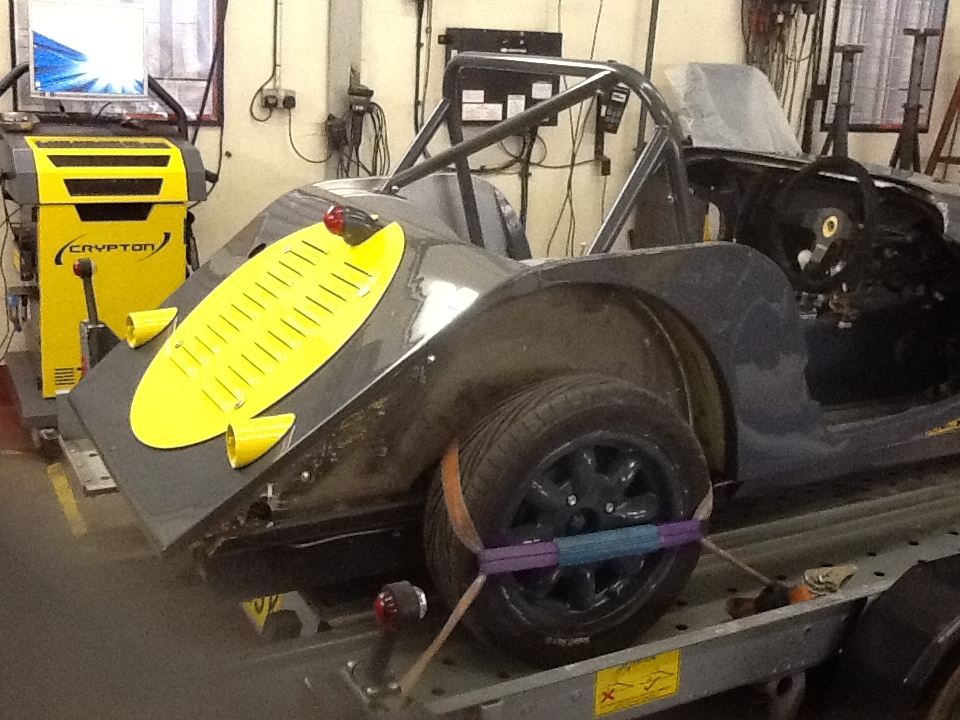

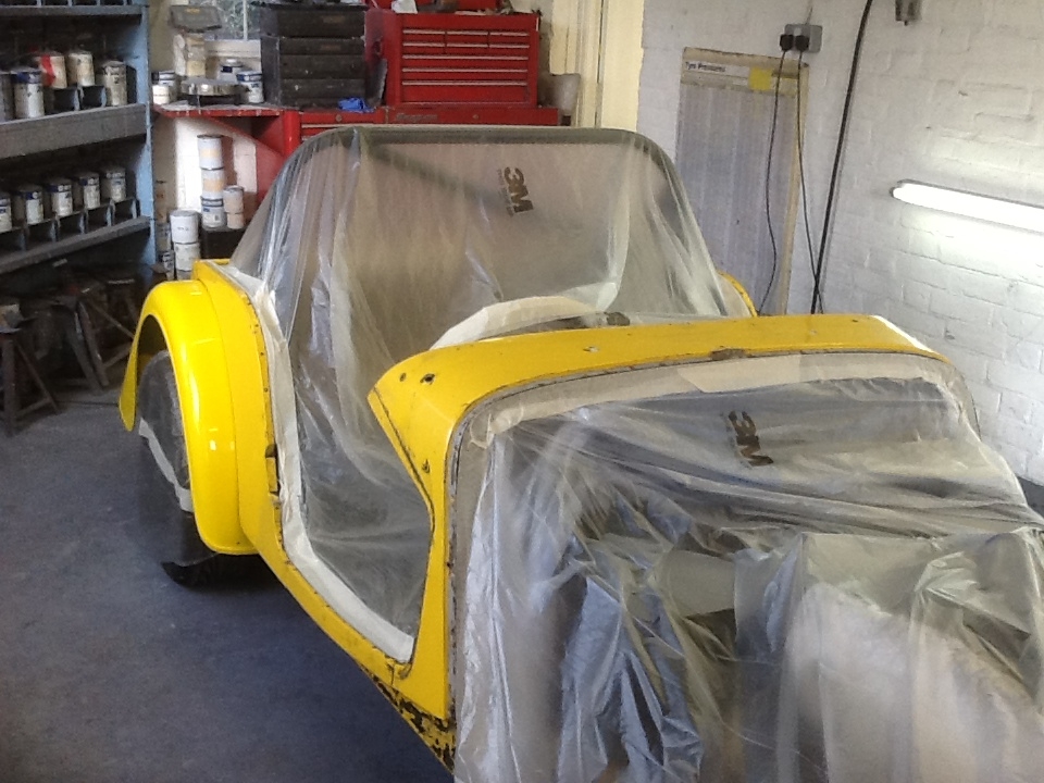

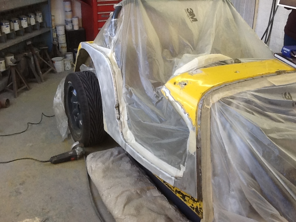

As with the Blue and White car Woodstock underwent a complete strip to the metal and clean up... on this tub however there were ripples in the metal, holes in the wrong place and the odd shaping of the O/S rear wing aperture on the leading lower corner.
David spent some time cleaning all this up to the point where it was all straight and looking like new.
Looking at the O/S rear wing alignment
Assessing the back panel.
Stripping it back to the metalwork.. again several layers of paint since 72.

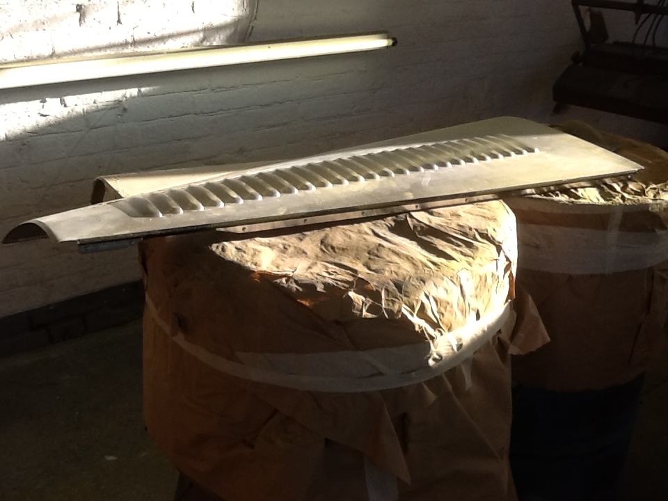

The cowl was cleaned up, sand blasted and any fatigue cracks welded up... the grey was tested out to see what it looked like... matches up nicely.

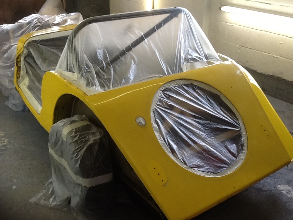

Another nice straight shiny tub - David did a great job - much better than expected

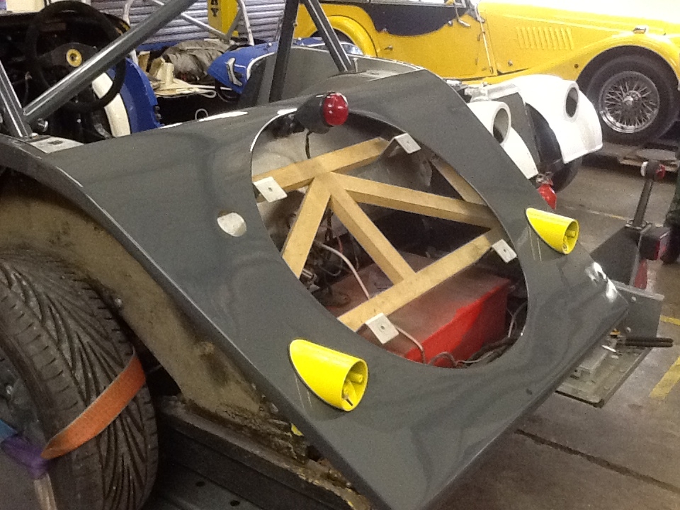

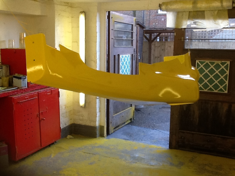

David also painted the yellow accent pieces... apparently the yellow was very watery so quite a few coats were needed to get the coverage we wanted... still again it looks great.

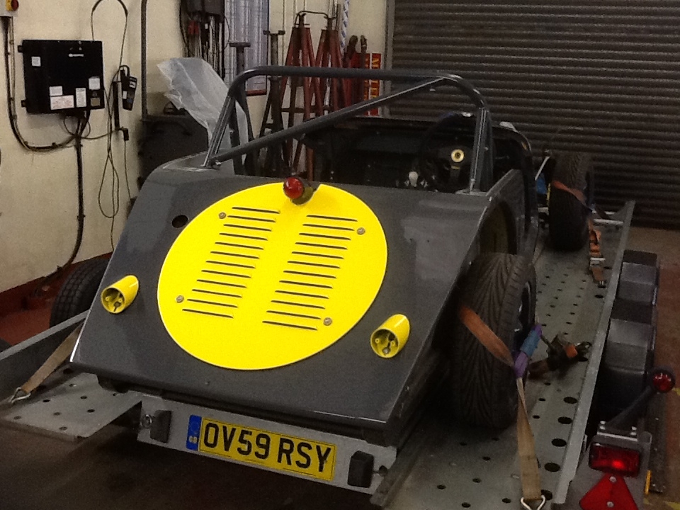

First teaser
That is one slap your face loud contrast

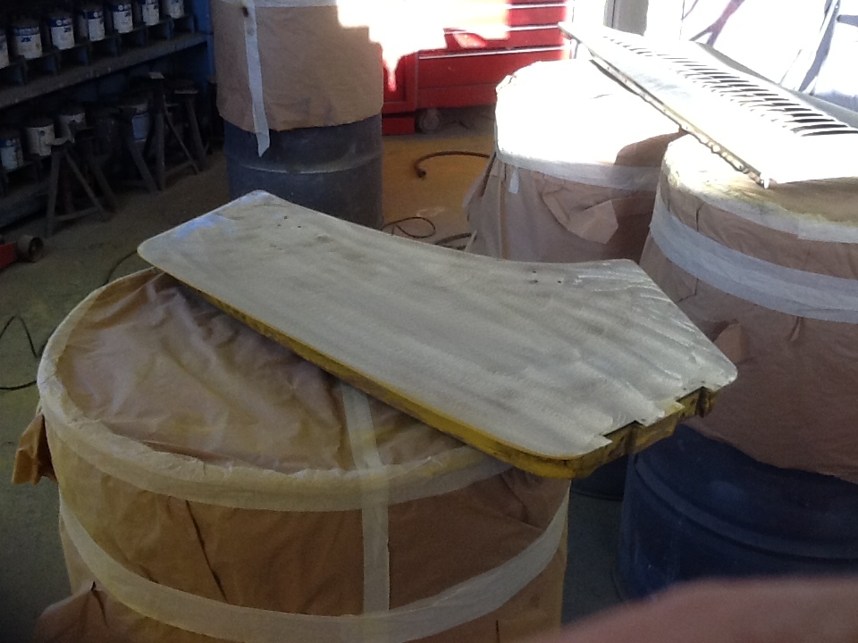

The bonnets and doors were painted next...
Again the doors were stripped right back to get a good finish.

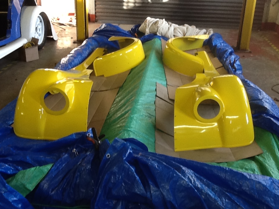

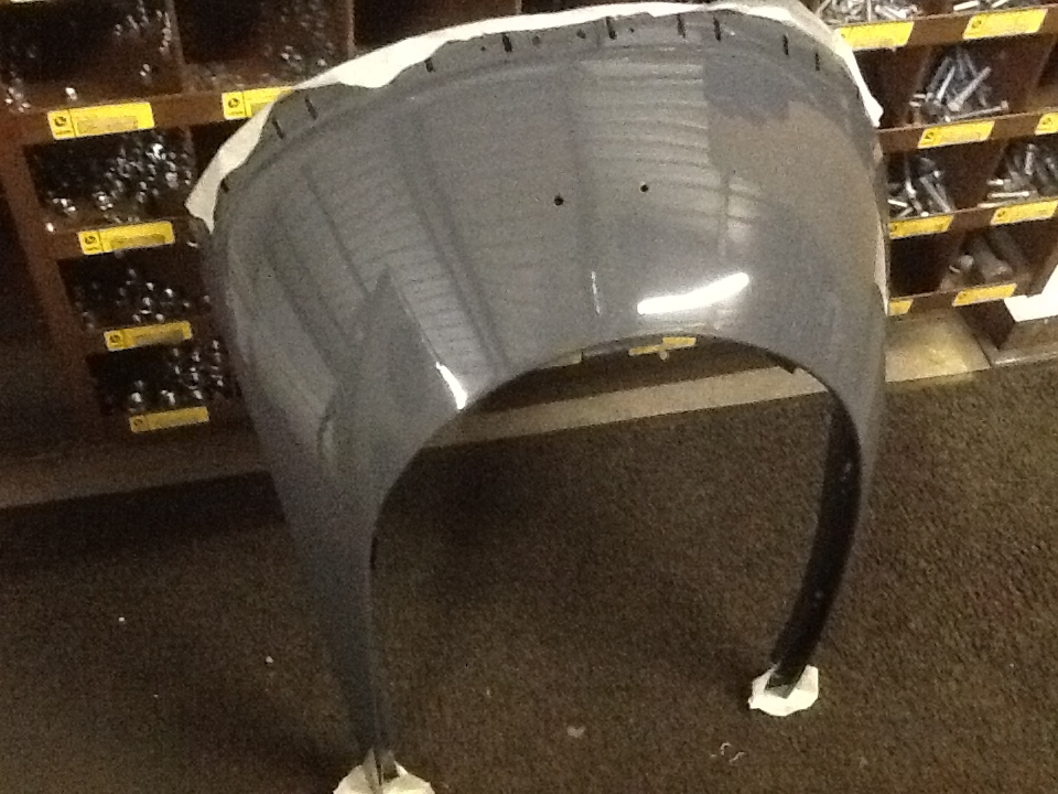

Unlike the Blue and White car - we decided to paint the wings so they went through the paint shop individually
Here is the full set of painted wings ready to be fitted.

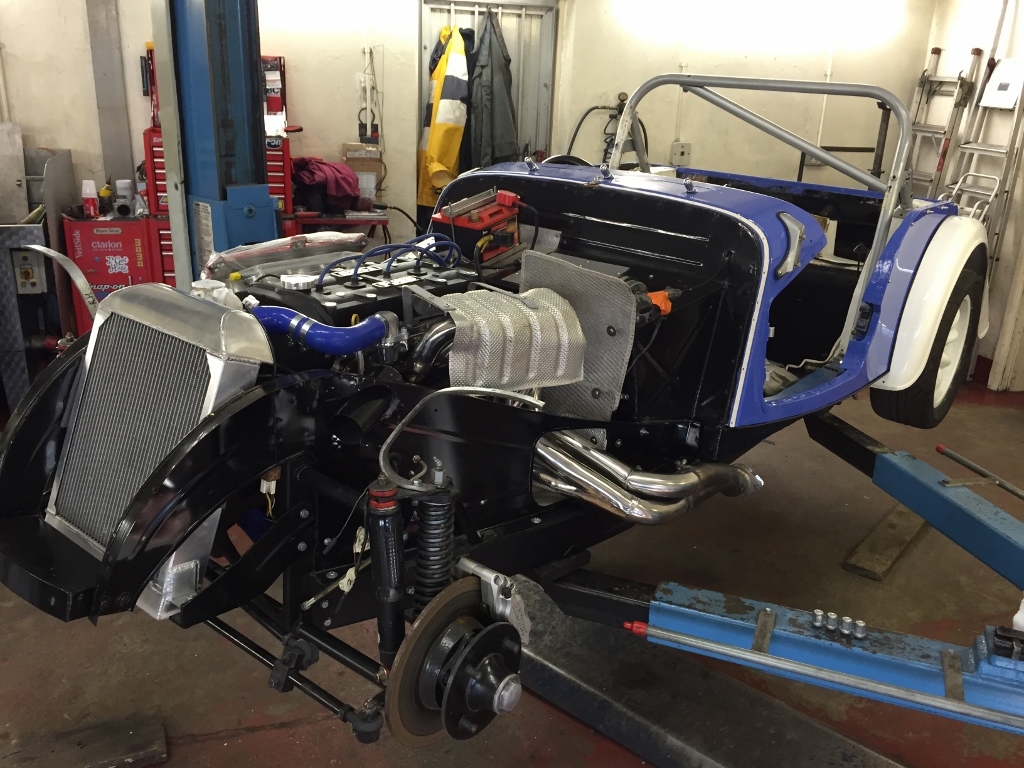

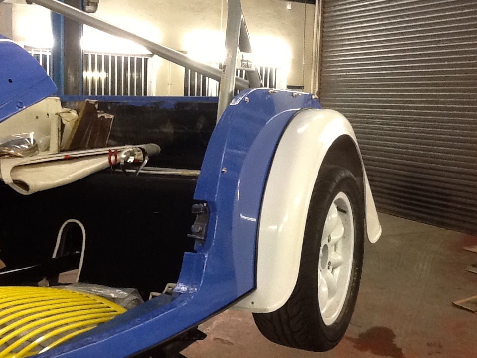

Update 43 - Final fit of White wings

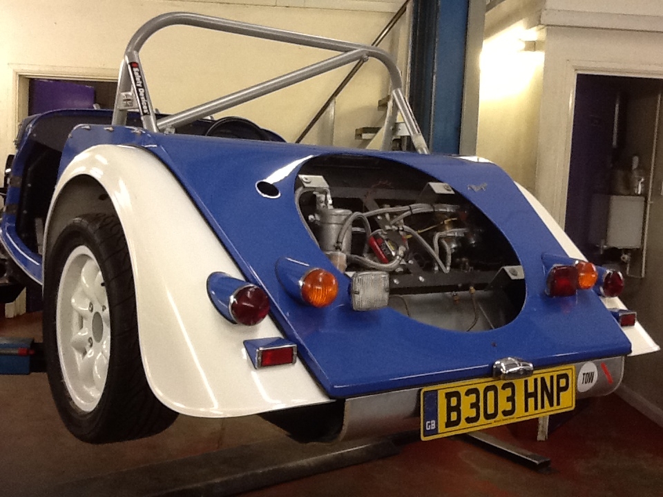

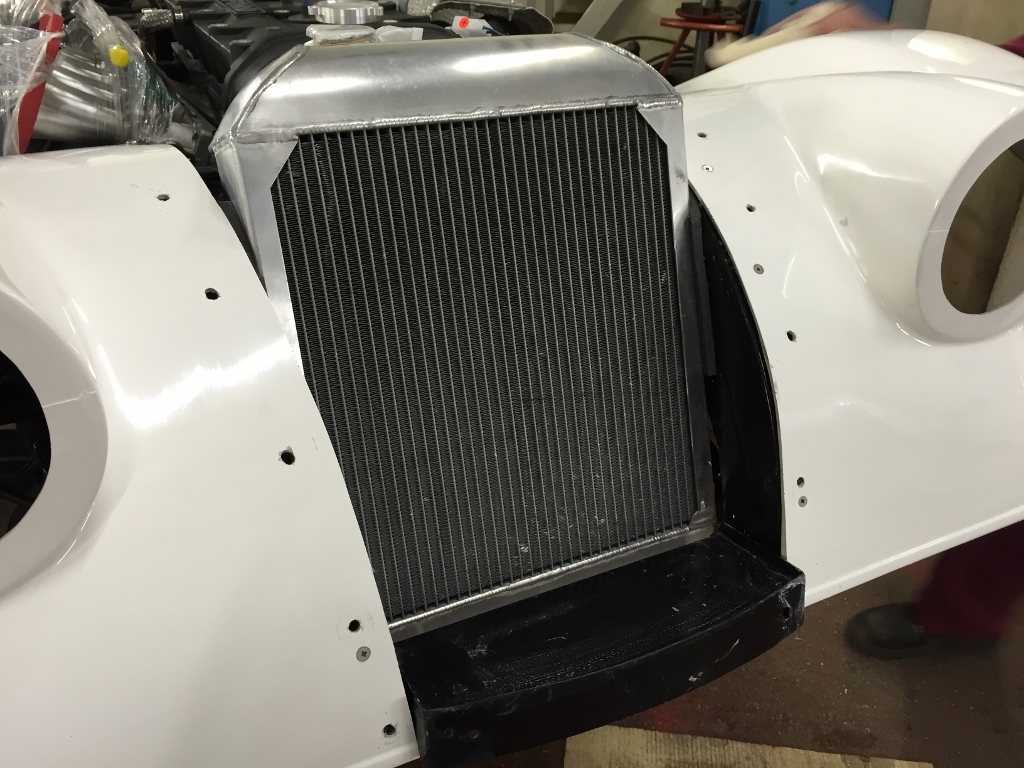

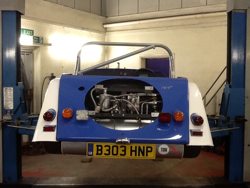

Now we have the Blue and White car back from paint we need to final fit the wings. Like the first fit of Woodstock this starts from the back going forward.
We have new rubber trims to go round the whole car. All the rear lights are new and the plinths positioning need to be right first time.
Using the same SS nut headed 3/4 inch screws the rear wings were mounted with windscreen sealant around the inner wheel-arch and a small amount on the rubber beading to keep an edge seal to stop water ingress between the wing and the tub.
You can see a sneak peek of Woodstocks grill laying in the passenger footwell.

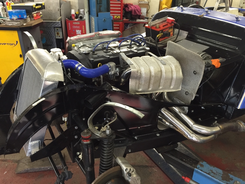

All the radiator, exhaust manifold and intake has also been final fit - we have also fitted heat shielding around the starter, crank timing electricals and finally the over the top of the exhaust to stop radiating heat from blistering the bonnet paint.
We will also be wrapping the exhausts - but not at this point.

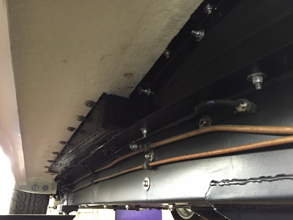

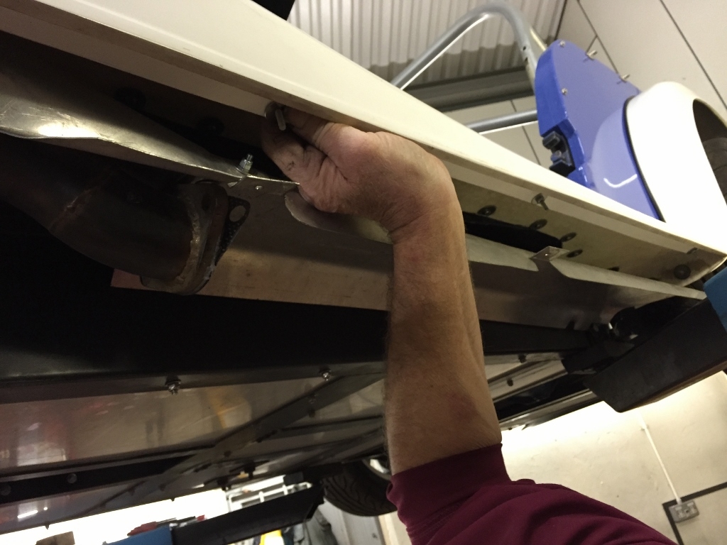

For the front wings the outline positioning holes were already in place from first fit. So our focus just needs to be on putting the screws that go in under the wings in to the sills.
You can see the neat line of SS screws in the photo below - you need to be very careful how you put these screws in given the increasingly small overlap with the main tub as you come towards the bulkhead.

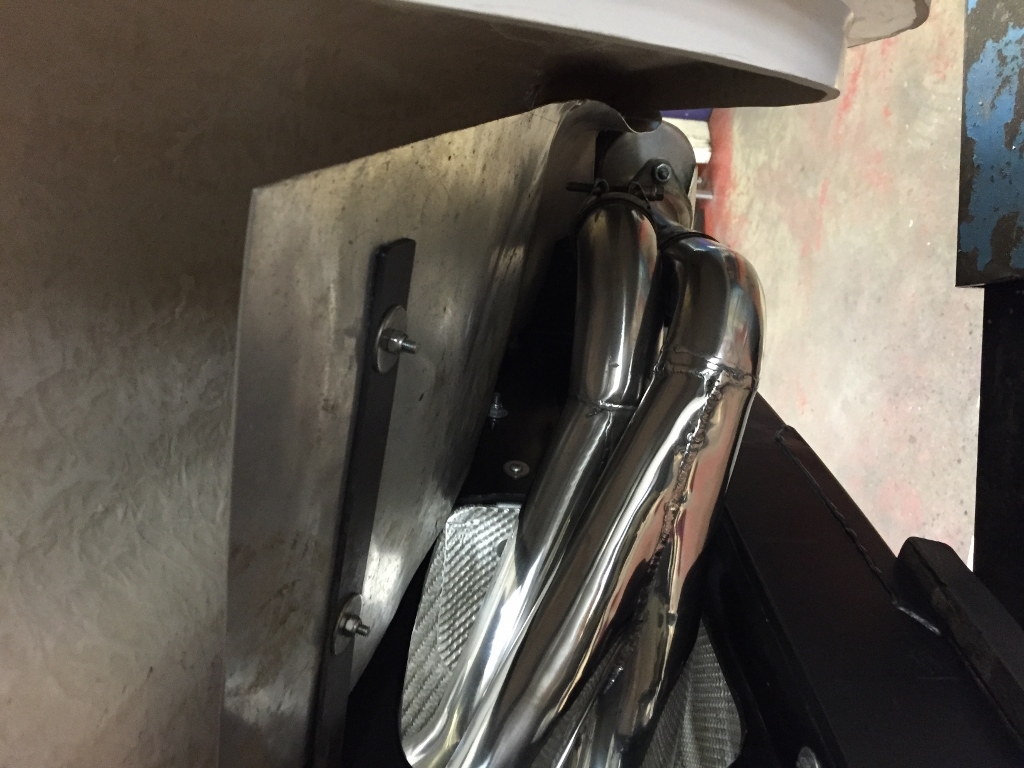

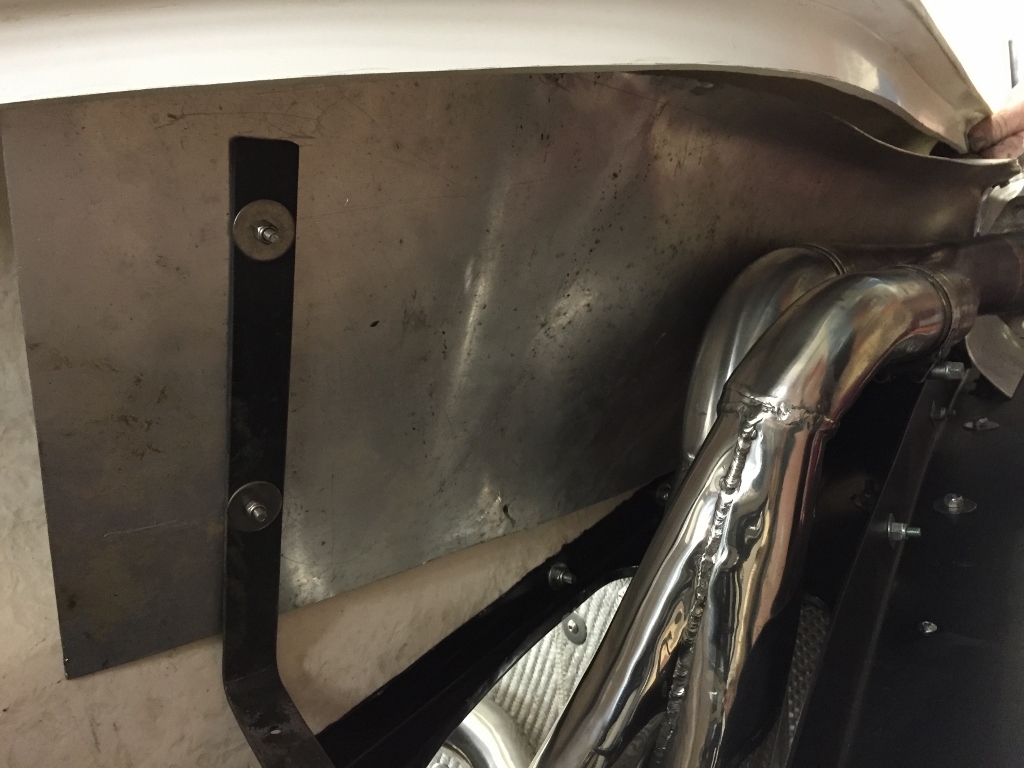

Next job was the fitment of the exhaust side pipe and the heat shielding to that goes over the top of the exhaust.
We managed to rescue the heat shielding ready to go again... you can see the longer of the two parts being slid into place.
The front section has a floating bracket to hold it over the top of the end of the exhaust manifold.
You can see the stand-off distance as it runs along the length of the wing.
Given the wings are gel coat there a few mould lines around the front light pods. 30 mins with some 2000 grit wet and dry has removed them and an orbital polishing mop and buffed the shine back into the wing.
