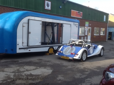

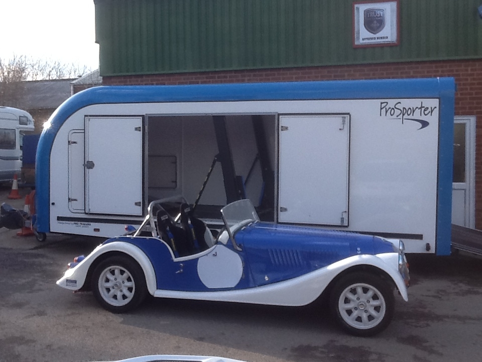

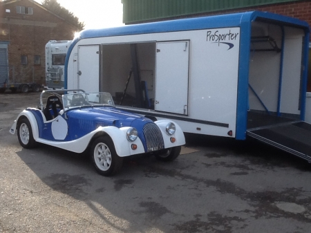

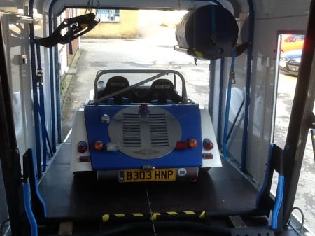

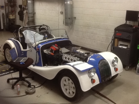

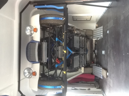

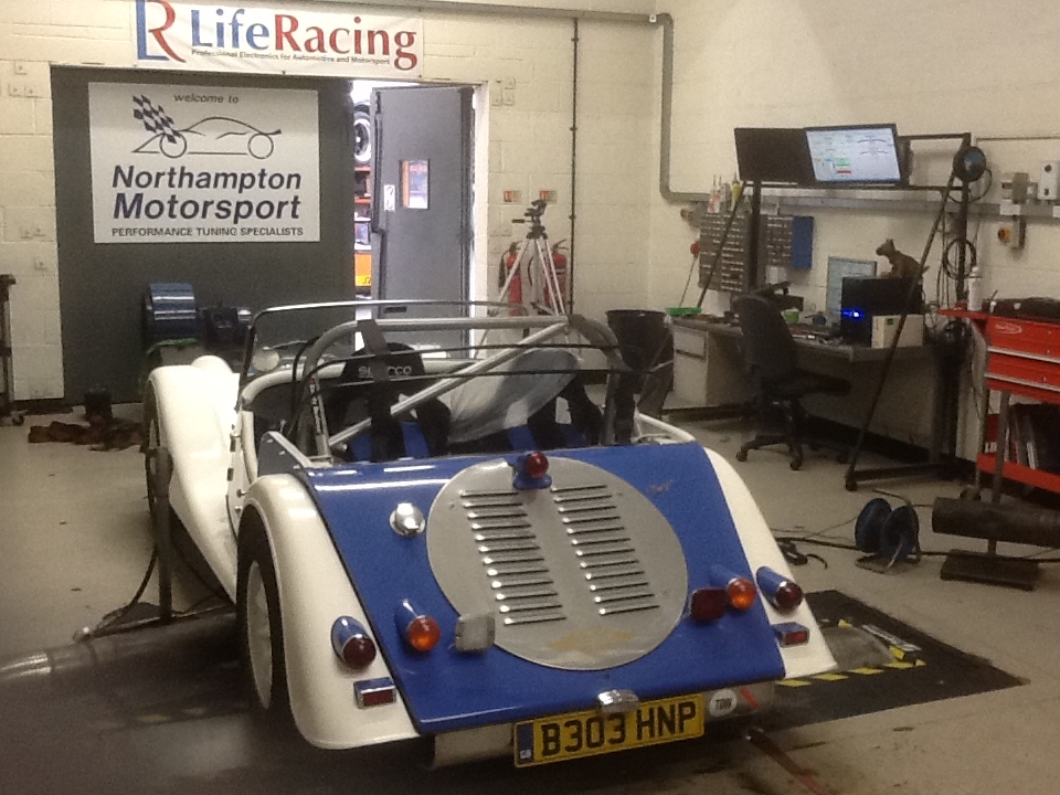

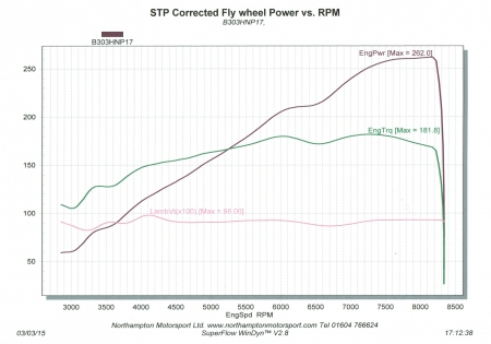

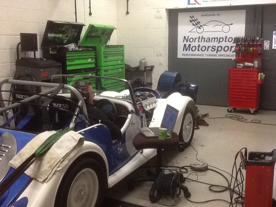

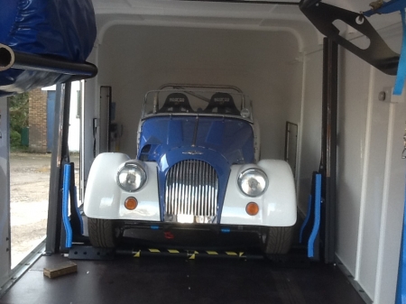

Update 50 - Trailer lift, Rolling Road and power!!

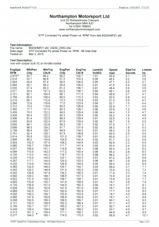

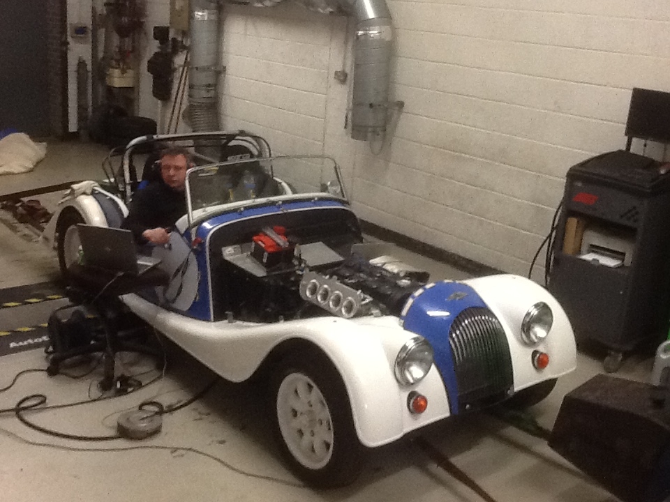

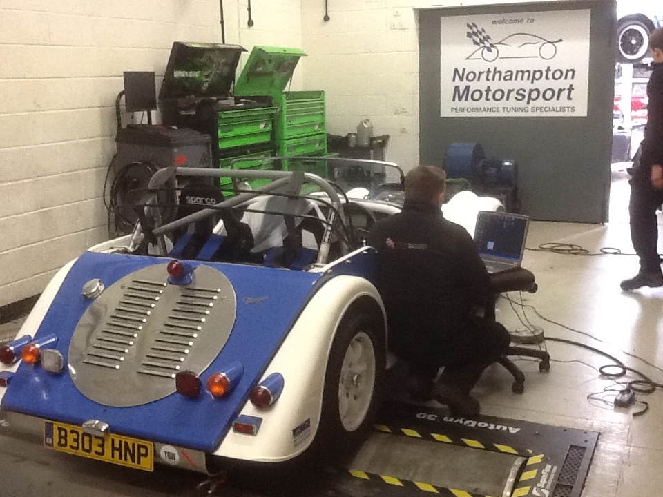

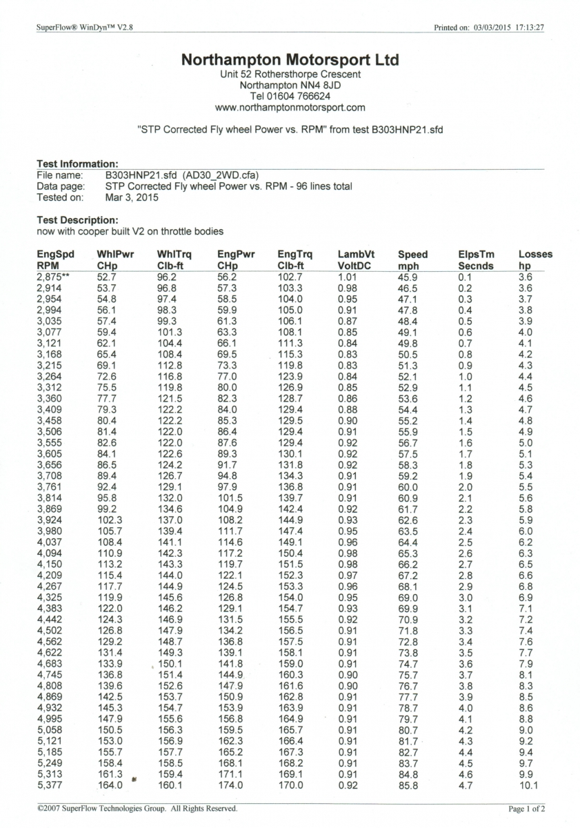

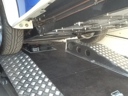

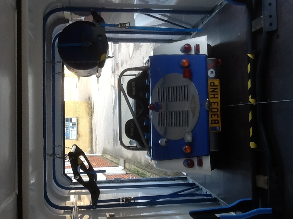

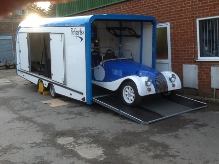

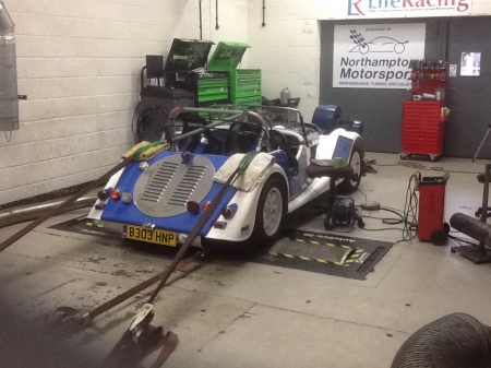

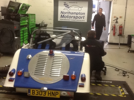

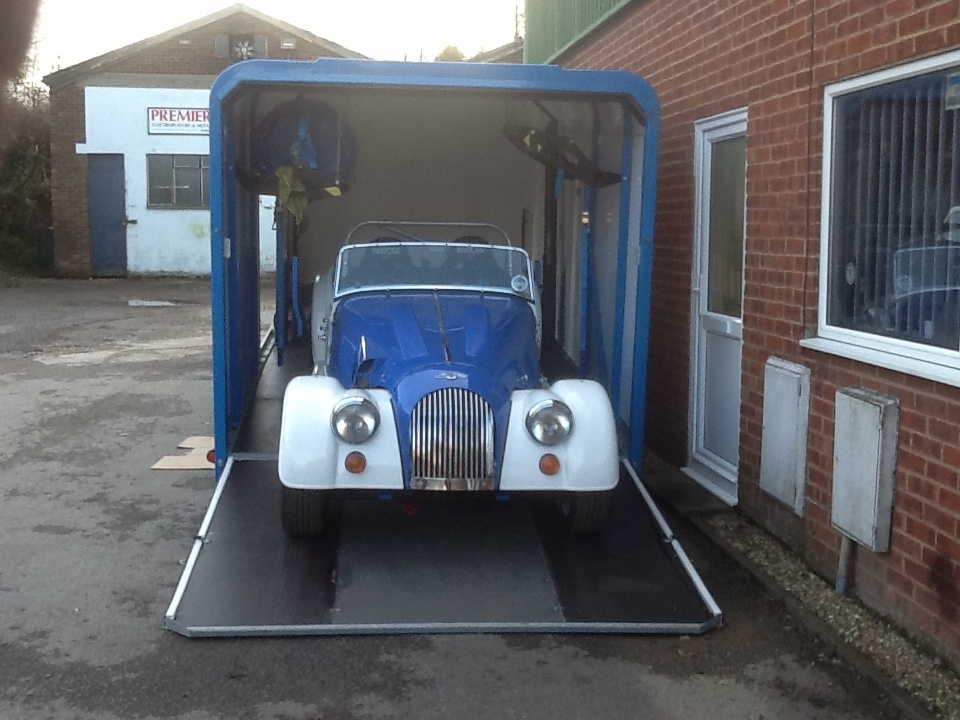

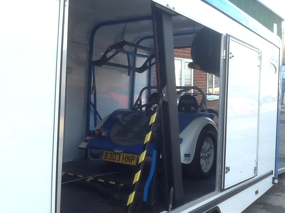

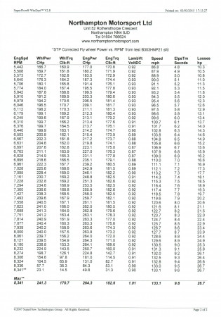

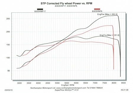

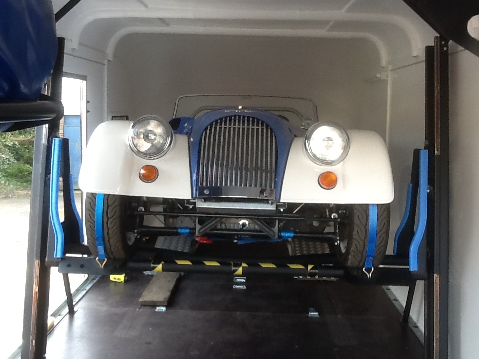

The trailer was sent off to PRG to have the Hydraulic second deck fitted... works a dream. Also we managed to grab a cancelled slot for the Blue and White car at leading Omex agent Northampton Motorsport to have the engines initial start, run-in and set-up. Finally - what power did it make? (the power graphs are not quite the final ones - but the power tables are).

That torque curve is just fantastic. It has a very broad band of near maximum torque. Incredible for a highly tuned race engine. I imagine that the length of the inlet tract and the design of the exhaust manifold has a lot to do with it. Other than the obvious of the cam, pistons, ports etc.

Wow, a trailer lift. I have never seen one other than for a giant semi trailer. This makes transport of multiple cars amost with in reach of the common man. I am assuming from the pics that one is angled up the second car is positioned underneath??
