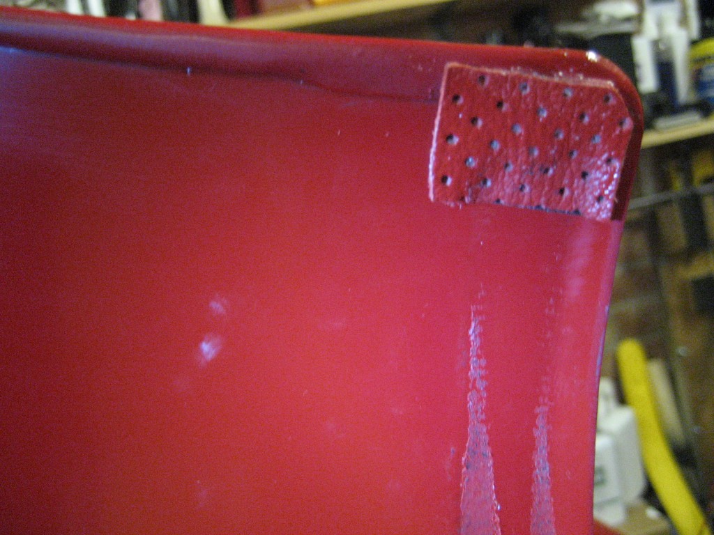

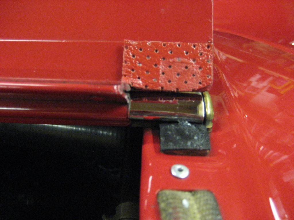

These are my latest acquisitions - all fine (thin) leather except for the yellow, which is quite thick.
And here is why I bought them, (not the only reason).
Here's the cowl lower edge.

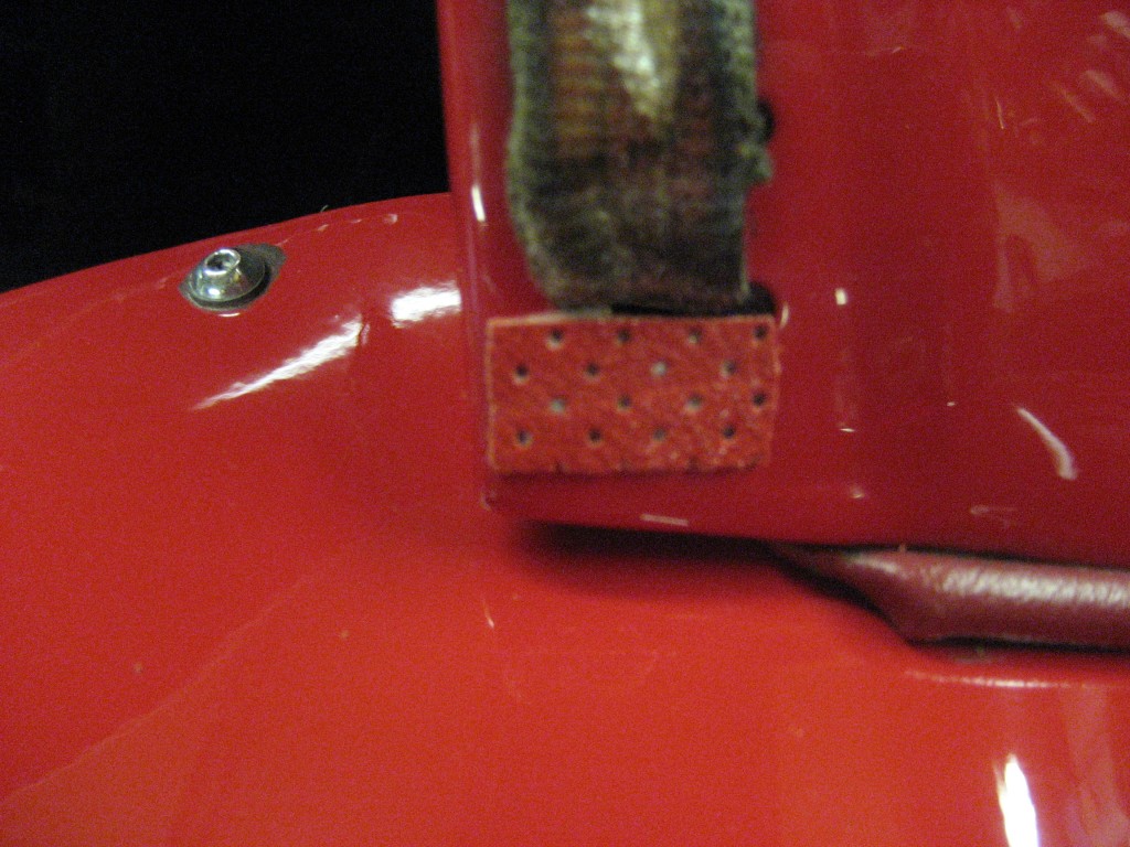

Cowl upper: The Vaseline is obvious. The red patch is bigger than necessary but the tinwork here looks better fully covered than part covered. The hinge plate is covered with thin black leather. I use two thicknesses of double sided tape, depending on how much space there is.
And bonnet front corner. Here the overlapped edge means that a stepped thickness is needed, so there's a strip of neoprene to level the buffer. On this corner (and elsewhere), the paint had rubbed off.

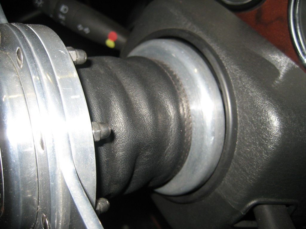

Finally, do you have an elongated steering wheel boss as below, and does it reflect into the screen?
I made up a leather cover for my Roadster a few years ago. And there was enough left over for one more cover. The offcut came with a turned over and stitched edge.
If you would like this cover, which attaches with a strip of double sided tape, (stitched end away from steering wheel), send me a PM and you can have it! Only one available though.

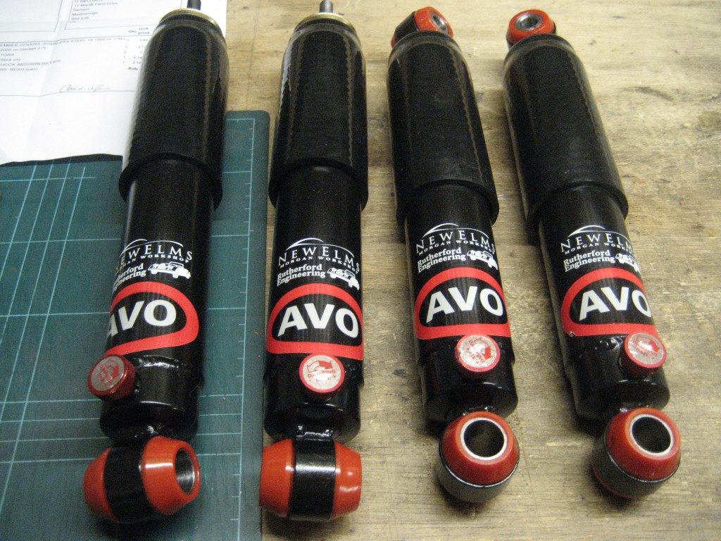

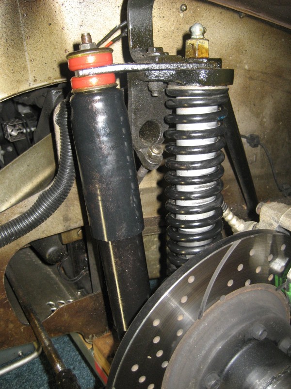

This week I've managed to get a couple of hours in the garage and changed the front dampers. One of the rears has a slight leak so rather than mess about, I'm doing a refresh.
The new ones have New Elms/Rutherford stickers:
Here is a comparison, Old & New. There's a slight difference at the bottom.
And here we are - good as new. It still looks good under there at ten years old. Note that the main springs don't pick up much road dirt. The damper fasteners are UNF threads, 5/8" or 14mm spanners and a 4mm allen key for the top.

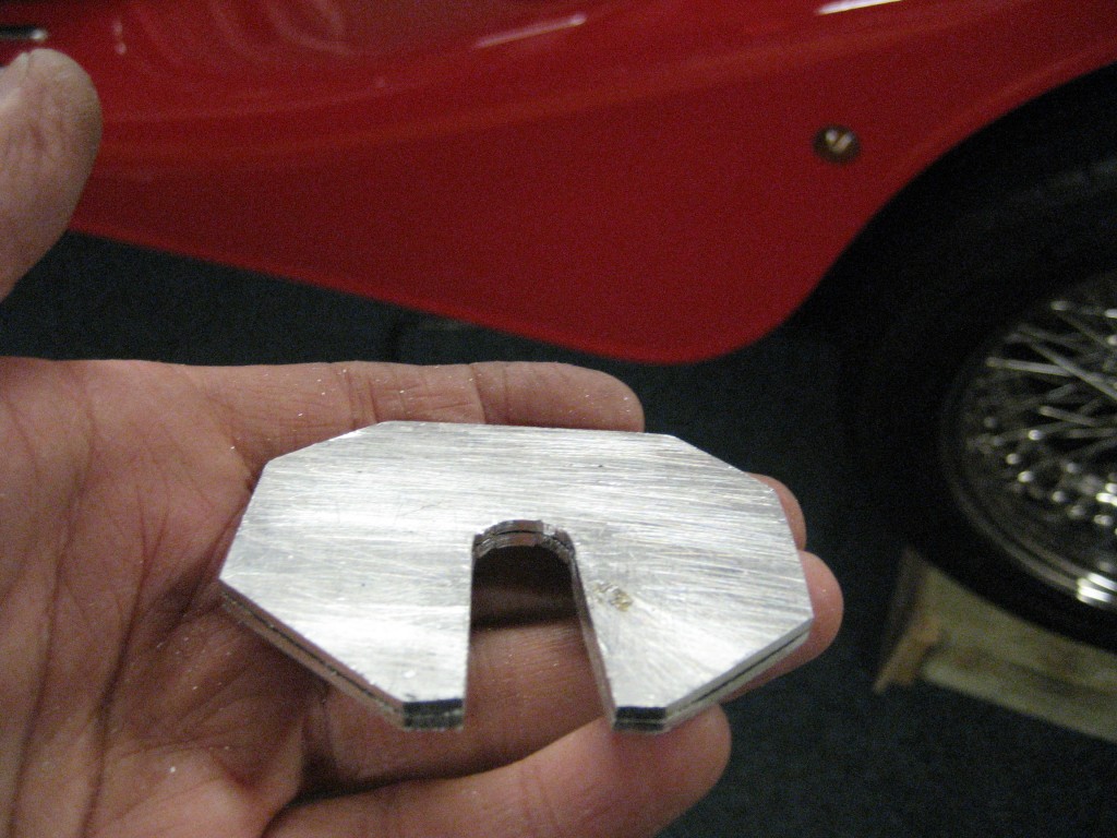

My second job this morning was to add spacers to the engine mountings to increase the ground clearance. I used two pieces of aluminium cut into a U shape which give a 4.55mm lift. I might add another 2.25mm spacer in time. It's a very simple job. Remove the lower nut - there's also a washer which may drop down. Then I screwed on an extended nut which I used to jack up the mounting using a scissor jack, then slotted in the spacer.
This is the spacer in place. The lower nut is 17mm. Sump clearance has increased from 79mm to 83.5mm (3&1/8" to 3&1/4"), not much but even a small increase is worthwhile.

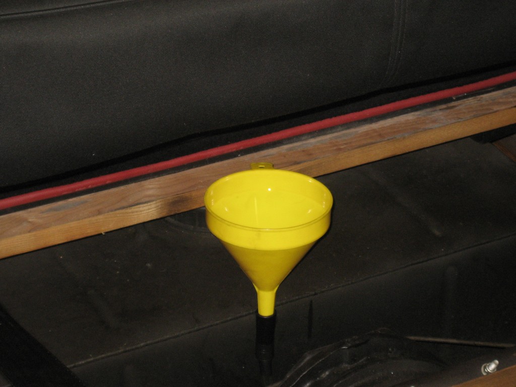

And my special funnel & tube for the rear axle.

The rear axle dropped about a litre and a half of really clean oil. Until this change, what came out was discoloured but this time it looked new.
The gearbox only drops about a litre, and what came out was discoloured. The capacity (from memory) is more than that so it must hang around somewhere inside. The Getrag is a difficult fill, because immediately inside the casing is a gearwheel, which makes it tricky to locate the tube and hold it steady. I lost my touch this time because a fair dollop landed on the newspaper below. Normally I'm quite tidy with few spills............

Thanks for this, the spacers look like a nice idea. Does it not put strain on the propshart and gearbox mounting?
Posts: 22,385
Likes: 358
DaveW Offline OP
Posts: 22,385
Likes: 358
No it's such a tiny amount. I later added the third layer to the spacer. I could probably get a fourth in there but be mindful of clearance to the bonnet hinge. There's plenty of flex in the gearbox mounting, and no difference to the feel on the road. A few mm isn't much but its a critical few mm, and such an easy fix.
