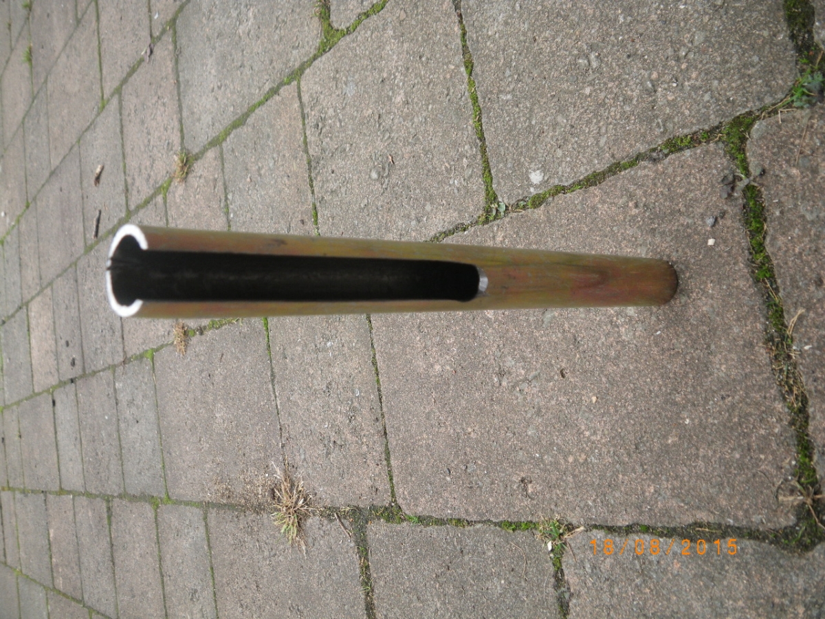

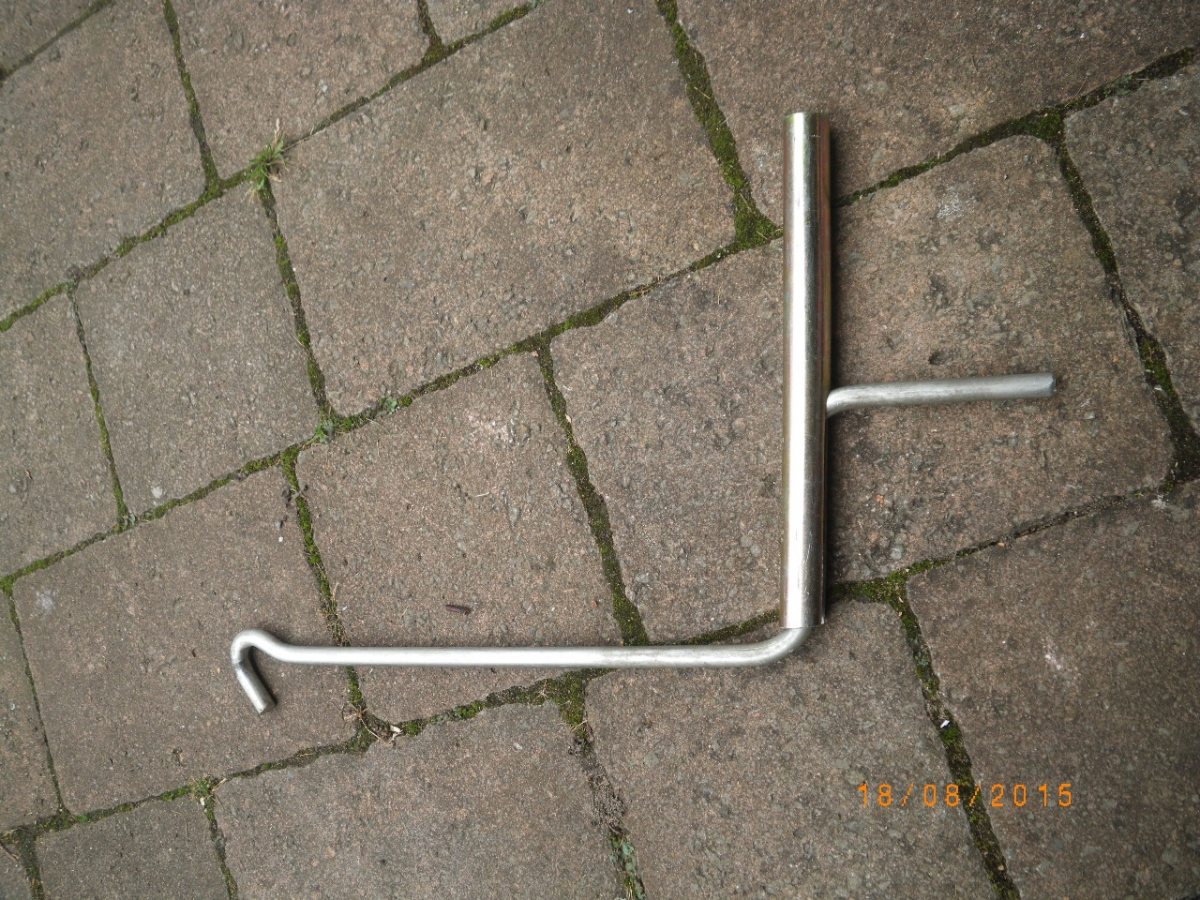

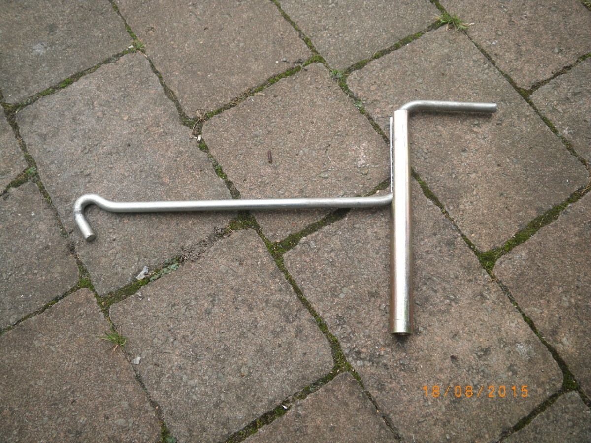

I had great difficulty in raising the car using the standard jack. I sprayed aerosol grease into the thrust bearing on the jack but it was still quite difficult. I then made an extension sleeve to add to the handle and gain additional leverage and hey presto I could get the wheel off the ground. The tube was selected from a VW Golf wheelbrace with the bend cut off and then a slot cut by hand.

Very clever stuff

Very neat, nice job and a good idea!

Very good idea. The other end could also be used as an extension for the wheel brace on wheel nuts.

Top idea.

Great thinking.

Bright idea!
I had to change the wheel late last year : it didn't take too long (15') BUT my poor hands remembered the jack for some days ;-)
