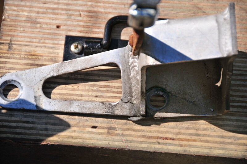

S4 Exhaust Bracket
Both my S4 (2008) exhaust brackets failed @ 3500 miles - picture shows fatigue fracture in the aluminium.
Replacement steel brackets essential! sos

Hi Orthodoc,
Can I ask how the problem presented or was it a coincidental finding?
My S4 is very close IIRC to your chassis number.

Looks like the quest for weight reduction over lightening of the bracket by cutting too much away. Then more fatigue / stress caused by the big weld so close to the narrowest part of the piece. sherlock Only a guess but what do I know innocent

Both side pipes were seen to be lower than usual and not concentric with cutouts in running board + n/s pipe very loose.
When I looked at the cracked area which is lowermost in situ and moved the tail pipe - movement was clearly seen across the bracket. It was also bent if you look carefully at the picture.
Also if you compare pic 1 in Ch Pramenoux series with pic 5 in Le Castellet series a difference can be seen.camera
The new brackets are steel which are smaller, stronger and weigh much the same!

both exhaust brackets on my series 4 broke at about 2000 miles. thenreplaced broke again. i believe they replaced them with modified brackets. no problems since

I spoke to the factory as my chassis number isn't too far away - 667.
They tell me that the very first of the S4's are fine as the wings and exhaust are located using the same bracket which are not prone to failure. Subsequent S4's changed to a separate arrangement for wings and exhaust - it's these that are troublesome. I'm hoping that I have the former as so far they remain intact! Apparently the bolt on the modified steel bracket is countersunk (as opposed to a hex bolt standing proud) which should help identify which bracket other S4's have.
