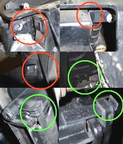

Hi,
These are pictures of the ventilator fixation of my Roadster. There are six, all plastic. The two upper ones are angles fixed with a bolt.
It is reported, that they tend to break (red circles)
If you have the same model radiator, you may want to take a closer look.
Sunny greetings,
Ivo

Ivo,
I have not checked all of mine yet but one of the top ones is broken, I'll check the others over the weekend.
Thanks for highlighting the problem.
Mark

I hope that the fix will be metal angles for the upper ones. Anyway, I'll probably ad some screws on each of the lower ones, just to make sure...
sunny

My garage installed a brand new ventilator holder, unfortunately all in plastic. An item to be watched, I guess...
sunny
