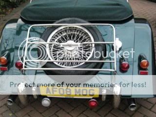

As promised.... smile
1. Move the fog- and back-up-lights.
2. remove screws "1" (there are four) Don't touch "2"
3. remove the number-plate lights and ...gotta be brave for doing this... cut away the upper part scared
4. Install a standard number-plate holder with two stainless steel angles
5. Install one of the number-plate lights. I did it with a piece of aluminum sheet metal.
et voilą roses

Very helpful. It appears that you were able to take the panel right off the car to cut it (Otherwise it would have been even harder to cut it I guess). I am therefore assuming that you were able to get it over the over-rider brackets without removing them then?

I left the panel on the car. Just removed the upper screws (1) pulled it, and cut carefully along it. It worked very fine with the metal saw holder, as seen on the picture.

The Reverse and Fog lights on the Roadster 100 are closer together so a bit more head scratching first. idea
So were mine:
I had to move them first

I did read somewhere that we only need 11mm border from the extremeties of the font so it is possible to make your plate narrower if needs be. wink
