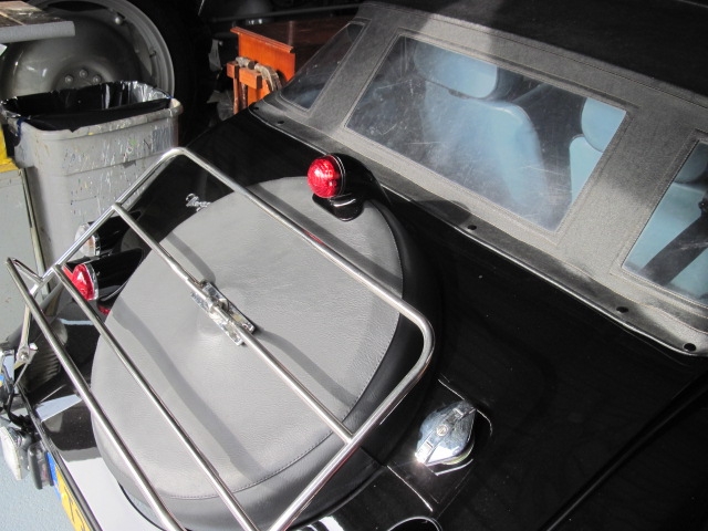

LED 3rd brake light
Thought this was a really good upgrade and a perfect fit.
Its designed for a defender so is a sealed waterproof unit, about 4 times as bright (always good for safety) and is fully E marked for European roads, unlike putting an led bulb in.
Not a bad upgrade for £16.49 delivered and 3 minutes fitting!
Its an 'RDX' make on ebay if anyone is interested and is available red as mine is or clear.

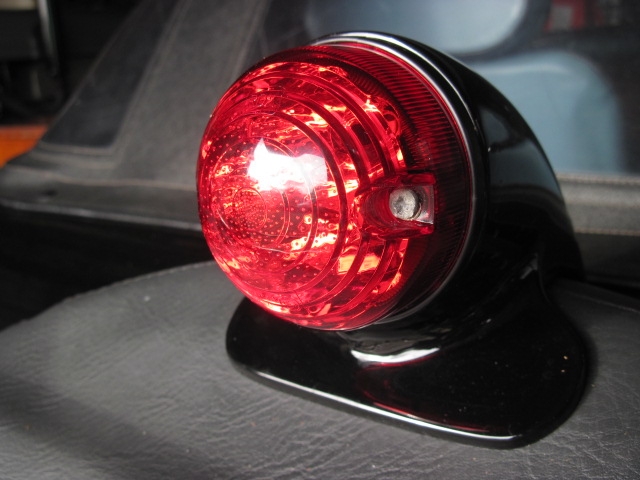

I've caused a bit of confusion here. Its the lamp unit I've changed see link;
http://www.ebay.co.uk/itm/321597742337?_trksid=p2060353.m2749.l2649&ssPageName=STRK%3AMEBIDX%3AIT
Its a direct fit in place of the bulb unit and fits using the same screw holes smile

I actually had a look after seeing yours. Looks a good move and good VFM if it's brighter, but how many wires & what is the connector, Tom?
It looks like it's a stop/tail thing, so I'd guess at three, but isn't the cobra light fitting two? Haven't looked at mine..

3 wires at the back of the unit and yes only 2 on the car, but leave the other with a heat shrink over as not required . I just put 2 new crimp connectors on and job was done easy as that.
No reason you couldnt wire it as a tail lamp as well as stop now though and would be simply connecting a feed as thats what the unit is designed for. smile
