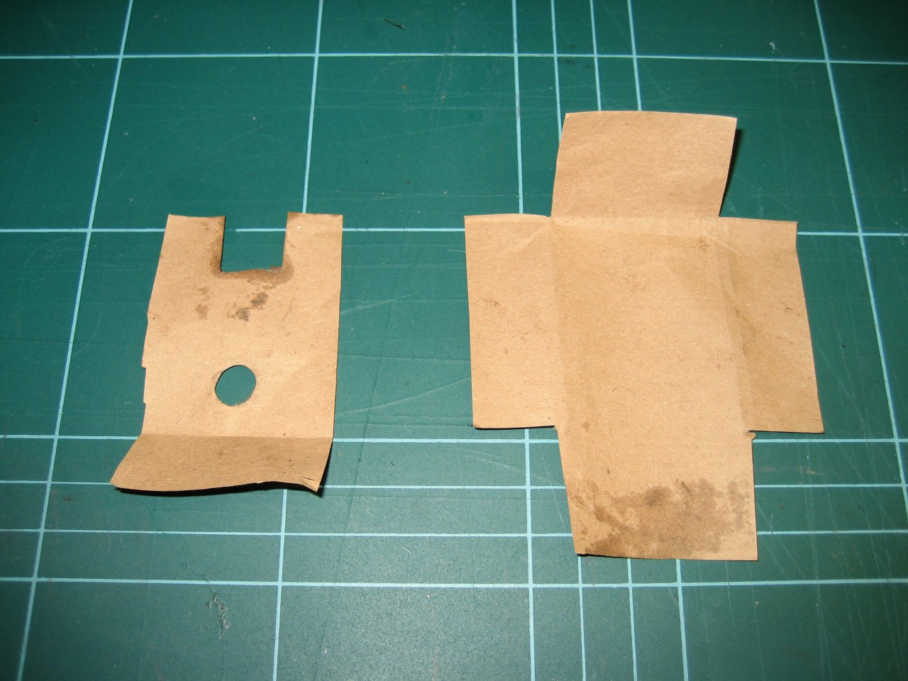

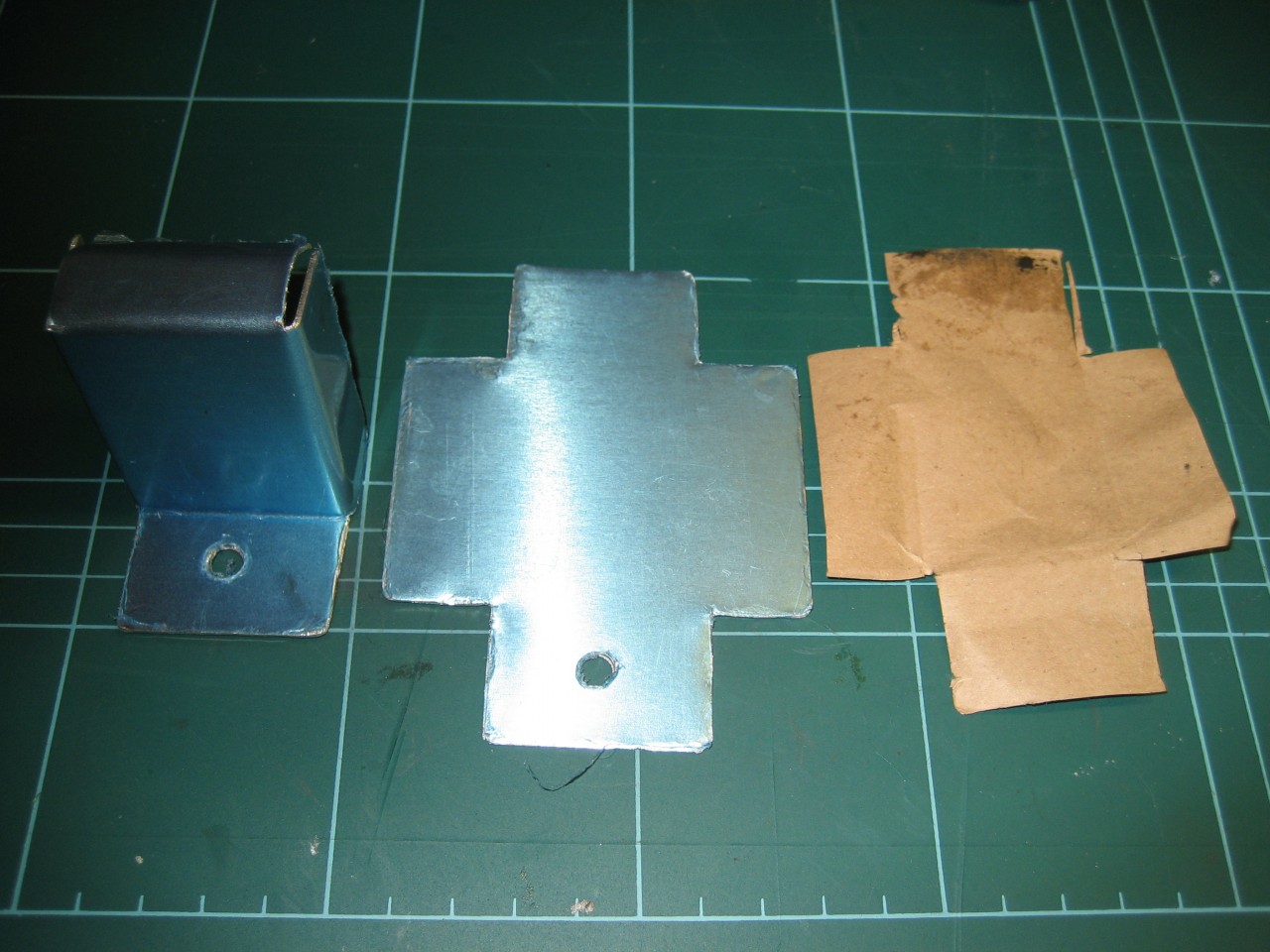

So first the templates................

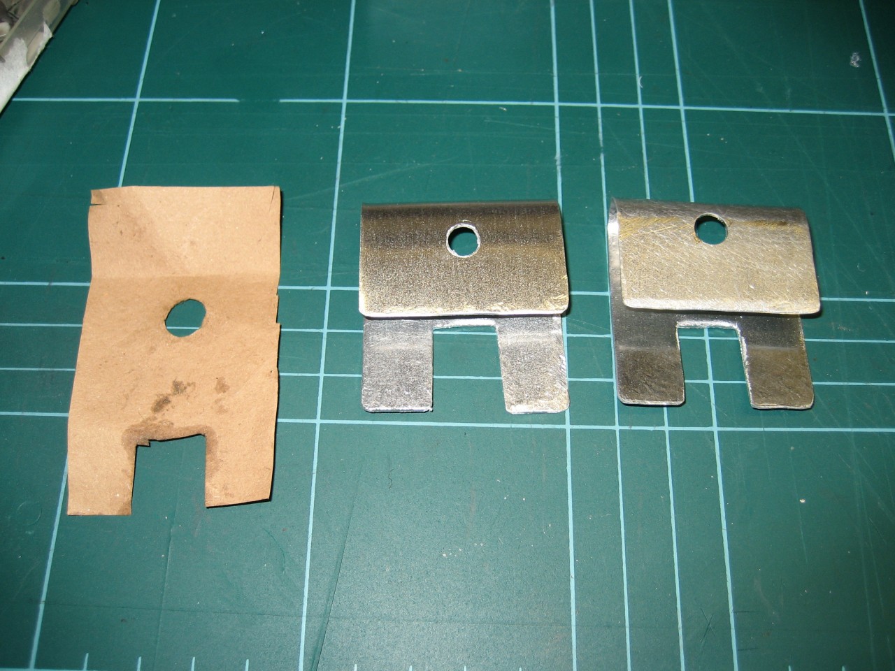

This shows the lower bracket. The one on the left has been bent to shape. This is 1mm aluminium sheet.

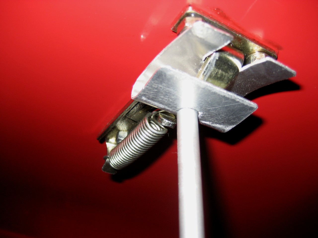

Here are the top brackets, both turned over. The hole you can see is for attaching to the tube, but underneath is a larger hole which locates on the nut.

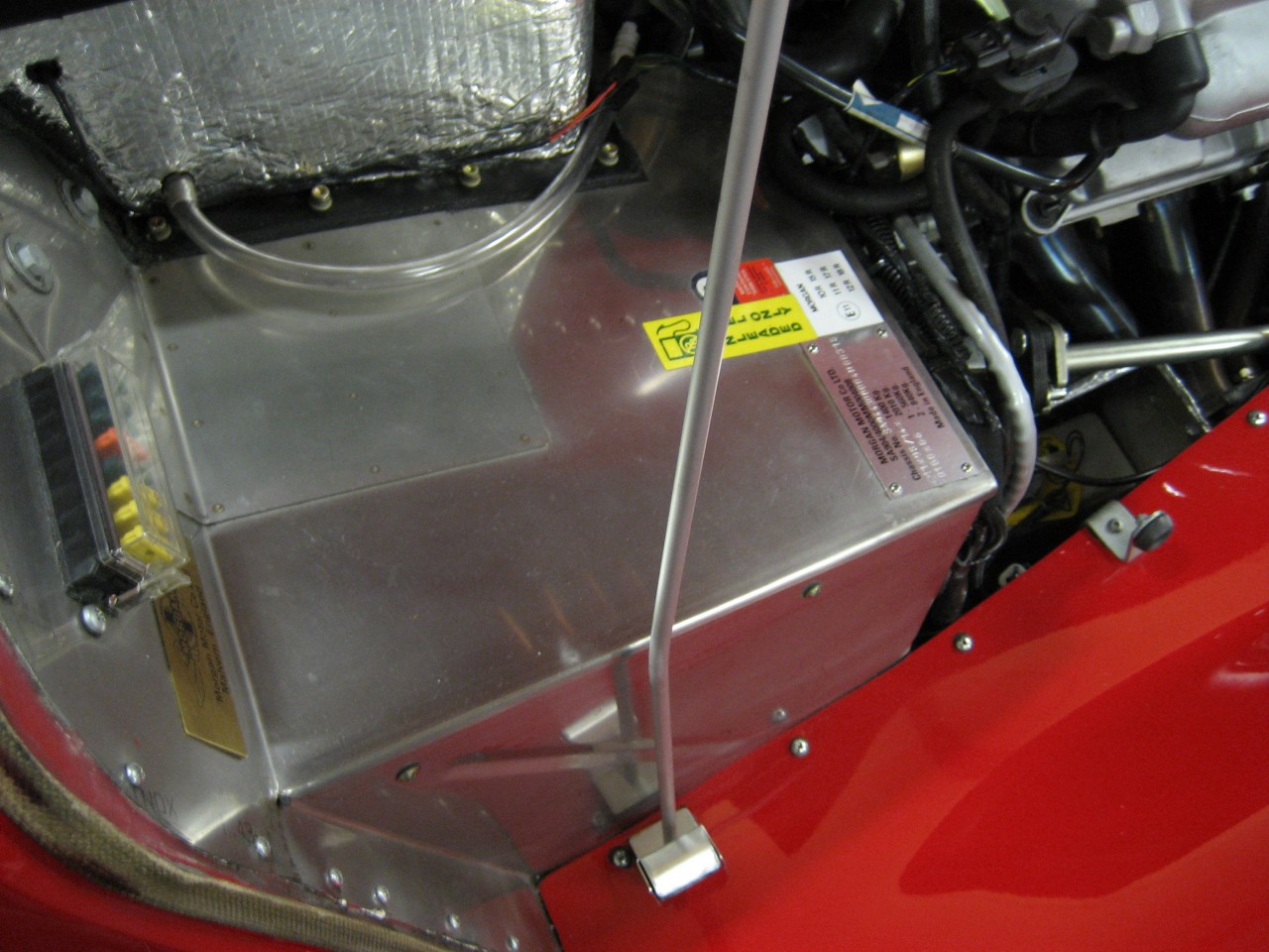

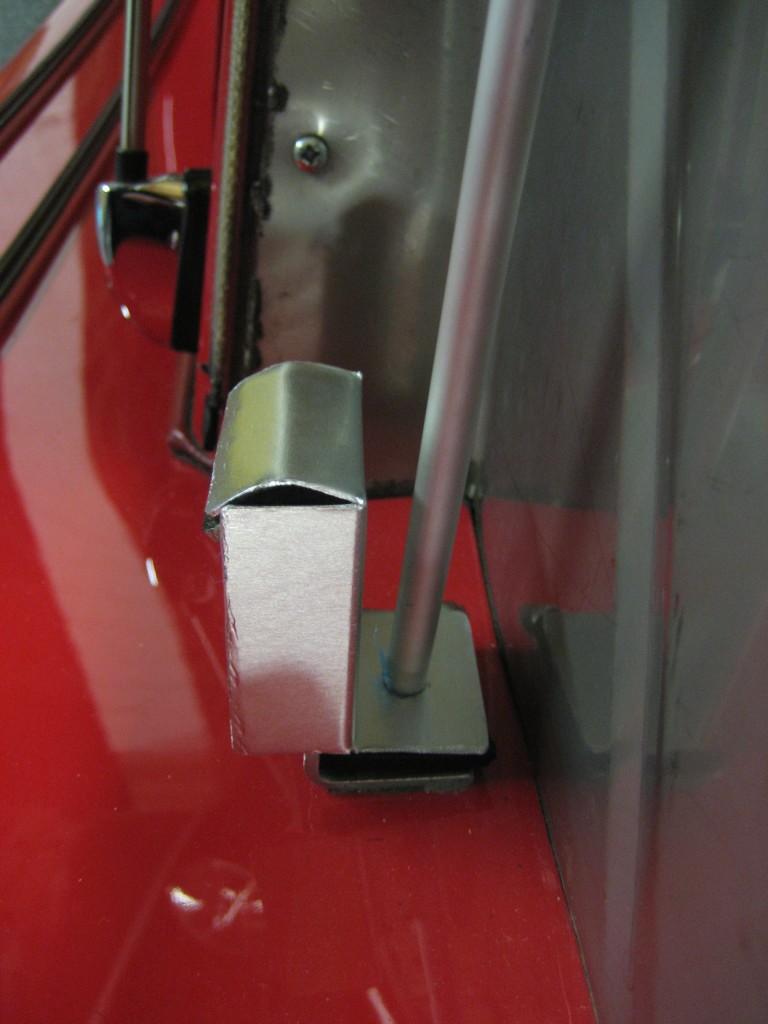

The brackets locate to the tubes with 6mm allen headed setscrews which are araldited in place. Here is the lower bracket over the top of the bonnet bracket. It's a good firm fit. The bracket is lined with 3mm neoprene, although it's not strictly necessary.
To get the right height it was necessary to take 8cm off each tube and bend slightly as is visible in the next picture. If the stays are too long the bonnets will touch.

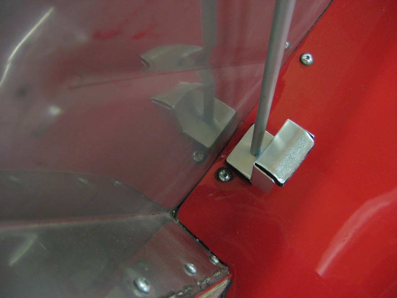

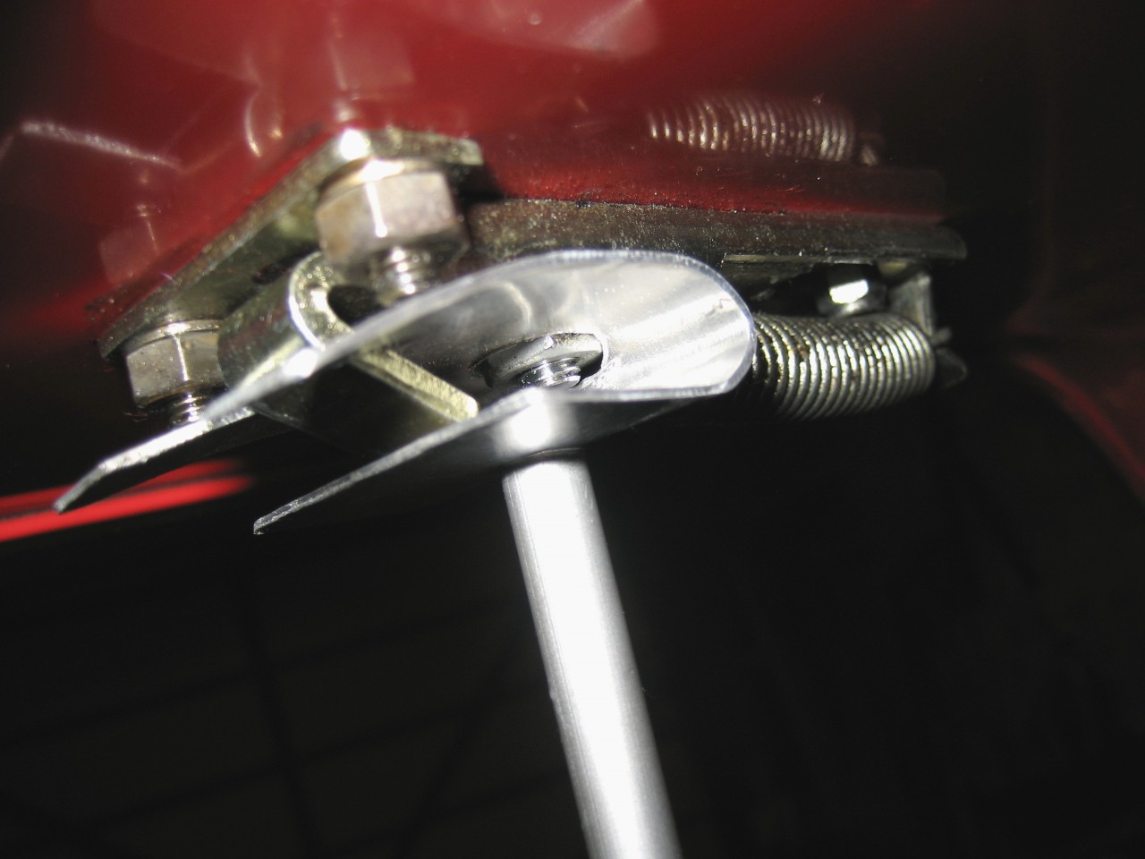

This shows how the fork locates around the bonnet fastener.
And this shows how the larger hole clips over the nut for a good grip. I've filled the slot with neoprene now, but you wouldn't see the fitting had I done this before these photos.

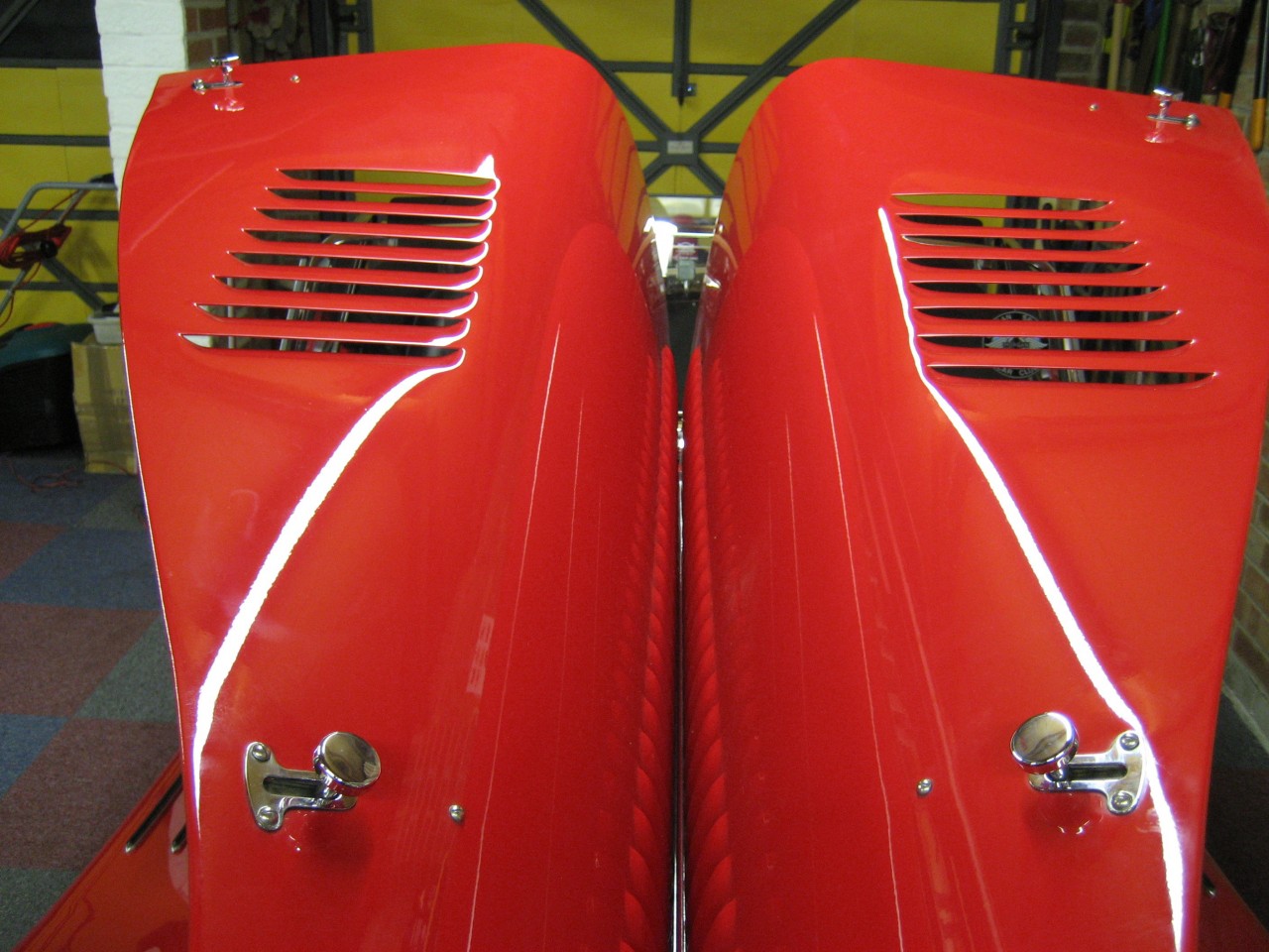

Finally this shows that the bonnets are just right. There's about a quarter inch between them.
