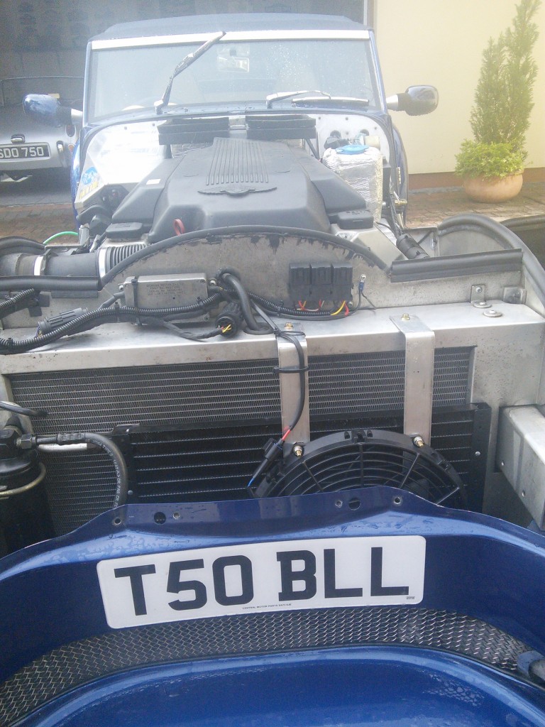

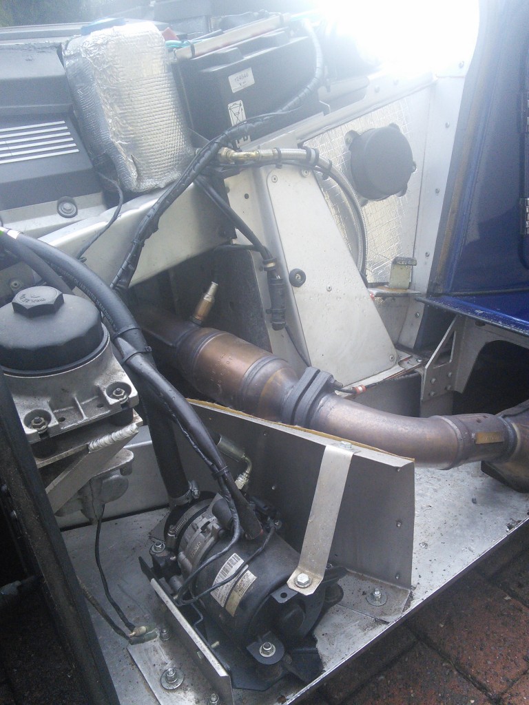

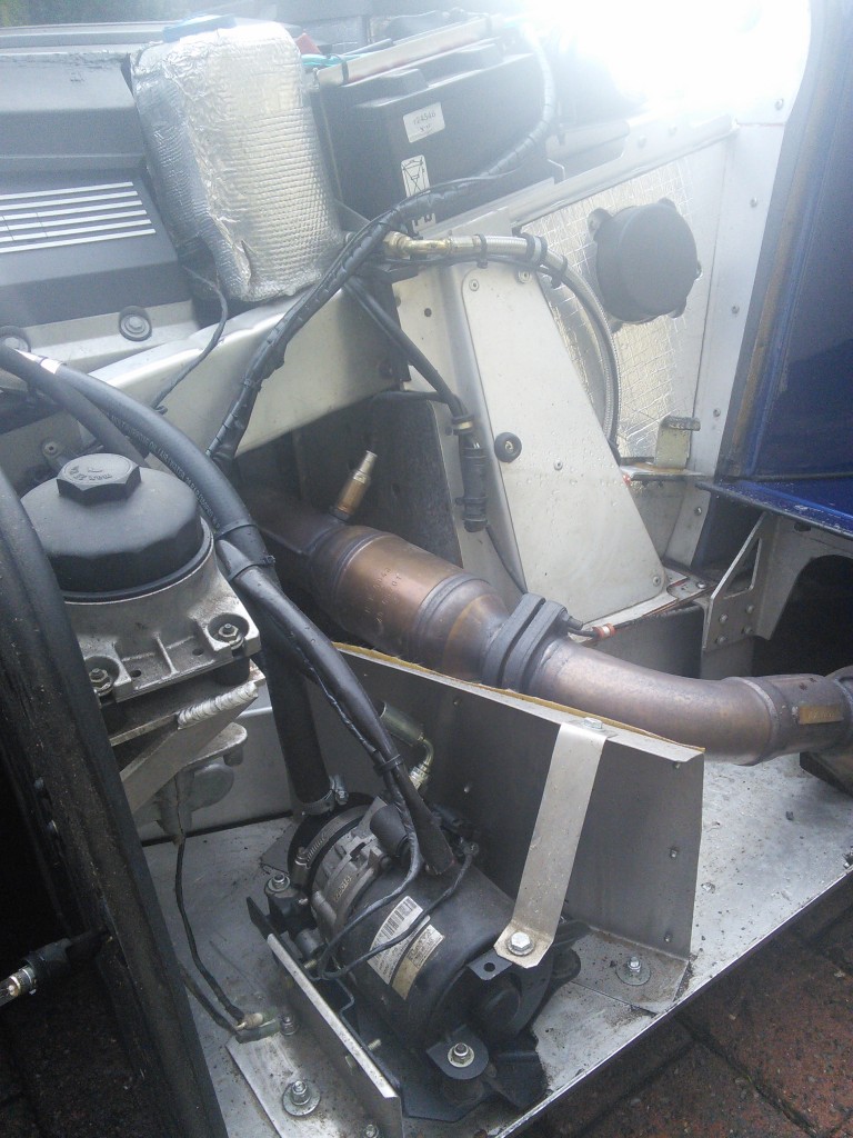

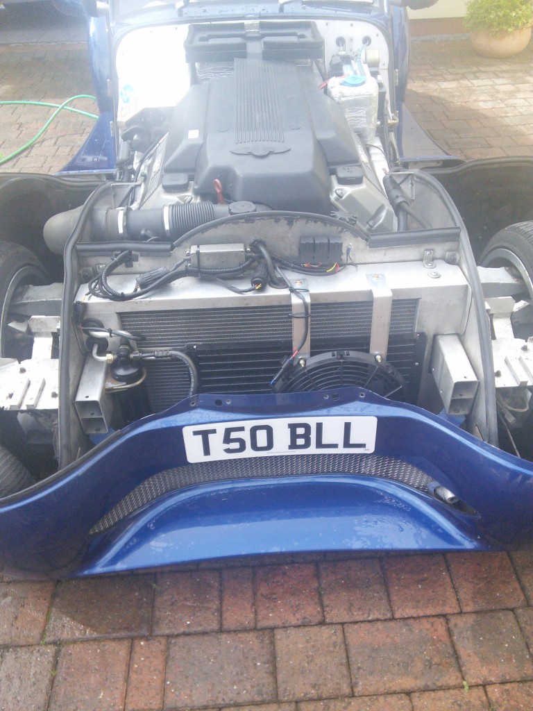

- these are the images that t50 (Bill) sent me re. his Air Con. fix.
I'll let him answer any queries (hopefully !), but this is the info. he sent me along with the photos -
'These are the pictures of the front of the car showing the new condenser, drier, fan and wiring to the new relays.
The aircon works now as was.
The compressor was the first failure on a trip to Spain.
The other pictures are of the fitting of electric power steering pump.....'
/img]
thanks for the info. Bill thumbs

Many thanks for your great images, all useful when things go wrong.

That looks like a very neat installation.
Aero 8 GTN #11
Interesting photos - thanks for sharing.
