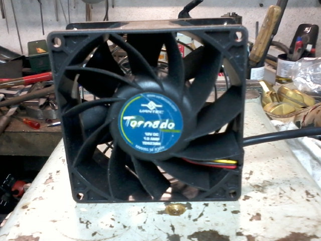

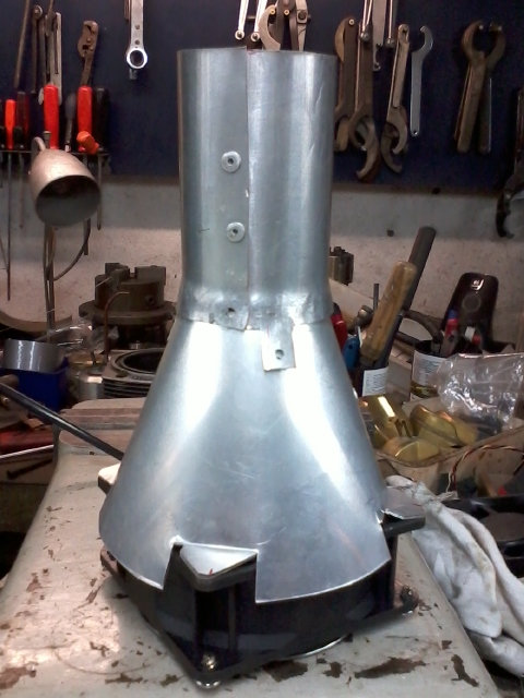

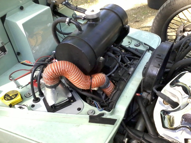

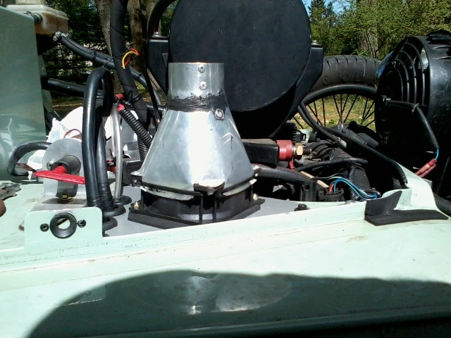

Test cooling centa casing
test with fan 92 mm 12 watts, later test 92 mm 26 watts.

That's really interesting research you are doing there GLLOQ
Have you been able to measure the temperatures going on with the centa?
PaulR
Joined: Nov 2013
Posts: 756
Likes: 9
Joined: Nov 2013
Posts: 756
Likes: 9

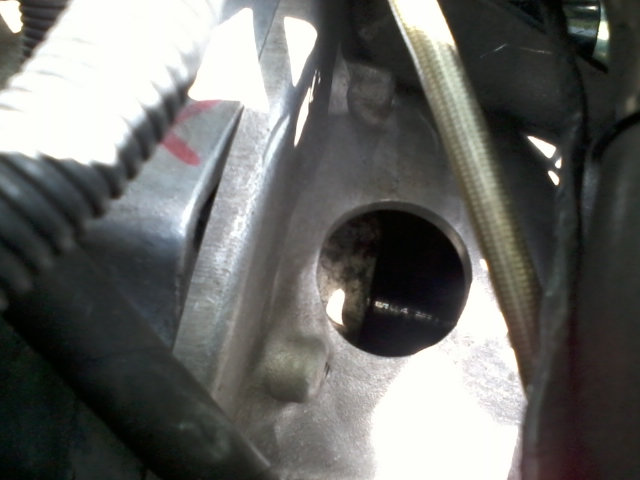

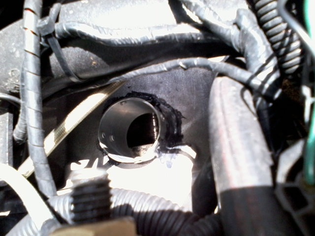

I made a hole in the crankcase at the last replacement of rubber barrels (October 2015) to provide a ventilation of the crankcase in hot weather, it will perhaps improve the problem of lifetime of rubber, it may extend the duration of life of the rubber, no temperature measurements before and after the assembly of the fan except
put your hand on the centa casing which seems to me less warm by putting your hand on the casing after one hour of traffic in slow motion.
