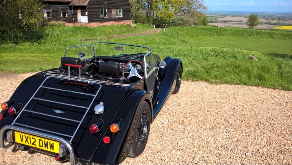

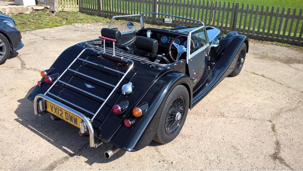

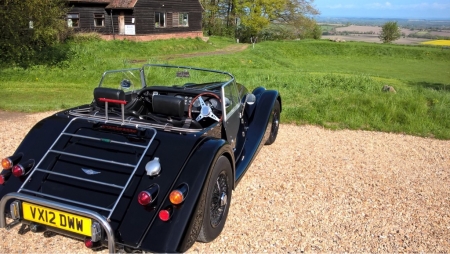

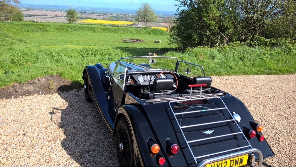

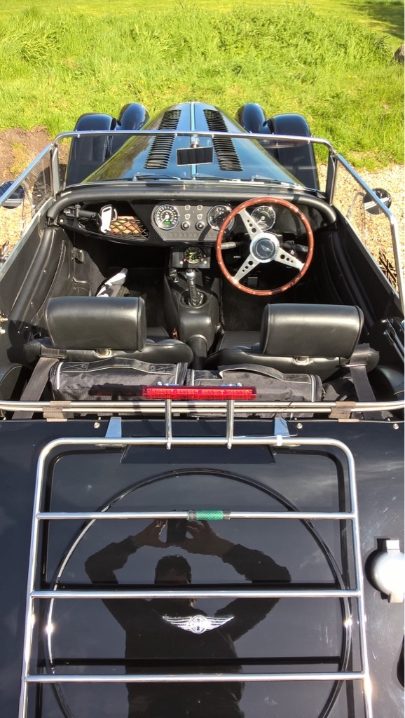

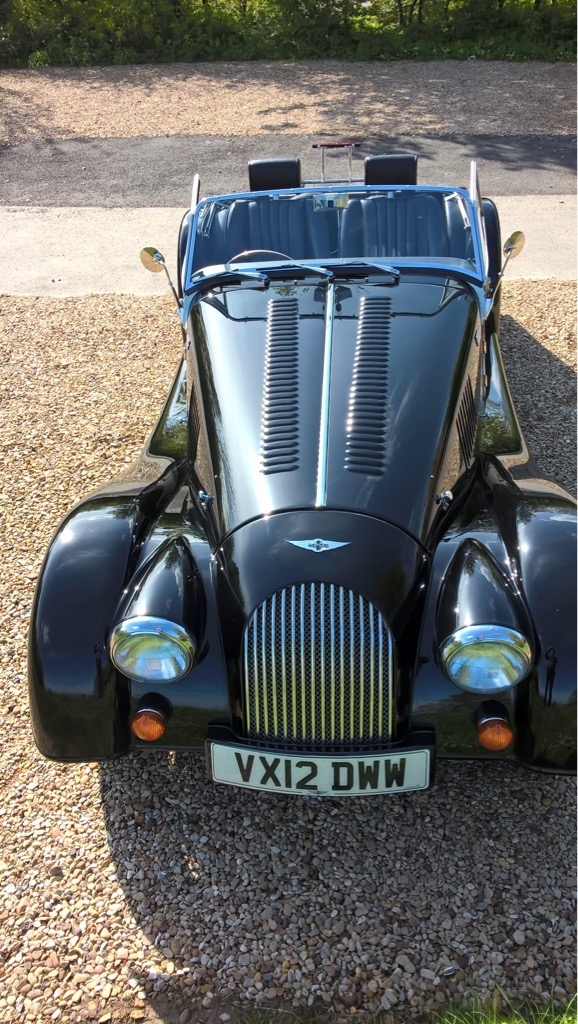

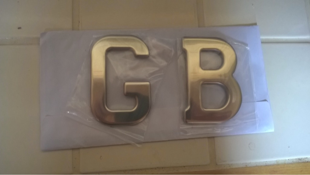

I have been working out how to fit a high level brake light so that I can take some luggage on tour, almost ready now bar some finishing touches, (tidy up the wiring and hide the bolt heads with neoprene!). Also the car needs a good polish and the tyres need blacking. Oh, and some GB letters, which arrived after I got back

Car is looking good smile

That looks really good. Can you post some more close up pictures &how you did it please.

Here's the light
https://www.carbuildersolutions.com/uk/28-led-high-level-brake-light-235mm
Here's the connectors, female is 0-012-52
https://www.autoelectrical.parts/product/0-012-42-econoseal-connector-male-2-way-qty-1/
Here's the brackets
https://www.ebay.co.uk/itm/Chrome-Munsen-Ring-Backplate-Steel-Rod-Extension-Plastic-Chrome-TUBE/232737294230?var=532252273325&hash=item3630394796:m:mjsCvBX5Cf0IU4dAoHpHiVg
Here's the solder connectors
https://www.amazon.co.uk/Eventronic-Elec...+wire&psc=1
On the 4/4 sport model, the light connectors are down in the bowels, unreachable from the cabin area, so I had to cut the wires about 6 inches from the light, and used a bit of the wire that came with the new lamp, and the solder connectors, to extend the wire back to the side of the cockpit. That left enough wire in the feed side to go into the cockpit , where I fitted the feed connector, and now I can plug in whichever brake light I need. Any other info needed? Of course to do this you need to remove the rack, rear finishing plate, parcel shelf, and then the large plastic storage tray

Looks the business Stuart
Very neat solution
Nice solution.

Is it mounted to the rear carrier does it not vibrate?
