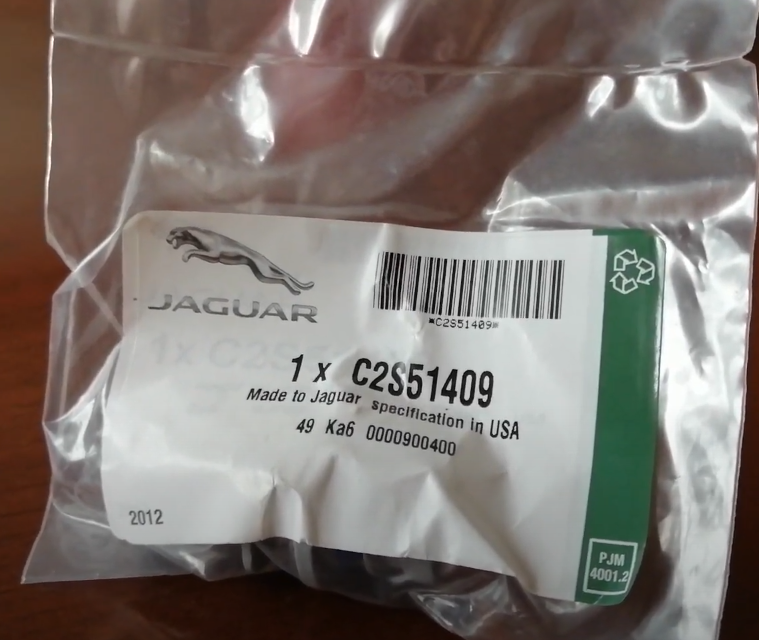

I'm just trying to cross things off the list for what might he causing my engine to ever so slightly hunt on idling. It isn't much, and no where near to the point of stalling, but I don't like it. I've had a look at the maf, and that looks nice and clean. Ive cleaned out the iac as that had a dusting of carbon on it. I'm gonna look at the plugs next and while the manifold is off/lifted replace the Pcv valve, as I've read that they should be changed every 2 years or do. The outer foam part of the hose at the valve end looks a bit worn, and they was a small pool of oily crud at the manifold end. Any advice on where to source a new pipe and valve from as Google has failed me so far?

Searching E Bay for ST220 parts sometimes brings things up.
According to You Tube, this is the part......

I would suggest a Ford dealer as the cheap ones on Ebay hose wise aren't good. I have a hose and IACV I bought trying to track down an engine lean warning light. Pm me if interested.

That would make sense Dave, as I'm sure some jag x types have ford v6 engines. Will search on that, thanks.

The iac seems fine, but if the hose is for the PCV valve then it take that off your hands. I'll pm you if it is.

Yes it is . Pcv to manifold
