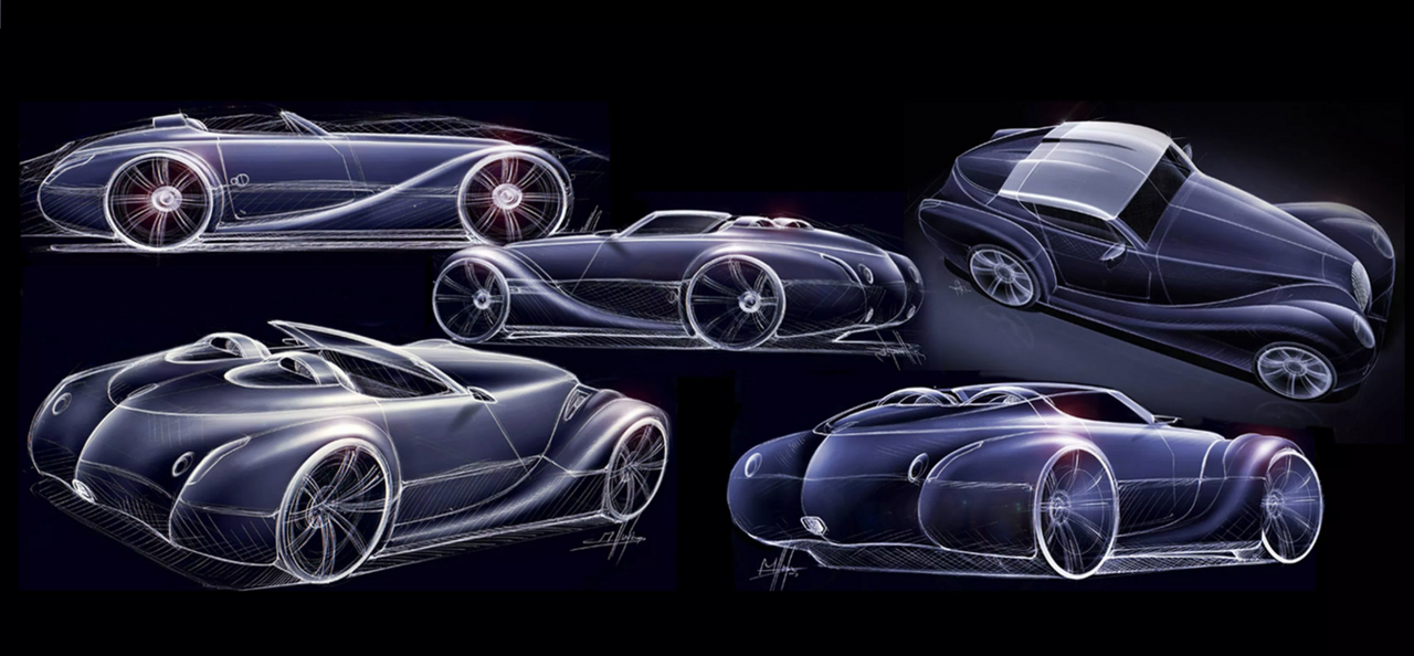

That's interesting... on the last page of the brochure is this sketch... which does look quite a lot like an early drawing of an S5...
Will
Formerly Aero S5 #80

I am sure that when the S5 was released there was a comment from MMC saying the always wanted the Aero to look like the S5. Although that could just be sales talk.
