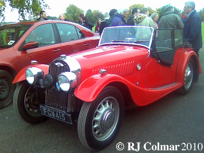

Joined: Nov 2010
Posts: 39
Joined: Nov 2010
Posts: 39
http://img151.imageshack.us/img151/889/03image1450sc.jpg
Thanks for the further tips, FGW 415 pictured above in the Morgan factory car park definitely has a N/S exhaust so is possibly Climax powered.
Hope Dave Sapp's patience with his block pays off :-)
