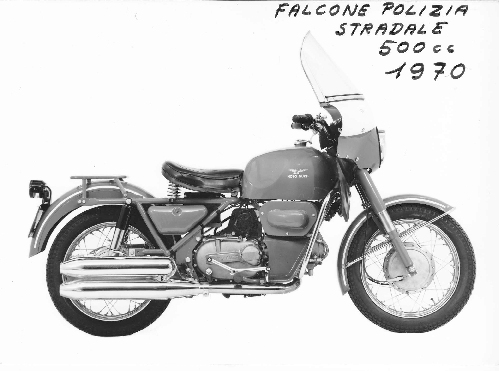

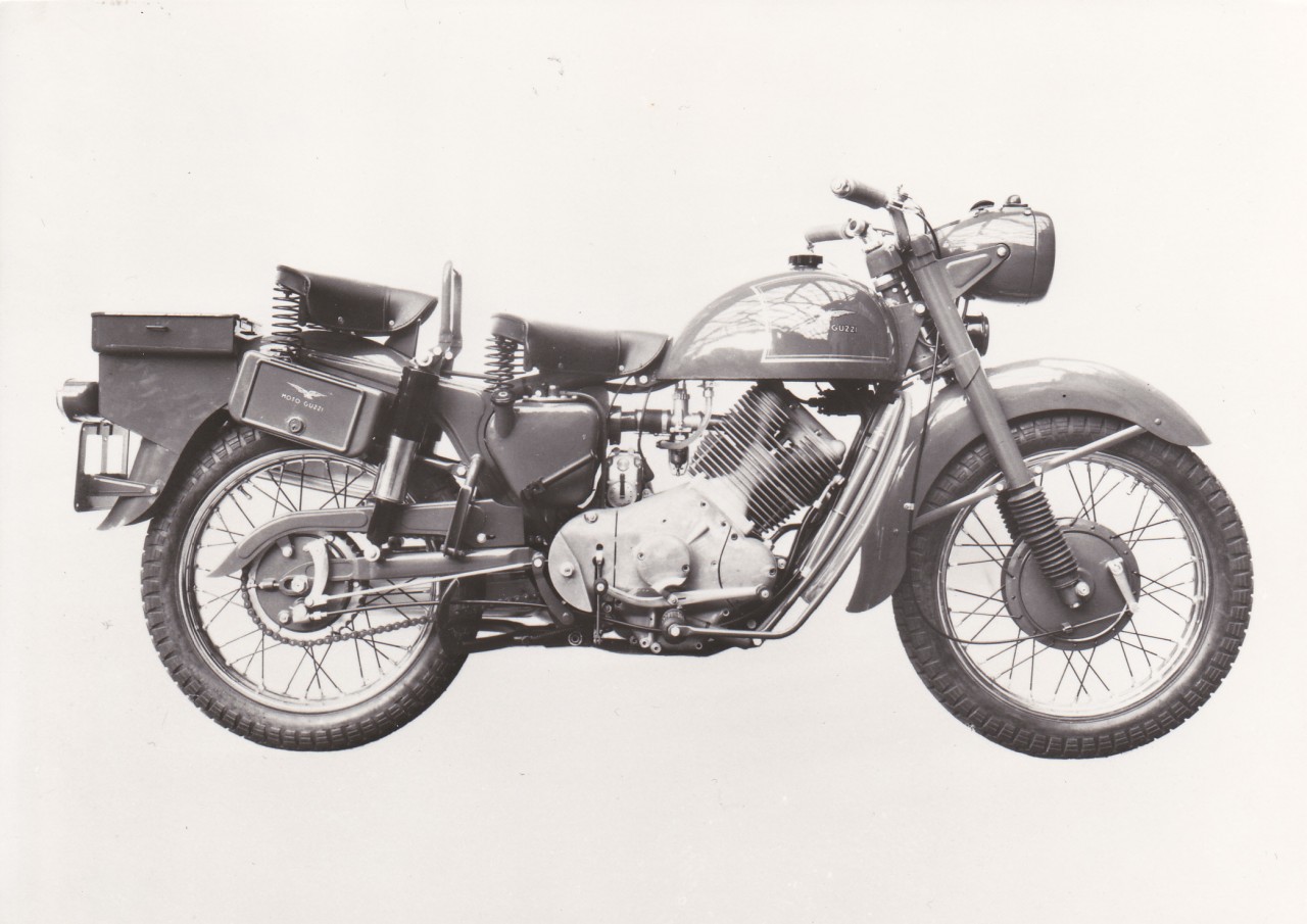

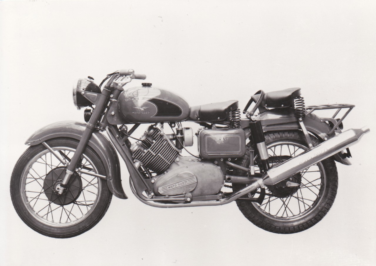

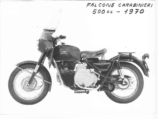

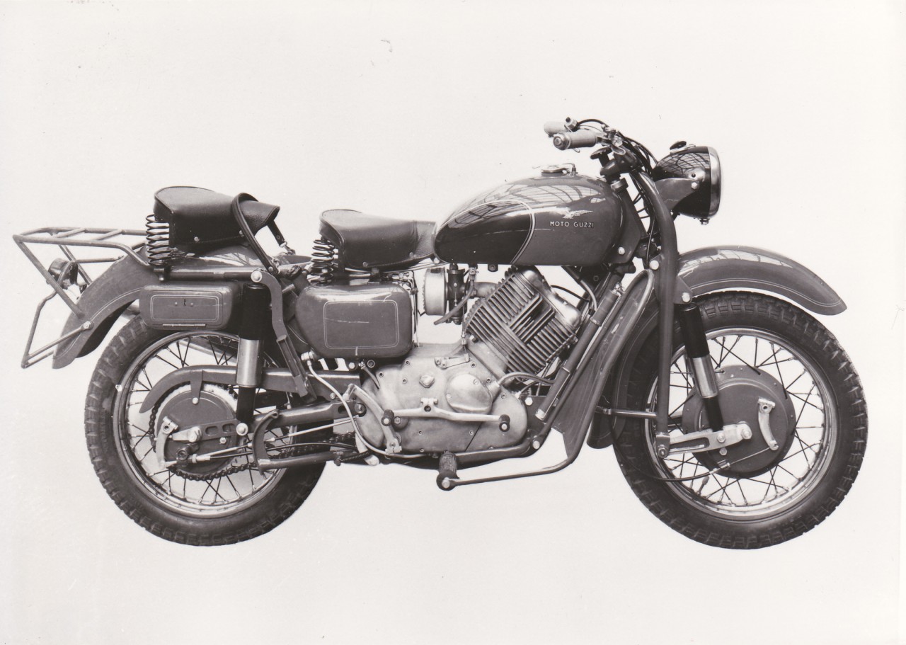

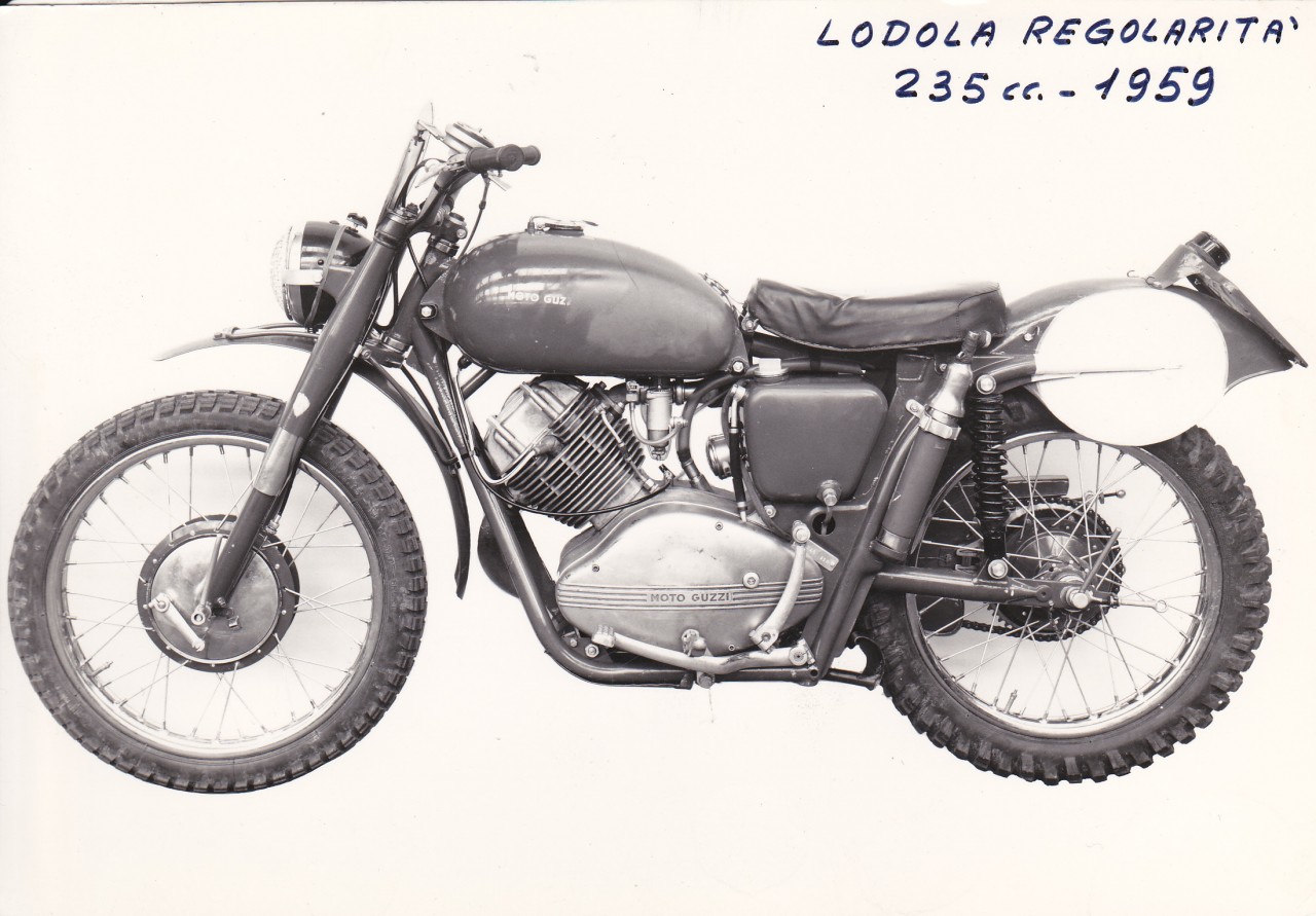

From the Agostini archives; a set of archive photos from the factory that was given to the dealership.
It is most likely a 350 Militare IV° tipo 1959 (4th type). It may also be a slightly later type but the IV° tipo is the latest photo that we have. It may be a factory prototype because I can't find any reference to it being in production in any of the books we have. I did find a photo of an early prototype in one of the books but it does not mention them going into production. I am still investigating at the factory.
Quite a bit of unusual stuff was sold in factory cleanups but it may also be part of a small run of test bikes that went to the Army.
Below are a series of photos that will give you an idea of the evolution of the bike.
350 Militare II° tipo 1957
350 Militare III° tipo 1957
Below is a photo of a Lodola Regolarita 235cc 1959 for comparison
Ultimately the military took the V7 Militare from 1967 and the Nuovo Falcone 500cc from 1970.
