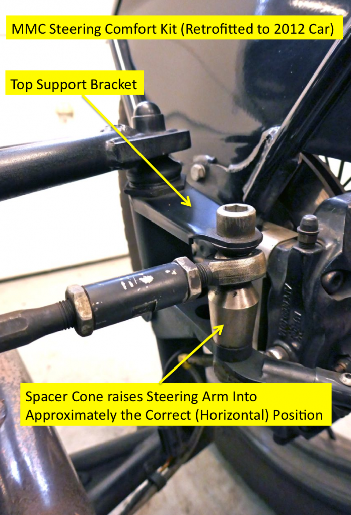

Looks like the it's either the MMC comfort kit fitted to the steering arms without the top brackets or it's a one off/home made similar arrangement. If it's the latter and turns out to cause any problem then it could be swapped for the full MMC arrangement. It doesn't have the Empire kit wishbones.

4. The track arm riser adaptors look like the ones used with the original Empire Kit, not the MMC type. It does not have the Empire steering correction kit fitted, just the steering arm ends. There were some issues with these if not fitted correctly, safer to have the MMC version fitted.

4: Agreed. Looks to be a "home made" comfort kit on the steering. This is not meant as an insult! Someone in California actually came up with a design very similar to what the factory subsequently did with the comfort kit and it could be from that source. The main difference, visually at least, was that while they both used similar tapered risers on top of the steering arms to raise the track rods up to something like parallel to the top wishbones, the factory kit also has a reinforcing bracket from the top of the suspension upright to the top of the riser while the Californian version didn't.
