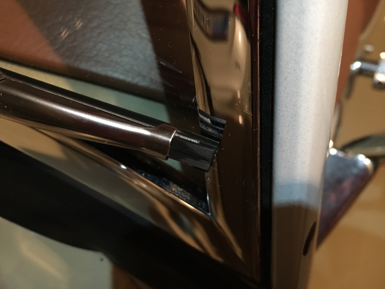

The wiper blades WBS8 fit pretty well
I recorded a video in slow motion with the unmodified wiper blades.
Video
The wiper blades have slightly different paths on the way there and back (about 3-5 mm). On the way back they touch the upper edge of the windshield (visible in the video). But only the rubber touches the metal frame.
At the very end of the video you can also see that the right wiper, seen from the front, touches the metal frame on the right a bit more.
To reduce this I made the same modification as CooperMan. But the result is a stronger touch at the metal frame below. I have now mounted the wiper blades unmodified and will try to shorten the right wiper blade a bit. Then it should fit.
The wiping behaviour is significantly better than with the original wiper blades (no rattling at all).
I'm curious about the first test in the rain. gloomy
From my point of view this is a very recommendable (and not very expensive) modification.

Michael, if you slide the rubbers out you can cut down the overhang of the thin metal slips as your close up shows & them trim the rubber too
Mine were tested in very heavy rain for several hours of continuous driving & worked very well
Jon, this is exactly what I had planned and have done in the meantime. Here is a video of the 4-7 mm shortened wiper blades:
