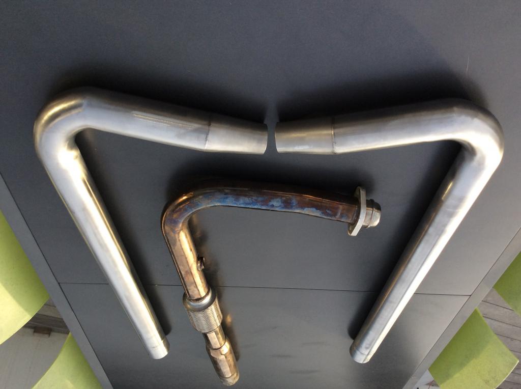

Just had a reply from S&S about exhaust set up.
Email as follows.
Hi, John.
There is no simple answer to your question. When tuning exhaust length, all one can really do is optimize the power over a relatively narrow RPM range. At all other RPMs, the tuned length becomes irrelevant. That being the case, here is an equation to help you determine optimal header length.
L= 950 x 233/RPM
L=Length
RPM=RPM in the middle of the desired power band
The engine wants, at a minimum, around 3000 RPM with a good cruising range being 3000-3800 RPM, so if we select 3400 RPM, we are looking at an optimal header length of 62.3"
The Morgan header pipe is 1 3/4" diameter so you can fit just about any Harley muffler to the header that you desire as long as you can rig up a bracket to mount them.
Let me know if you have any other questions.

From S&S.
PS.
Two points I should have clarified. The math would include the length of the muffler as well. It is an end-to-end measurement of the entire exhaust system. Also, unless the engine has been replaced, the Morgan should have a 121" engine in it.

[quote=The Morgan header pipe is 1 3/4" diameter so you can fit just about any Harley muffler to the header [/quote]
John,
My 2012 machine has 2" OD pipe coming out of the head (after the 1.875" reduce section right at the port), and was 2 1/2" OD after the cat, before I removed it, so is now 2".
Based on most of the exhaust calculators one finds online, 1 3/4" or 1 7/8" would make more sense for this engine.
BTW-when I had the exhaust off for fab/updates, I measured the actual port diameter of the head at right about 1.375".

I was thinking about that as well. 2" makes it slightly more difficult in terms of a straight swap out as well.
