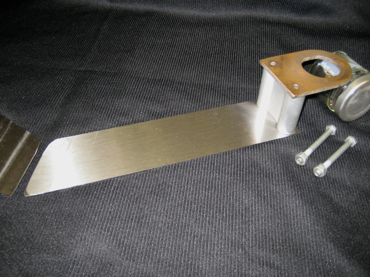

I've just got round to cleaning up the damper blades which I removed over winter to fit steering bearings. I thought it might help the understanding of those who don't DIY to post some pictures.
First the nearside as fitted - looking forward.

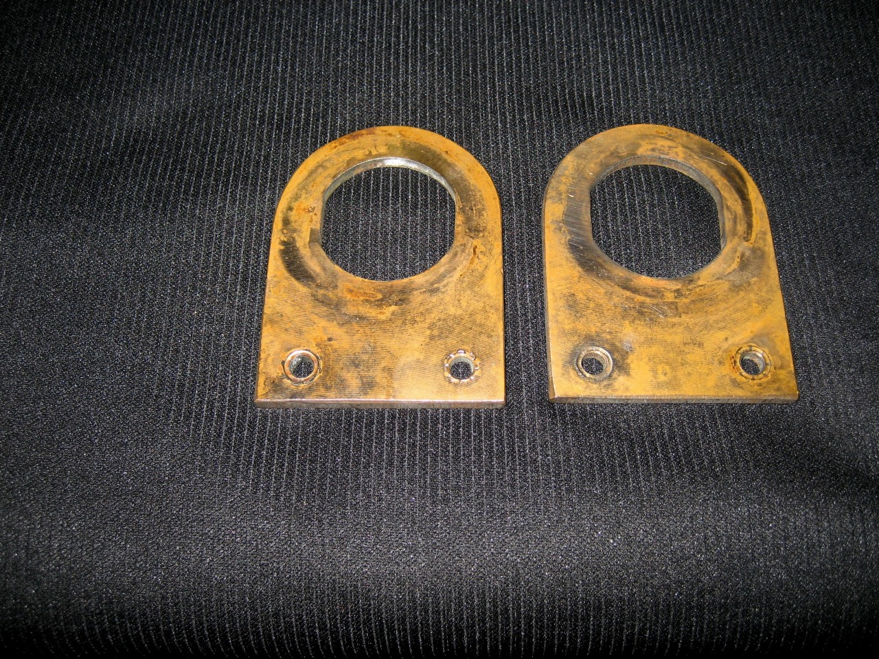

Right to left (ignoring the jar!) first is the thrust collar which is "bronze"...ish. Then comes the alloy drop link - these are very nicely made and clean up to look like new.
Finally is the blade itself. This is spring steel, and since there is little corrosion may even be stainless. The inner end is roughly finished and there are two distinct wear marks where it locates inside the sandwich plate on the chassis.
Now the offside, with much less wear evident. The bolts are 7/16"AF - UNF thread with a shank length of 2.5".
This is the top side of the collars where the bottom of the spring sits.

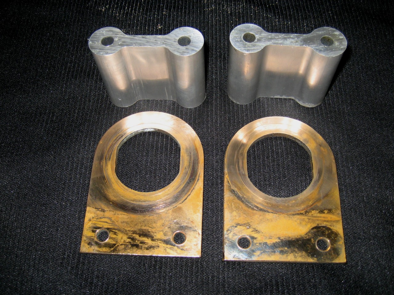

This is the underside. You can see the witness marks where the drop spacers were located. The stub axle assembly tube fits through the hole, and rotates against the collar. The rotational wear is very clear.

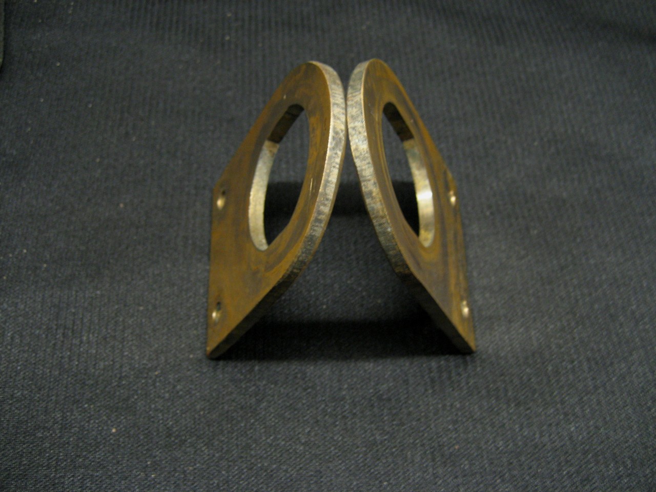

And this shot shows the thickness of the collars. They are substantial.
Finally, a close up of the wear......

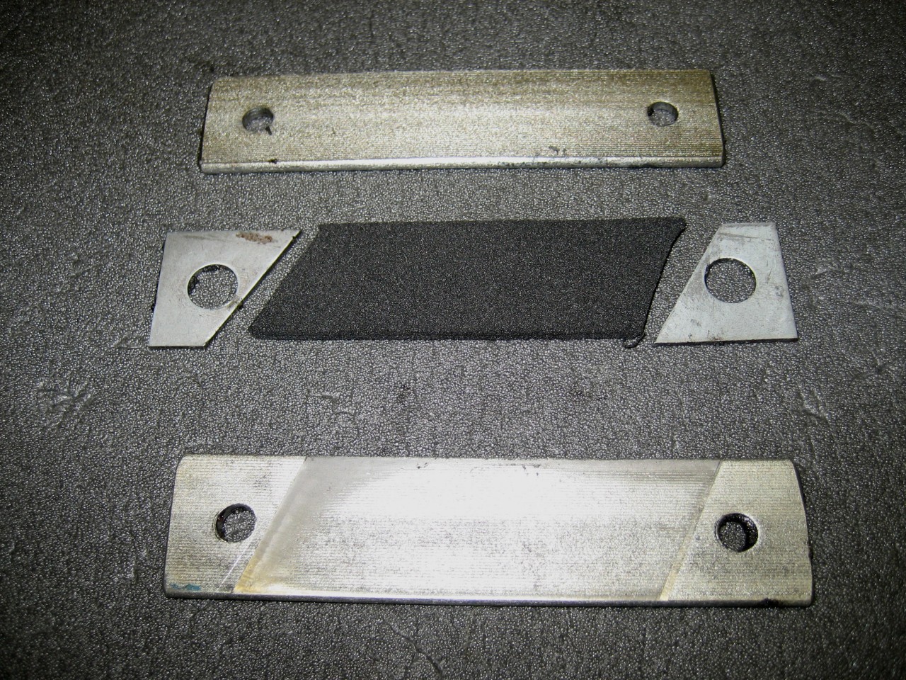

The ends of the blades locate on the chassis and are held by two rectangular plates.........which allow the blade to slide in and out to accommodate suspension movement.
Ignore the piece of neoprene, that's what I used to seal the slot on the car when I removed the blades. Note that the two odd shaped washers have an enlarged hole. This allows them to be adjusted tight up against the blade, and you should periodically do this adjustment if your Morgan has damper blades. Replacing the blades with new is simply a matter of removing the two bolts through the alloy spacer, then slackening the adjusting nuts on the chassis brackets. The blade will then pull out. Fit the new blade, tighten the spacer bolts first, then the adjuster nuts. It is much easier with the weight of the car on the wheels. Beware that on older cars, there is a distinct possibility that the bolts may have corroded inside the alloy spacers, so you may need new bolts and spacers, and may have a degree of trouble removing the old ones. This is nothing that a competent DIYer can't handle!
2017 Note: The aluminium drop brackets were apparently introduced to provide clearance for the calipers. Drum braked Morgans would not have had these brackets. I'm also told that the current Caparo calipers don't retro-fit where steering damper blades are fitted.
