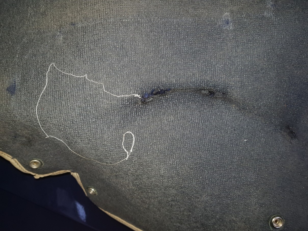

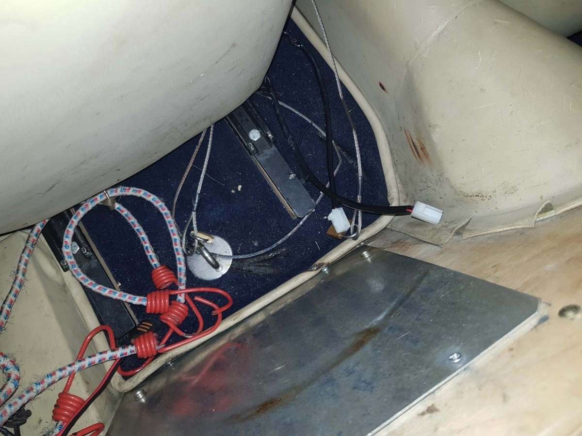

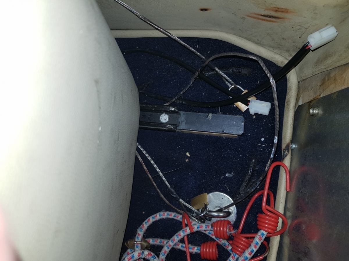

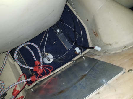

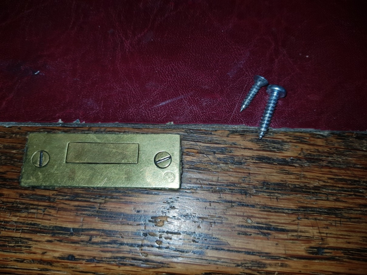

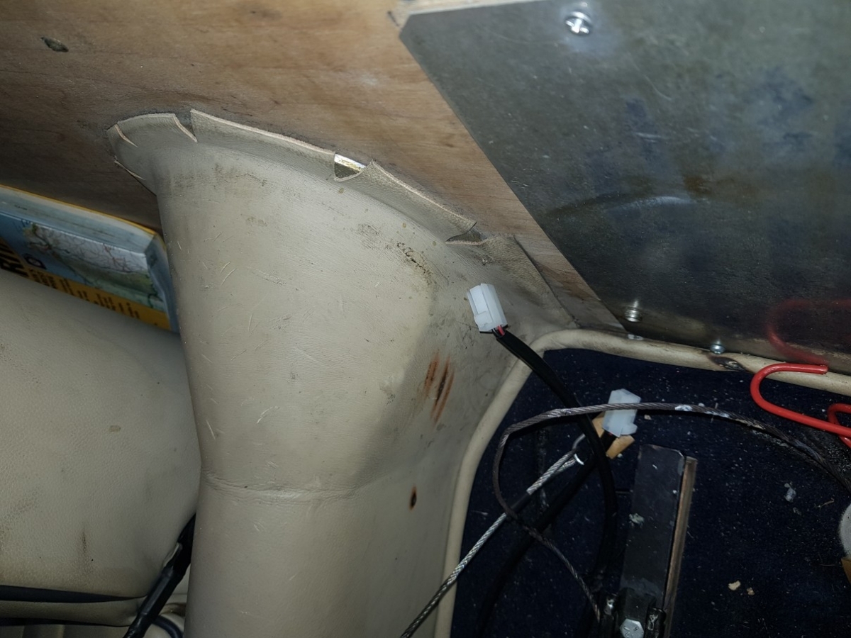

I had an electrical fire today because someone had fitted a screw to hold the battery access panel that was over long & went through the main power lead before the 80 amp fuse.
Unfortunately we have fitted a wire cable to secure luggage. That wire touched the live plate and earthed it.

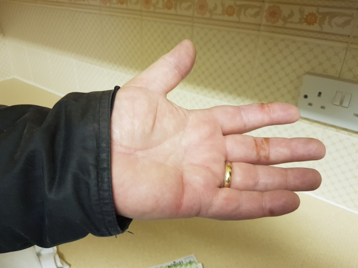

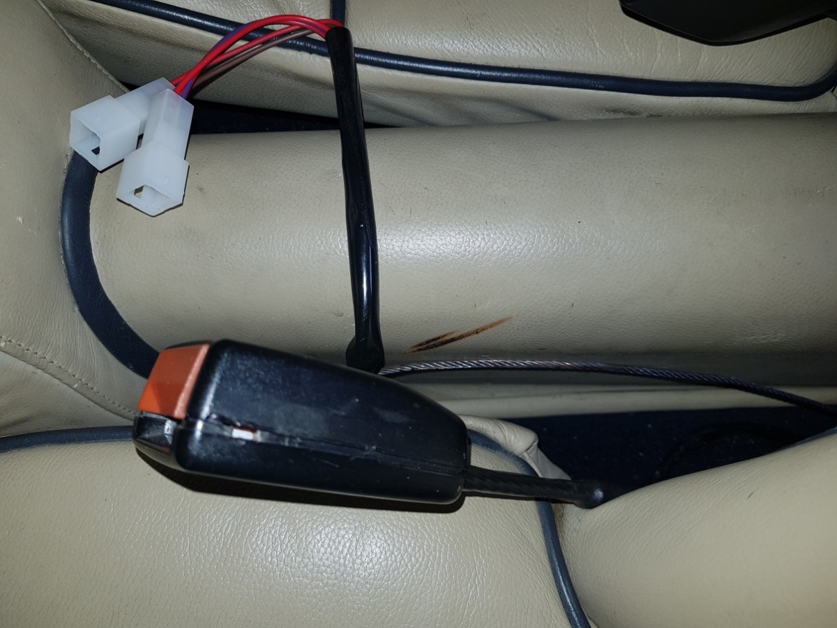

Being inside a Mog with the hood up full of smoke wasn't fun and I burnt my hand moving the wire cable. The car now has burn marks on the leather & the carpets and the heated seat wires are damaged with melted insulation.
This year really has been a bad one for Morgan ownership. I had only just collected the car & now it will be back at the dealer on Saturday.
We all keep stuff behind the seats so please check your screws are not long enough to pass through the wood & cut into the cable. The power was such that the current passed through the rear valance carpet & melted that on the inside.
