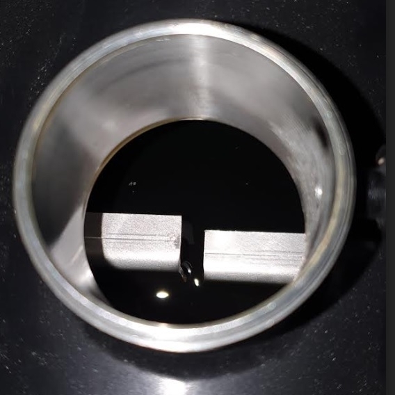

Oil level
just for illustration purposes

Can someone please explain what this is a photo of?! confused2

I think the explanatory thread is in the M3W section .... not a 3 wheeler myself but I think it's the oil level check in the M3W oil tank ..... relates to a query from an owner.

Yup, that is indeed it. smile

So... is this a 'good' oil level or a bad one!...

I would add oil to cover the lower indicator

Yes get it between the marks and not over the top mark. The engine is a dry sump one so you should run the engine first to ensure all the oil is scavenged back to the tank.
