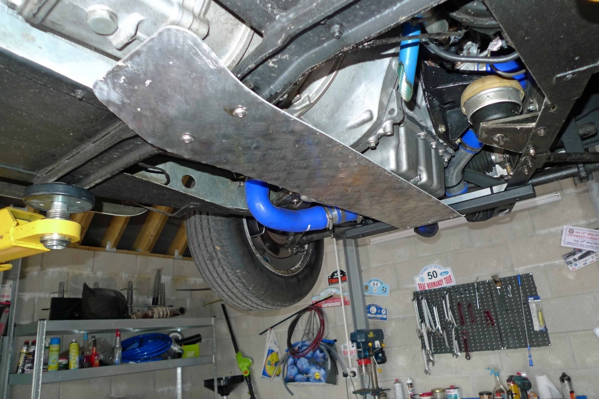

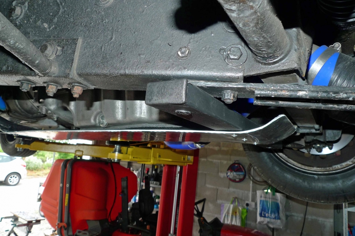

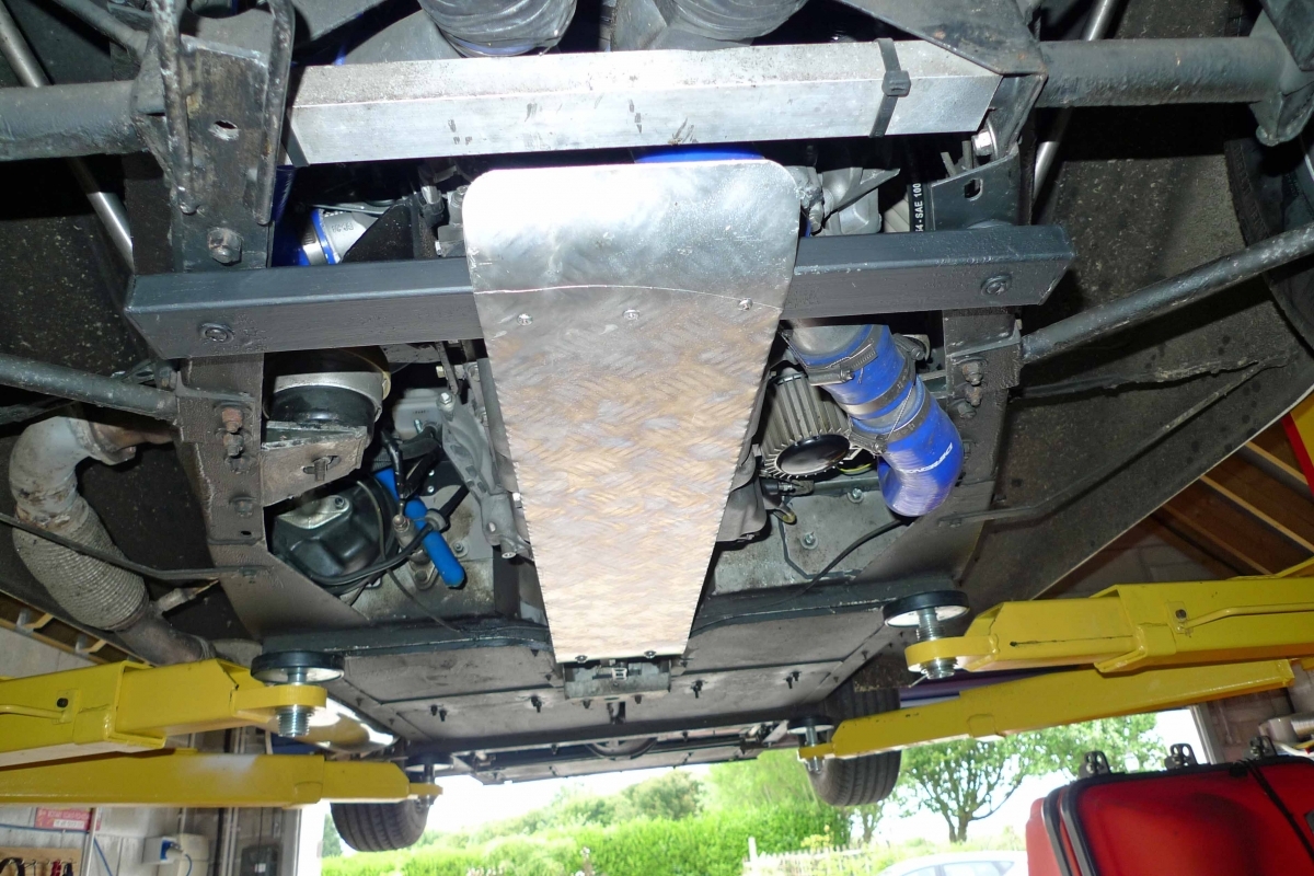

This was a lockdown project. Decided to fabricate a lightweight skid which would protect both the sump and centre crossmember from high points.speed bumps etc. Pretty easy job, required some 5mm alloy or dural plate and some mild steel 50x25mm tubing (with plastic end blanking pieces). This bolts accross the front of the chassis (which also stiffens it a bit).

Nice job griffo.

Bloody hell griffo you should be able to go skiing with that one.....nice job well done
