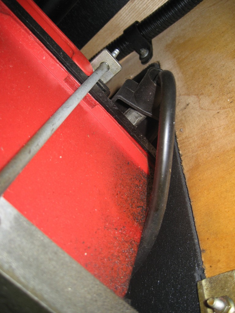

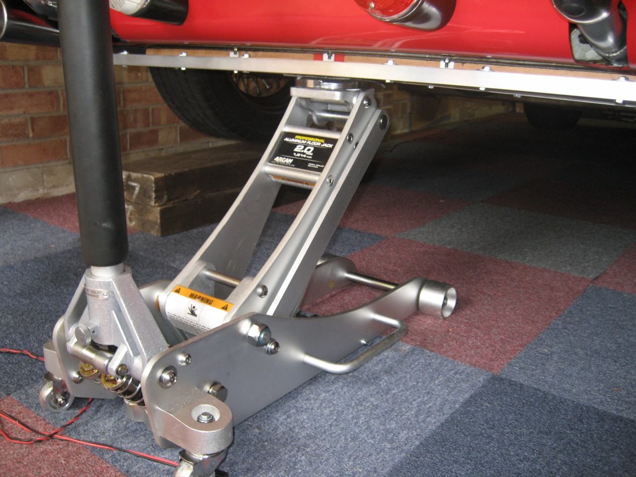

If your battery is in the back, you need to check the cables, to make sure there is no chafing. I did mine this morning. First pic is the new jack and lifting board. Note the sleepers under the rear wheels.

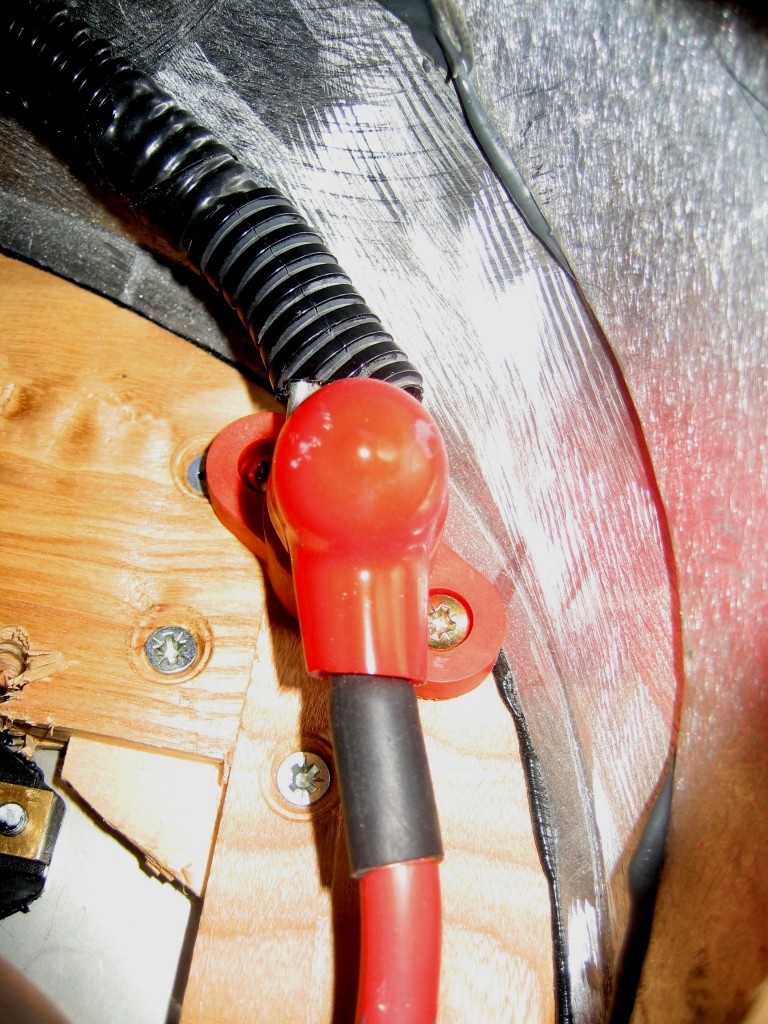

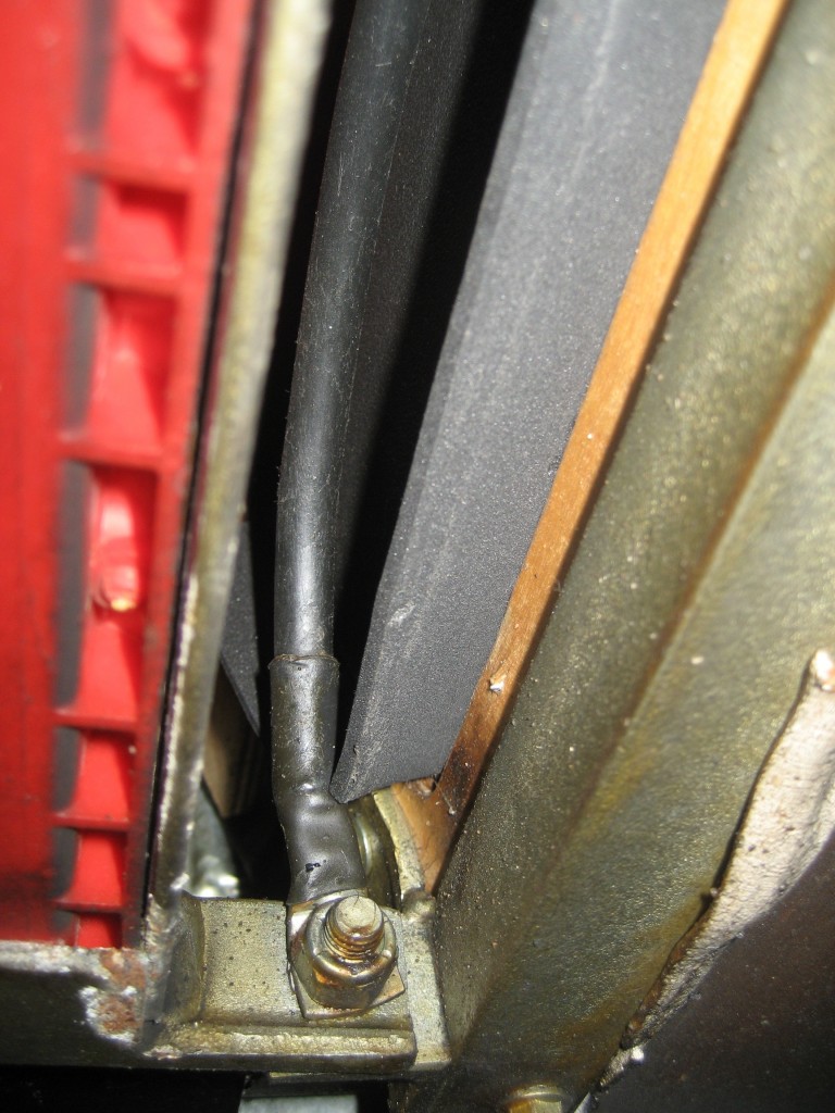

This is the right side looking forward and shows the earth cable connection to the battery.
The cable curves under the carrier and locates on the left side lower bracket. It doesn't matter really if this cable chafes, because it's to earth anyway.
I've included this one to show how hard it is to see anything from below. Obviously you can take the tool tray out and remove the alloy flap behind the nearside seat to see more.

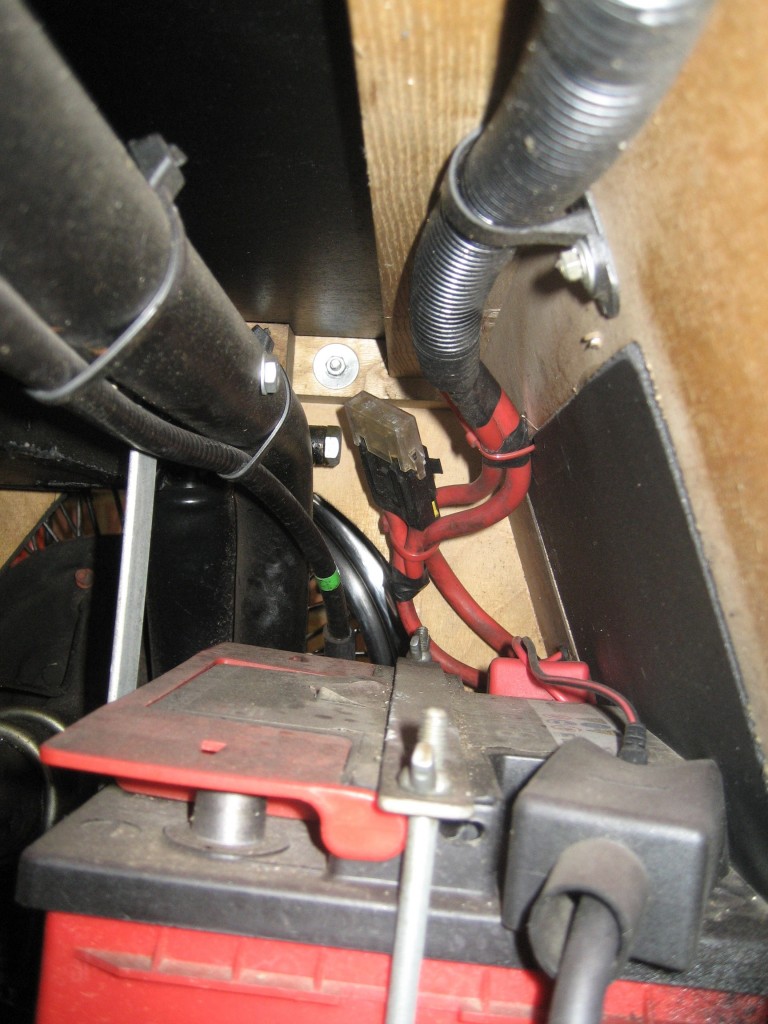

You can see here that there are two red live cables. You can also see what I think is a master fuse, I've not yet had this apart for a look. Any short downstream of the master fuse will blow the fuse, so it's only a risk on the short length of wire between battery and fuse.

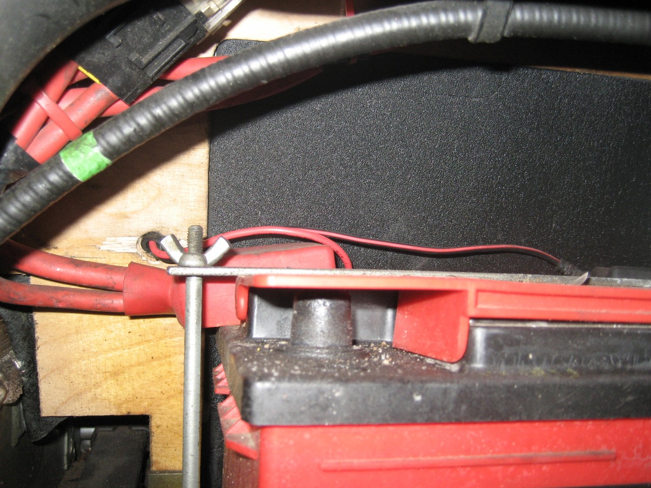

The thin wires are the adaptor for the battery conditioner, which pass through the wooden bulkhead in a grommeted hole just to the left of the wingnut. The big red cables are tied out of the way with a red cable tie, and I suspect that I did this when I fitted the neoprene liner to the ally cover plate.

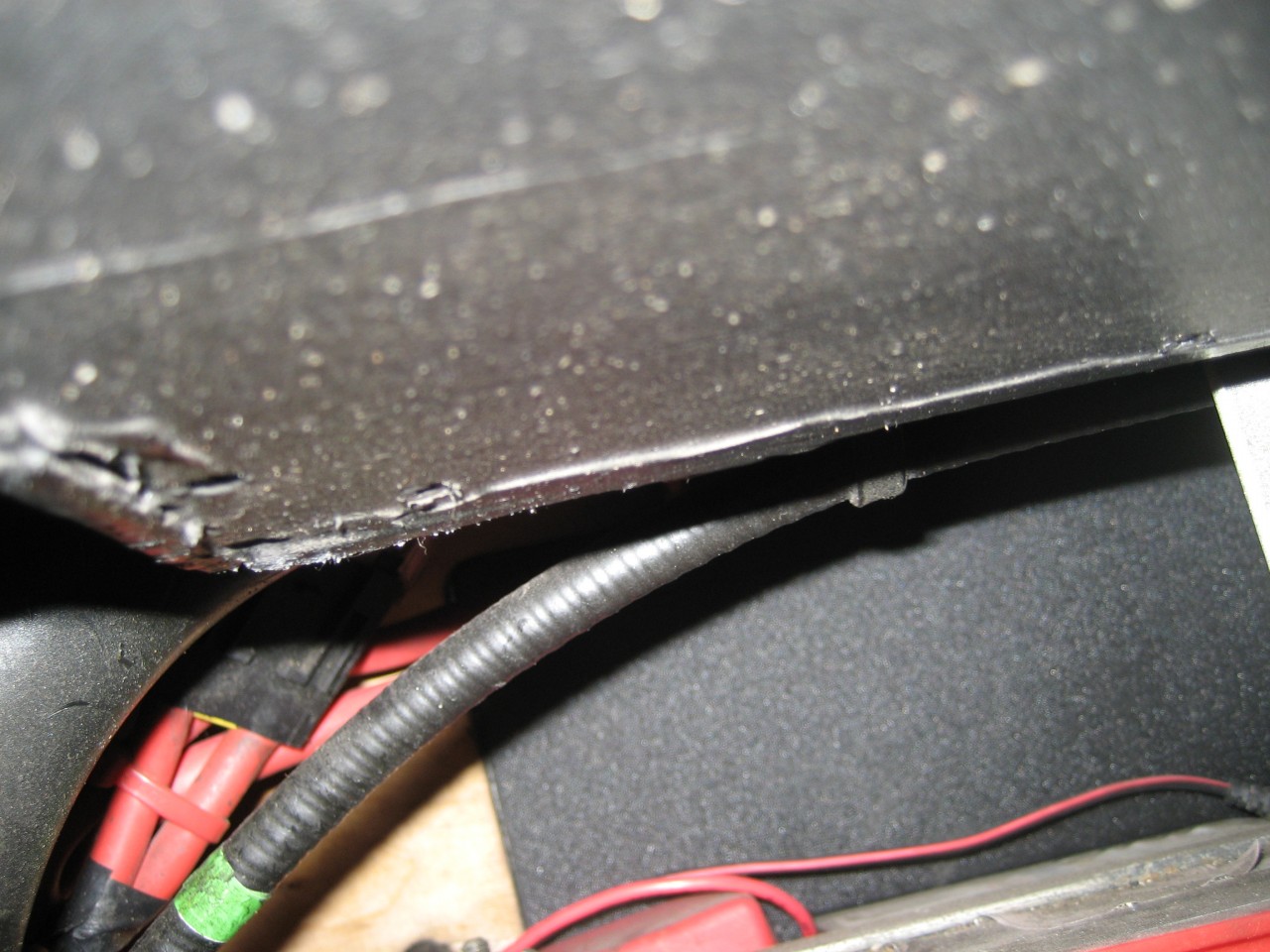

You can see here the relationship between all the fittings. Note that the battery has twin terminals - two positive and two earth, so that it can fit multiple applications. Note also that the live cables cross over the car in the black wrapped cable high up. This is not the cable visible in the previous two shots, that's the handbrake cable.

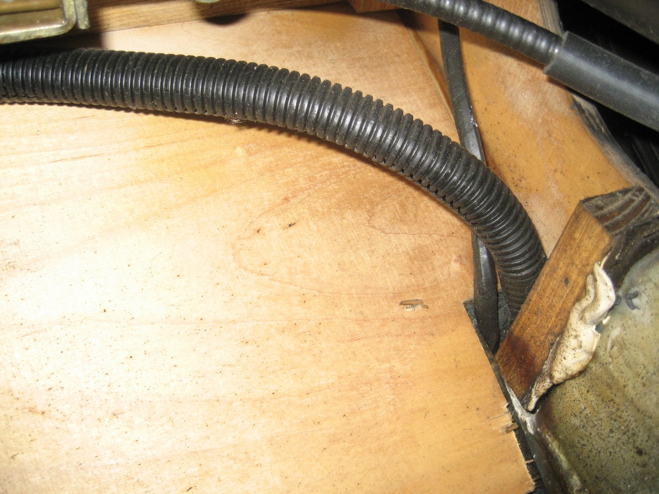

This is where it sneaks inside the car. Handbrake cable at the top, live cables below. This is adjacent to the offside leaf spring front mounting. The cable then runs inside the cockpit under the offside trim panel.
