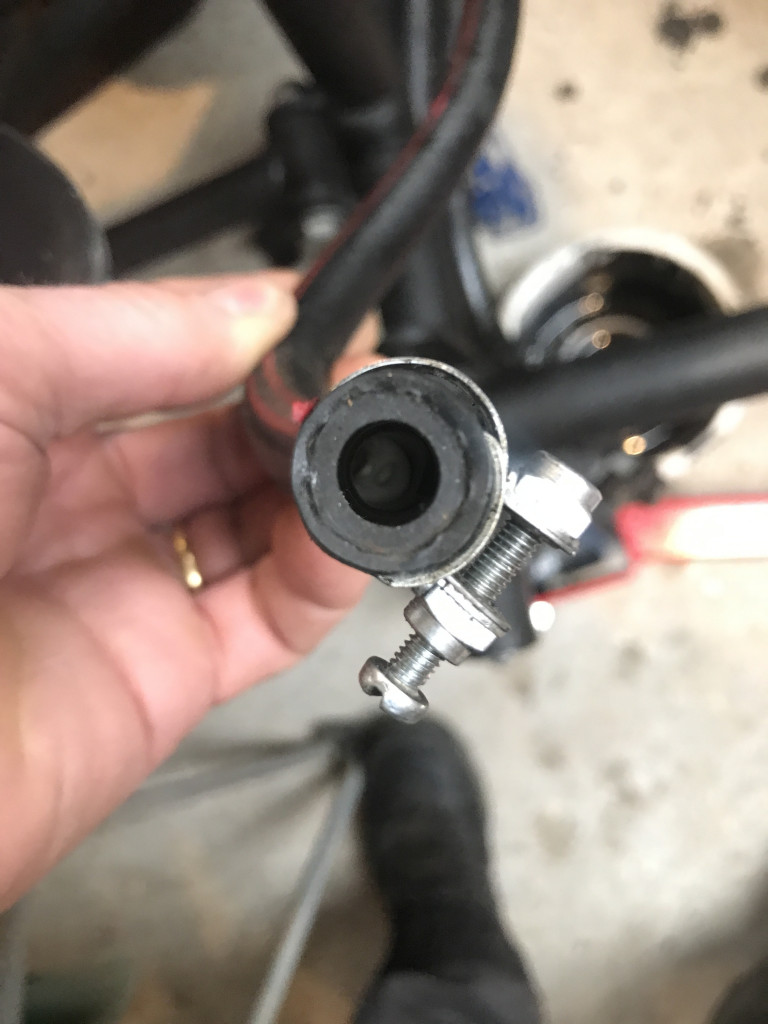

Steve that looks a good mod eliminating the U bend.Hard to get a good picture but here is mine partially blocked up with mayonnaise.

Update, I tried blowing through that breather line and it was totally plugged, impossible to blow through it. I used a heatgun to heat up the line that was laying flat on the motor mount and after a few minutes of high heat yellow gunk started to ooze out of the line. No way air would pass and the crankcase could not breathe.
So, how many folks have this line plugged and do you also have an oil cooler?

I don’t have an oil cooler but the pipe had plenty of the horrible gunge in it. Pulled a riffle cleaning patch through it a few times to clean it out, wasn’t completely blocked but not far off.
Have now relocated pipe as suggested.

Thanks Obie. Mine was totally plugged.
How many miles one you car?

Only 4K miles, what with it being off the road all of last summer waiting for parts from S&S and lock down it’s not clocking up many milesđŸ˜©
Perhaps cleaning the pipe out should be part of an oil change.
