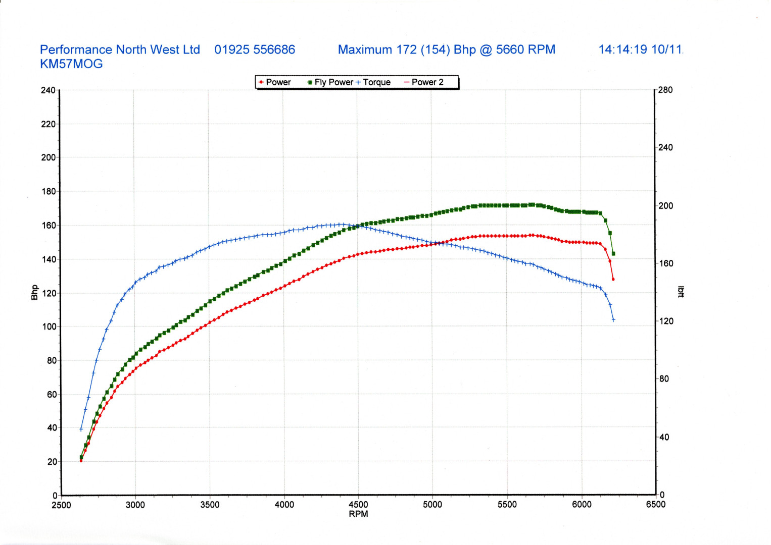

Here's the dyno curve for my Plus 4, with "enhancement flash" and the Librands manifold/cat fitted:
So a smooth, progressive curve. It's much nicer to drive now compared to the original map with stock manifold/cat - it pulls well from lower revs.

Hi Keith,
Thank for the graph.
There is also a graph in TM with only the enhanced flash (no manifold or other things changed) vs. the the Standard factory GDI.
The standard torquecurve is a thing for some points. If you want to frustrate a driver, do it in this way.
Greets René
