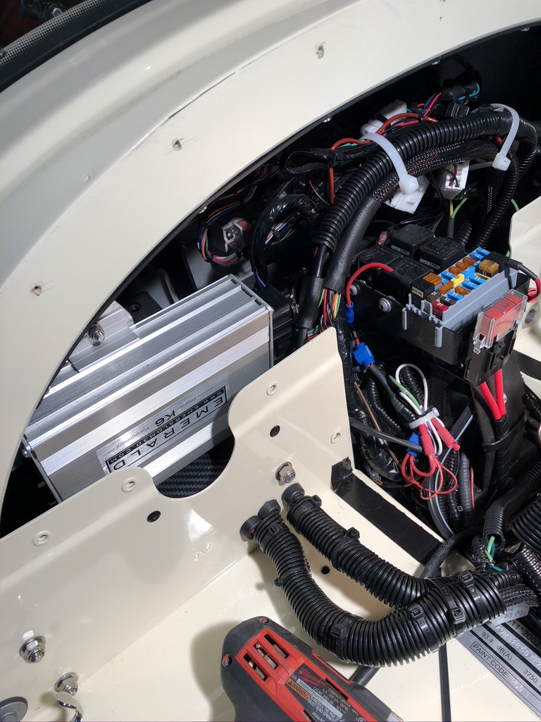

You can fit the Emerald ECU in a different location to the recommended, such as in the photo. The adaptor loom is quite long.
Of more concern is the mapping that I found went well but wasn't very economical, when I fitted it for a short time. G56 were looking into producing a better map a few months ago, not sure how far that has progressed though. I think the Emerald ECU has the potential to be very good. Most dyno operators know about them and how to map them, something that is not generally available for the S&S ECU, particularly since Krazy Horse lost the services of the only person there who knew how to tune the S&S ECU.

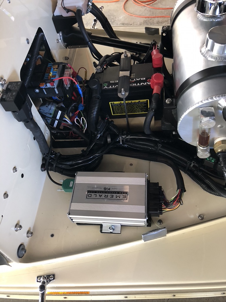

I put mine here, on the other side just to make access to it better.
I started out with it here but found it impossible to get to the connections under the dash with my gauge mounts.
So I moved it out here so it is possible to get to all cable connections easily and the switch location.
I mounted it on a hard rubber pad to isolated it from vibration a wee bit.
I have since removed it because the Tuner I was planning to use went out of business with Covid and it is not worth it to me so I settled for a locked ECU. I am sure the Emerald will produce a better Tune if you can find a Tuner t do it. I don't have those skills to Tune.
