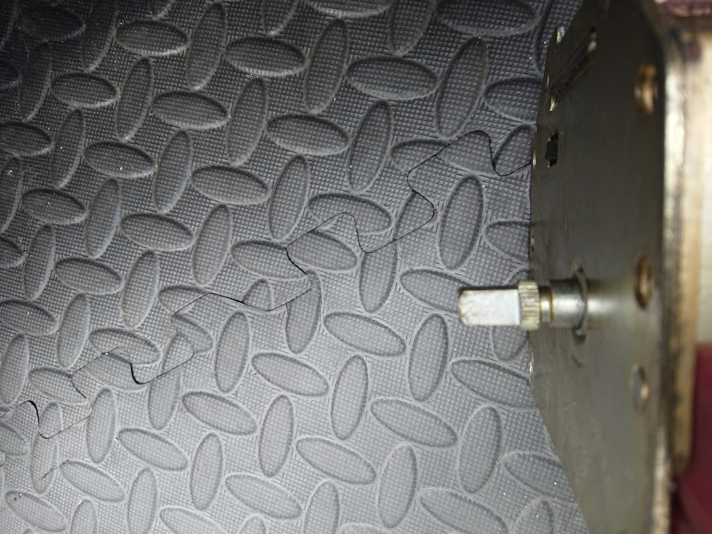

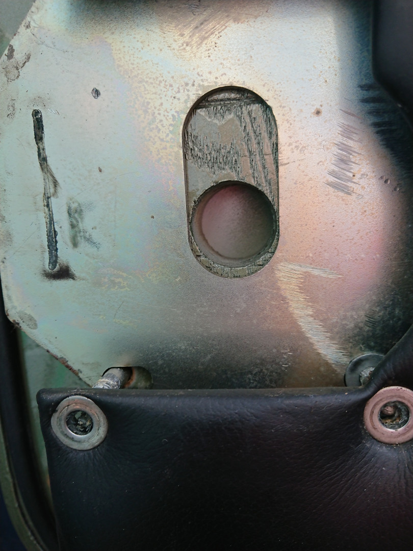

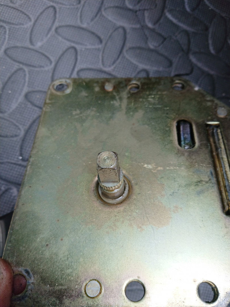

So, from the above images, there is already a square rod protruding out of the correct side, but stops 1-2mm short of the door skin. This square rod goes into the lock and connects to the handle on the inside. Other than glueing anotjer square rod to the existing one, giving it extra length to enter the external handle, what options are available. Thanks

Buy a new lock designed to have a handle I guess. I wouldn't bother, my first car had no door handles it wasn't an issue.

Actually, having looked at the door handle in mogparts, there is a part that would protrude through the door skin and would most likely fit into the square rod, so I think I have answered my own question. Was relatively simple to remove the lock earlier so this is well within my capabilities.

Hi Leroy,
Usually the handle (shank) goes through the rose and is secured to it by a circlip. The shank is not flush with the rose back, it will protrude about 8mm and will have a square hole to accommodate the spindle. Obviously you need a larger hole in the door to accommodate the shank. Best of luck.

SALMO, yes, from looking at the images I took and on mogparts, that would seem correct. Thanks

As shown here in Mogparts listing.
Presumably the part that protrudes through the skin has a female square section to match and engage with the door lock square shaft. A quick phone call would confirm this.

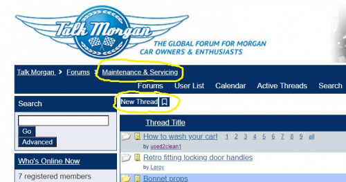

You're in the right section - clicking on Maintenance and Servicing (at the top of the page), and then on 'New Thread' and you can start your own.

Welcome Jason. Suggest starting a new thread in the Maintenance & Servicing section, click here. You will then see the option "New Thread" towards the top left. Click on this, add a title then ask your question.
