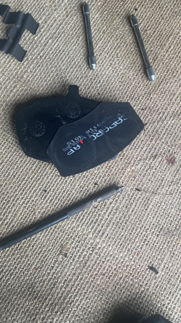

Looking at photos on line, it seems that some pads (Mintex) do not have a bonded shim, whereas some like TRW do.

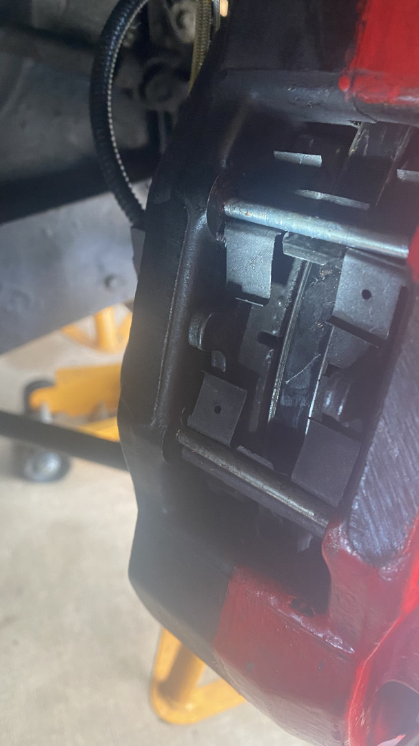

The springs labelled Part 5 are held in place by the pins Part 4. These should have a pin/clip to hold them in place on reassembly. Often a small R-clip.
Take a photo of the set up before replacing as a reference.
Replacing these is a simple enough job as you don’t need to take the pads out.
Changing pads means backing off the pistons in the calliper to leave room for the new and thicker pads to slip in. If no anti squeal inserts are used then Copper grease or other suitable non copper greases designed for brake use on the back of the new pad plates helps with squeal.

Thanks Richard, after reading up including watching You Tube vids my understanding these anti-squeal vibration plates are either fixed in place with lugs, or glued to the back of the pad. Glue can break down with heat and the plates work loose. I am not heavy on the brakes so I can rule that out.
I spoke with Tony at Williams this morning, he said they see many Morgan's with these plates working loose. They remove them altogether and apply Anti squeal lubricant paste. My next trip will be to a local garage and probably have them removed.
Thanks also to RichardV6, TBM, DW for coming back to me.

Yes, I have had the same on my 2011 +4. The anti squeal plates, ( as TBM correctly identified) are “stuck” to the back of the pads with some sort of goo. When mine slipped I removed them, cleaned up the back of the pads and applied some copperslip. Quck and easy job as long as you don't damage the H-clips when removing pins. (spares easily available from Rimmer Bros.)
I also know of a 2010 +4 where after about 8 years, the pads actually delaminated as Richard referred to.

Glad you got to the bottom of this Craig. As you can see in the 2014 on parts book exploded diagram there are no shims shown either individually or bonded to pads. My original factory fitted from new pads didn't have any and neither was I expecting them. Needless to say the superior EBC pads I fitted also didn't have any either.
I do use a thin smear of Mintex Ceratec anti-squeal compound (accepted as preferable to Copperslip) on edge and back of pads when fitting though.

This evening i removed these anti squeal shims, they were glued in place same as Deejay’s car (not great) I applied a little copper grease before reinstalling.
Thanks again for talking me through it, it’s easy when you know how.
