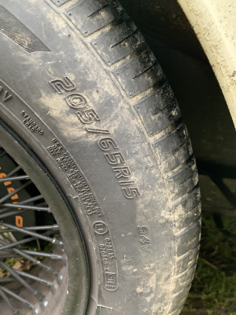

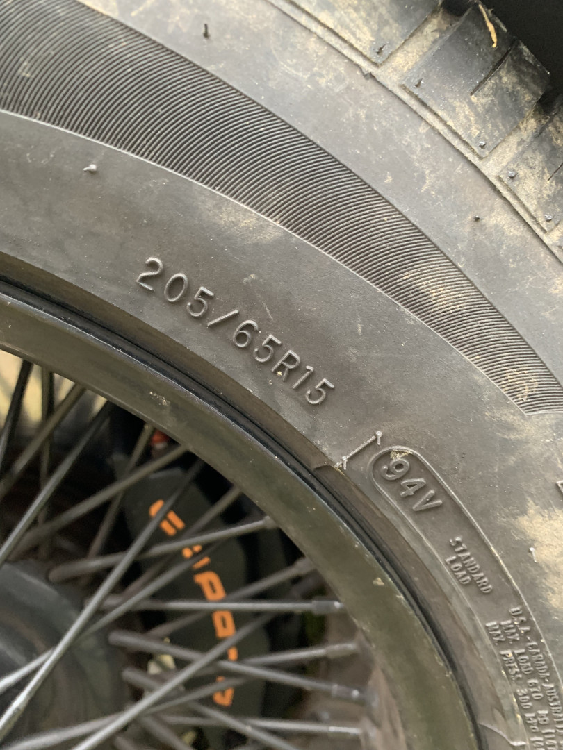

The 205/65 R15 (or 205/60 R15) tyres were optional and fitted (normally?) to wider rims. The 205/65 actually give pretty much the same ride height as the narrower tyres fitted to the 4/4. Interestingly this would allow you to use a 4/4 wheel and a "space saver" spare.
About 9 years ago I created a table to compare the different tyres used on a Plus 4. The pdf file can be downloaded at http://www.talkmorgan.com/ubbthreads.php/ubb/download/Number/16690/filename/Tyre%20Sizes.pdf

Sadly, I don’t have experience with 1000s of Morgans, but I do know that my plus 4 and many others certainly in the past decade or so, were supplied from the factory with 195/60 15s.
Just saying to set the record straight!
So was I. Gambalunga mentions using two tyre sizes on his Plus 4. 195/60 15s and 195/65 15s. I felt that should be absolutely clear. Heinz picked it up right away.
