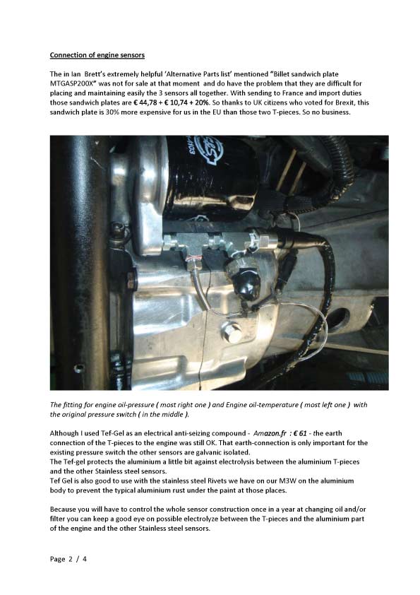

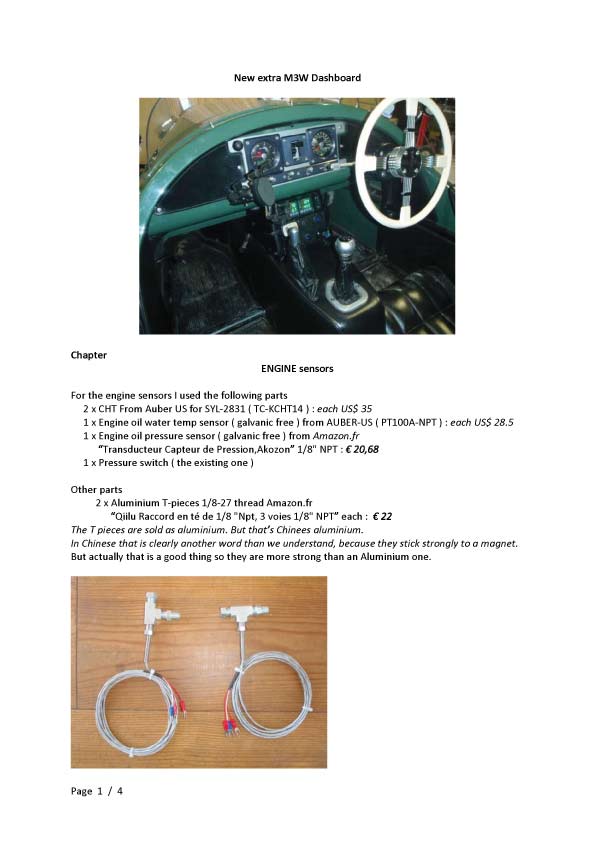

Because the first thing I want to know about the Bevel-Box is temperature, I decided to create an extra Dashboard, where I could control the Bevel-box temperature.
And because I have a lot of other possibilities with these fantastic and flexible Auber-instruments I used it also for Engine-oil pressure and other – for me - important things to know.
Chapter
Bevel-Box sensor
Because the whole project started with an analysing project of the M3W Bevel-box, the first sensor I bought from Auber was the same temperature sensor which I used for the engine.
I have installed this one instead of the drain plug of the Bevel box.
On Amazon.fr I could buy a M16 to 1/8NPT bold which I used.
The inside diameter was just a little bit wider than the sensor.
To get more fluid flow I drilled the hole to 12 mm.
I made a relay behind the new Dash, so I can switch between the Engine temp and the Bevel-box temp.

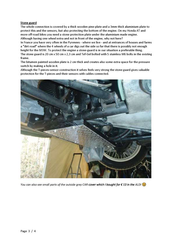

Following you will find some documents which hopefully explain the other functions of the dashboard and how I made it this winter.
Because I could not download a MS Word file, I made from a pdf file four separate pdf pages which I converted to jpg files so I could give you – via TM-Images - a document to read.
Some extra’s
The dashboard has also a fitting for a “Tire Pressure System” and two switches/regulators for my motorbike heating vests and a USB outlet for the Programmable ECU which I bought from Bunny.
