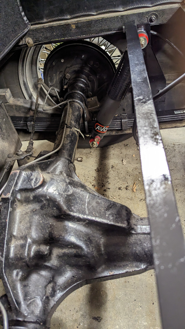

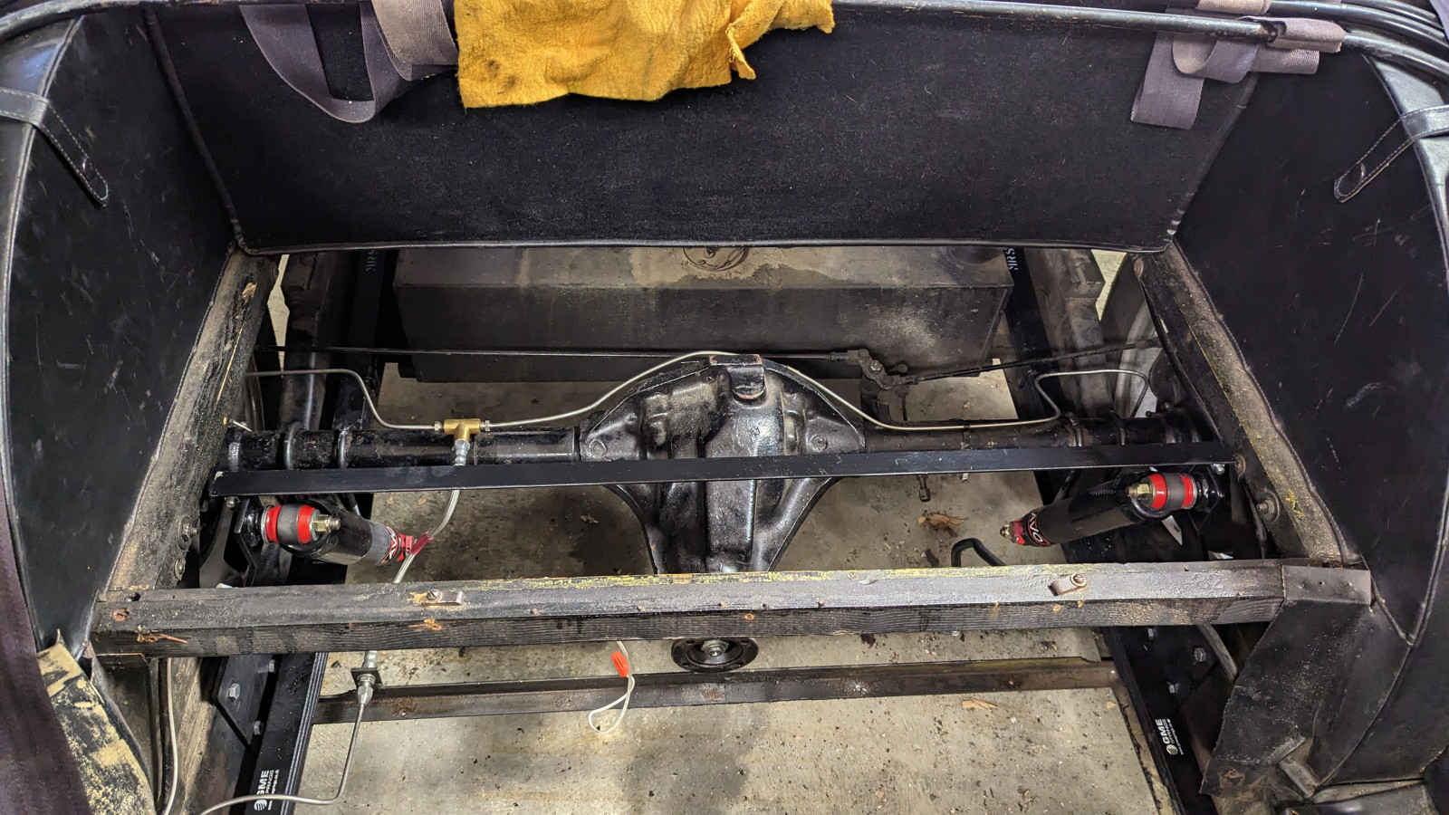

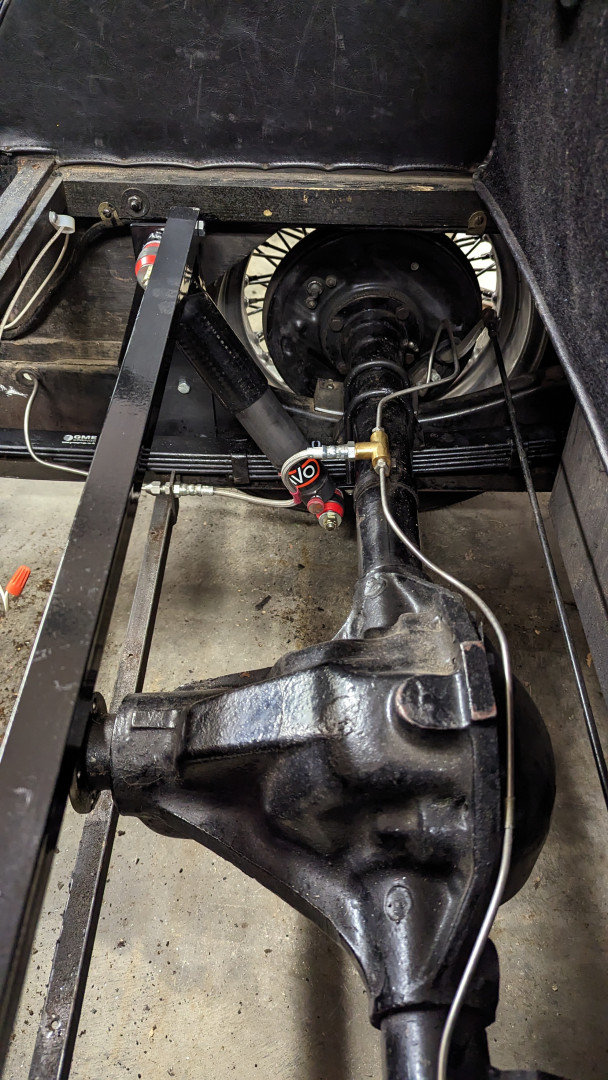

I finished the 5- leaf springs and the rear Rutherford kit today. I have more to do before I can try it out.

I realized tonight I forgot to install the panhard rod kit. I guess that's tomorrow's project.
