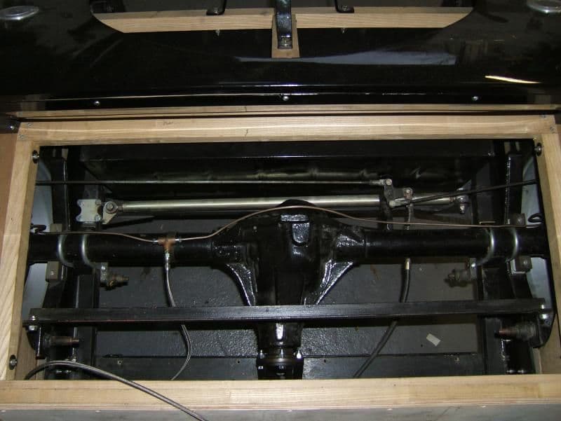

Does the adjustable shaft of the panhard rod have to sit perfectly parallel to the solid cross member? Or can the part attached to the leaf spring be an inch or two away? I assume parallel is ideal, but I can't imagine the forces are so great that 1 or 2 inches off would make a difference.
Angled is fine, The photo attached is from Williams Morgan.
Good news is that once fitted the rod adjustment can be used to centralise the axle to chassis if needed, and within small limits. I think mine (5 link) was found to be 10mm out of true to chassis but correcting upset the symmetry of tyres to bodywork so the final correction was split. This modest error showed up when I later had the front toe laser checked. As suspected from the handling some toe out was found and adjusted to a smidgeon of toe in.

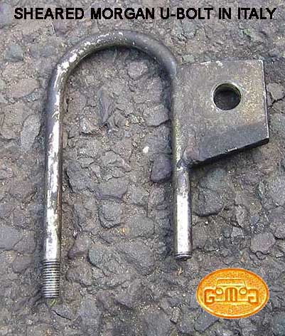

However, there is a couple of minor related problems. Stock trad axle saddle plates and stock u-bolts are not strong enough. They shear. The ubolts also
stretch, requiring replacements at each service. I use graded 7/16 and a thicker graded plates. I sourced them from Peter Mulberry back when
Axle ubolts& plates. As well, the MMC axle centering pins used to be (perhaps still are) ungraded. They shear, forcing one, eventually, to drive home sideways! doh At the price, it is wise precaution to use graded ones. Easy to swap in when changing leaf springs. Makes a potential problem disappear forever. My Morgans are a little silly in the power department (I try to keep them detuned down to 292bhp on Rob Wells' wise advice). So any component that can survive my Morgan for decades can survive any trad.
