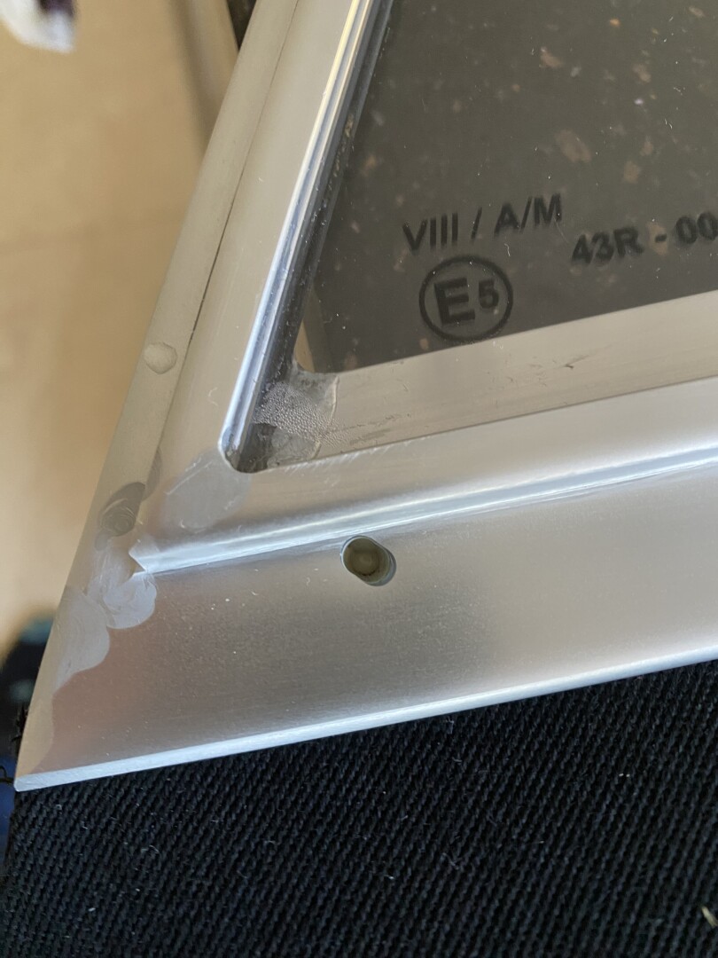

Ok new car with a passenger side water leak through the door into carpet.
I presume this is a drain hole?? It’s blocked. No idea how I can get to it to successfully unblock it
Frustratingly it’s blocked with the sealant the use for the Perspex glass.

If the hole in your pic is a drain hole, then I might use a hand held twist drill a little under the size of the hole, twisting it with my fingers or perhaps old style carpenters hand operated drill to try to clear the sealant, taking care not to damage the perspex.
Though if there is indeed a drainage system chances are that other than the hole the rest of the system may be gunged up...?

Yes the other side has a hole which is only partially blocked with silicone. I’ve cleared them out so will see how it goes. Pretty soaked in there. I have a particular hatred for water ingress.

Hi Viper, I had the same on one side of our Plus Six, the external front drain hole was blocked by sealant which was a type of silicon used in locating and weather proofing the front perspex screen section. The outer front hole is a drain for the window channel, if its blocked the channel can fill with water and then can spill inward. You see this when driving in the wet or even washing the car.
Ours was rectified indirectly as we had to replace the front sidescreen perspex and the dealer made sure the new sealant did not block the drain hole.
What I can tell you is the sidescreen perspex is coated and if you scratch through it, there is no way to polish the scratch out, so the only fix is to replace the perspex. The hit is that you can not purchase just one side piece from the factory, you have to purchase a complete set which is very expensive.
As your car is new I would advise that the dealer sorts it for you.. Just seen that you have cleared it yourself.. so well done.. I would be careful when you clean the car as a sudden rush of water on the screen can overpower the drain hole and then it spills inward.

That side screen looks exactly like the trad. Water fills the trough/gully where the plex glass slots in. Without that drain hole the water then fills the trough/gully & runs down the inner side & wets the sills & carpet. Back in 2011 the factory did not bother to drill the drain holes so I drilled mine & have had no water from that area since. The factory did start drilling the holes but not sure when.
