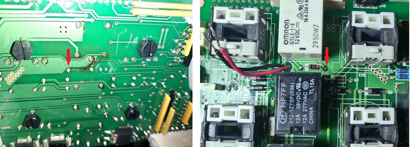

The dreaded instrument panel PCB strikes again eek
At least I found a burnt track, so its off to my local electronics engineer tomorrow for a full board health check, a repair of the burnt track and a test of the fan switch to see if that's the reason the blower motor has gone on strike too.
I'm definitely making progress, not only have I found a clear point of failure on the board but I've also got the impossibly stiff mechanical heater control moving nice and freely for the first time in my ownership thumbs

Will be interesting to see how your proper expert repairs it, I would have carefully soldered a fine insulated wire between the two exposed ends to bridge out the whole of that strip on the pcb (but I'm from Yorkshire wink )

I've also just found the following post that seems to point to a common link between the blower motor and these multiple PCB failures

TBH rather than relying on a repair of the burnt track I really need to understand why it failed in the first place, or it'll likely just fail again frown
In the above post Gambalunga talks of four PCB failures on his 2012 Plus 4 before he went to an old school relay solution, Monty is a 2012 Plus 4 and my failure also arrived at the same time my blower motor went on strike, the similarities are hard to ignore.
At the time of failure I also blew the fuse for my speedo and ignition warning light, however, once the fuse was replaced the speedo and ignition warning light did return. But sadly I was now left with no illumination in the fog light and heated screen switches, although in my case the issue is just switch illumination as both the switched devices themselves remain functional.

Like I say, I’m keen to trace the true source of the fault rather than just have my local electronics engineer repair the burnt track, could there be something in the fan relay flyback diode theory?
Yes. it’s worrying that you reported seeing sparking. I fear the track might be just a symptom and the problem is lurking elsewhere. A repair might just fail again or worse if a thicker repair wire is used.
PS - It looks like the failure might have occurred on the tracking to the heated screen relay coil.
One for the proper elec experts…. Is that a flyback diode? Could that have failed shorted?
