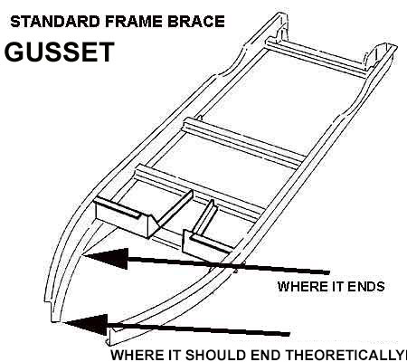

1. Gussets are great, but one must understand them and their effect before designing, making and using one.
Some preliminary background. A few decades ago, the MMC discovered to their dismay that the combination of the strength at the bulkhead cross member combined with a flexing chassis, cracked the frame at the bulkhead, a place that cannot even be patched. And patching a Morgan chassis anywhere is anything but a forever job on what should otherwise be a forever car. Gussets are a MUST. (However, many homemade chassis (chassis are wear parts on a used Morgan) and even one prominent supplier in the US, omit them making the result the vehicles using them far more vulnerable for the want of a costless addition requiring an extra 1/2 hour in labor. The lack of them are often the reason a new chassis was required in the first place! Habit is a stronger determinant of action than common sense.
Gussets move destructive forces where the gusset directs. That is the reason why the suggestion of a welded reinforcement strap straddling the car would merely ensure the worst place for a chassis crack, at the bulkhead cross member, for the same reason cracks appear at either end of a patch. A welded strap is, (unhappily) a bit better used following the frame, not the cross member.

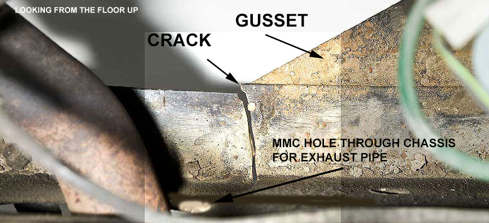

2. Additionally, for some bizarre reason (cost?), Morgan went through model eras where they passed exhaust pipes through the CHASSIS, a huge no-no. The frame around the large hole (s) is constantly being hyper heated and cooled, expanding and contracting the remaining metal around these holes. Yet the gusset ended at the hole!!!! That made chassis cracking even more likely. (see pics below). AND in many cases, owners (like me) received chassis with such frame holes when their exhausts went through the valances! I can think of no perfectly safe remedy for these cars. frown
3. Next the tried remedies. But instead of merely extending the gusset past the holes, they added a metal strapping. So now we have a flexing chassis that cannot flex equally in that area.
However, the old crack point was moved away from the bulkhead. That was a good thing I guess. It allows for cracked chassis be emergency patched. We don't hear about these cracks as much as the earlier ones, (though from this perch they are more frequent). IMHO, a patch on a Morgan chassis is like a unpleasant brother-in-law that has come to live with you forever or until you or he move to that great garage in the sky.
This is all to point out the obvious. Morgan aftermarket engineering types have confirmed that the gussets should theoretically extend to the front end of the frame. The one displayed above is too short, exhaust hole or not. However, Morgan trad frames are open ended in front. I think we are fine if they extend 24+ inches with a trad that has not been "exhaust holed" or 8-10 inches past the hole if they are.
