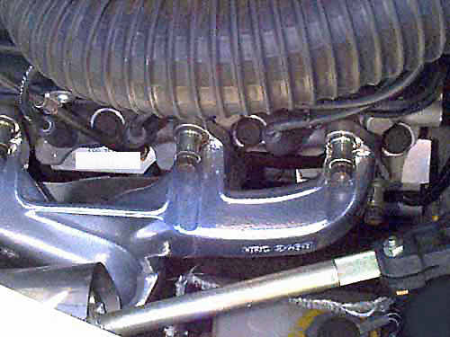

P.S. Here are ceramic coated cast iron manifolds on an USA Morgan 25 years ago. The effect is noteworthy as well.
