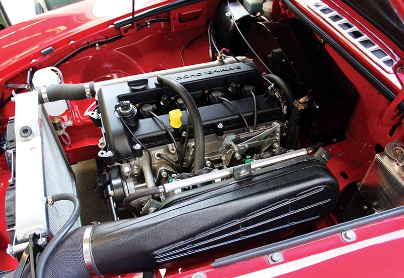

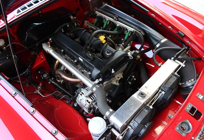

Chris, I don't think you can compare the Morgan with the MGB in that respect. In the MGB, everything is under a real bonnet. With the P4SS, it's not about the volume per se, but about the STBs cutting through the eardrum like a scalpel. This is not the case with the closed engine compartment of the MGB. Thanks Heinz, hopefully I will not have an issue. I have been told that Frontline fits a cover which cuts out the ITB sound for customers who don't like the sound that I can get fitted to my car afterwards. But I will not be telling someone there is an option for a quieter engine unless I get complaints. It also involves cutting a big round hole in the radiator support. ![[Linked Image]](https://www.tm-img.com/images/2023/09/04/mgb-engine-bay-1.jpeg) ![[Linked Image]](https://www.tm-img.com/images/2023/09/04/mgb-engine-bay-2.jpeg)

Chris, yes, you can try it first without the cover. It could be possible that when using the cover the ITBs get more cold air the way it looks. But I would also say it is not a must. Good you have this option, perhaps after the first years of roaring enjoyment you yourself could like it a bit more quite, we will see.

Heinz, Yes you are right I can it without the cover for a year and buy it afterwards. I had not thought about the extra supply of cold air but you are right it could make a difference.
That is an Australian car using parts supplied by Frontline, but yes I agree they do great work.
